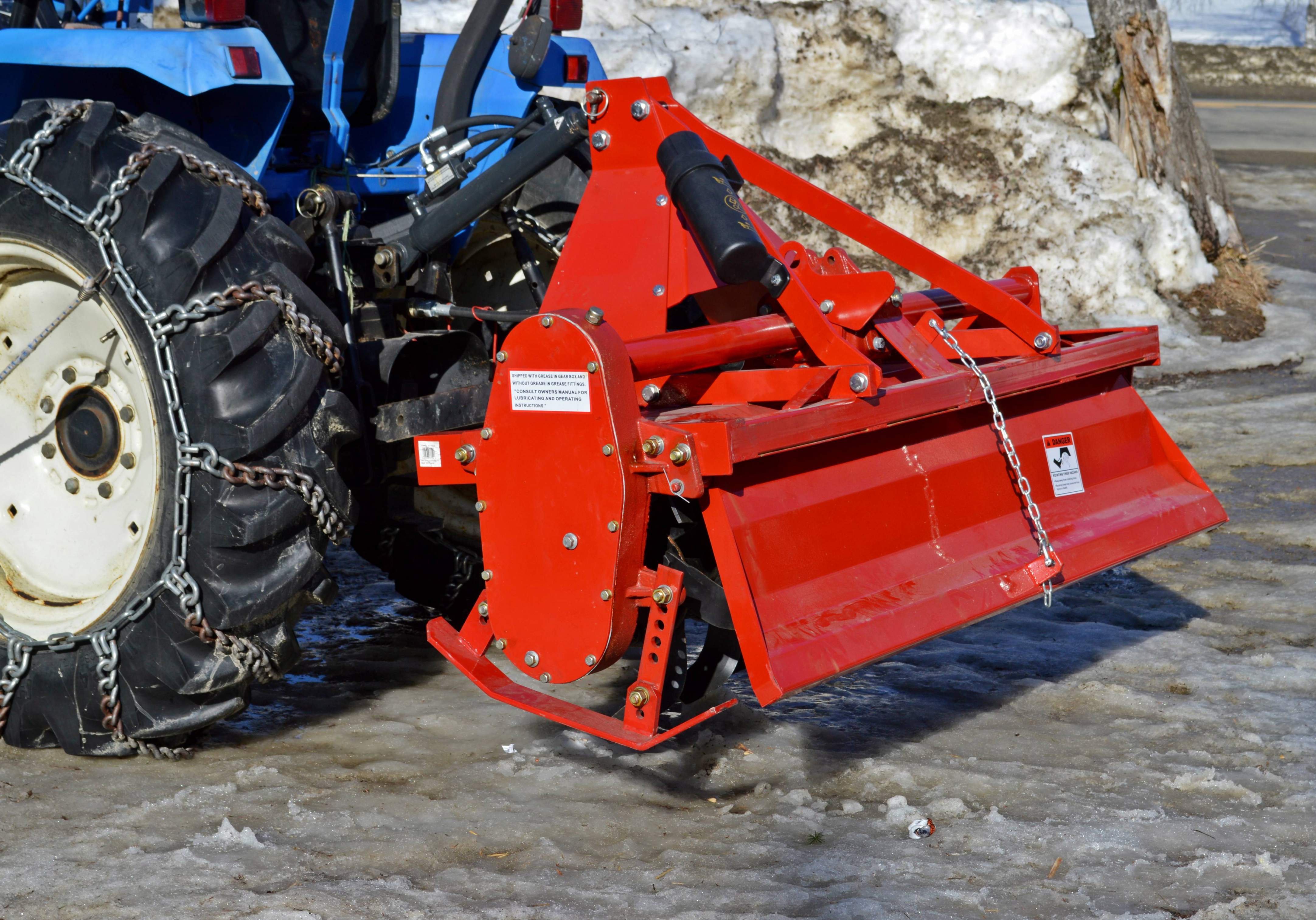

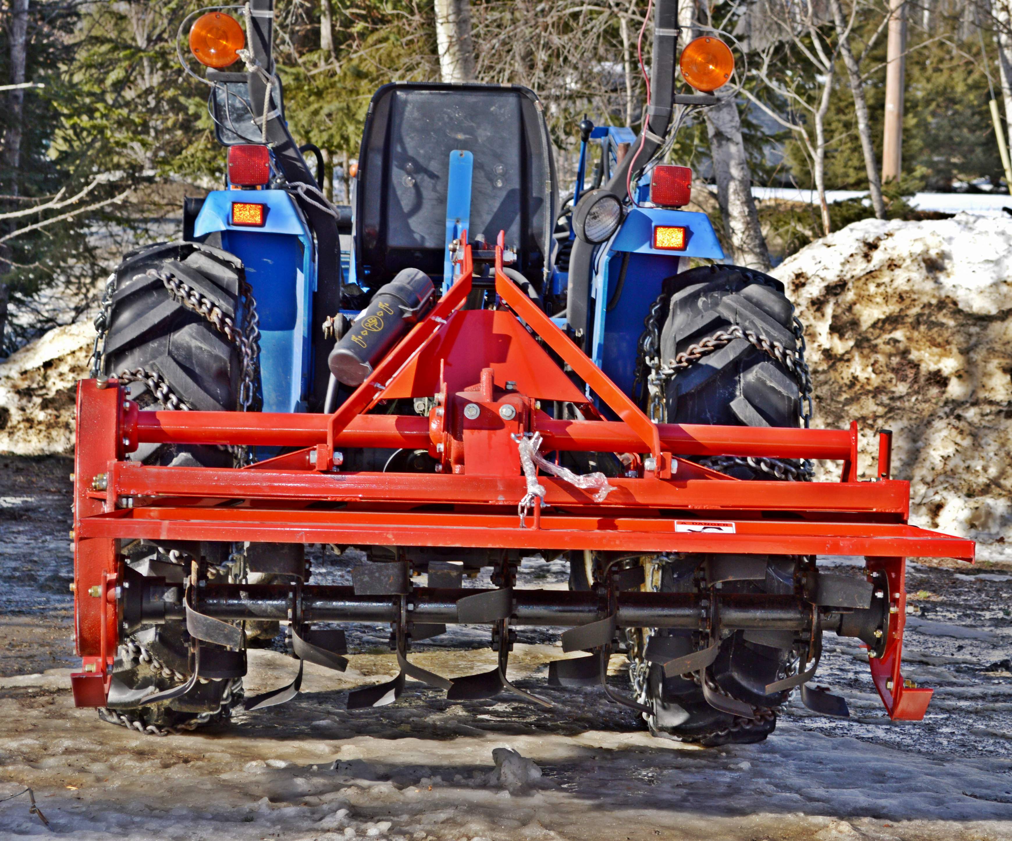

offset 48" tiller - $1095.95
offset 60" tiller -$1195.95 I have the 5' model for my NH TC30, rugged and works well with my 30hp tractor - pics taken the day it arrived, works great in the garden, I'd never go back to a walk behind tiller.
Tillovator-Rotary Tiller | Agri Supply #77710
