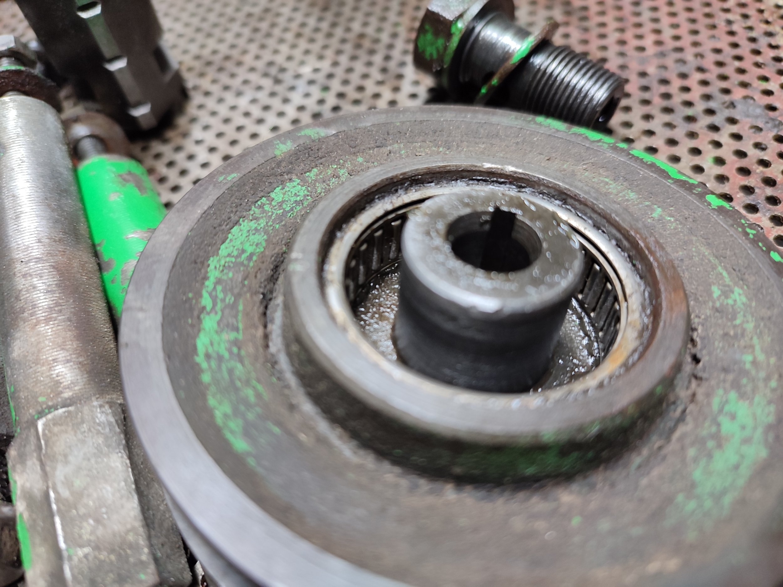

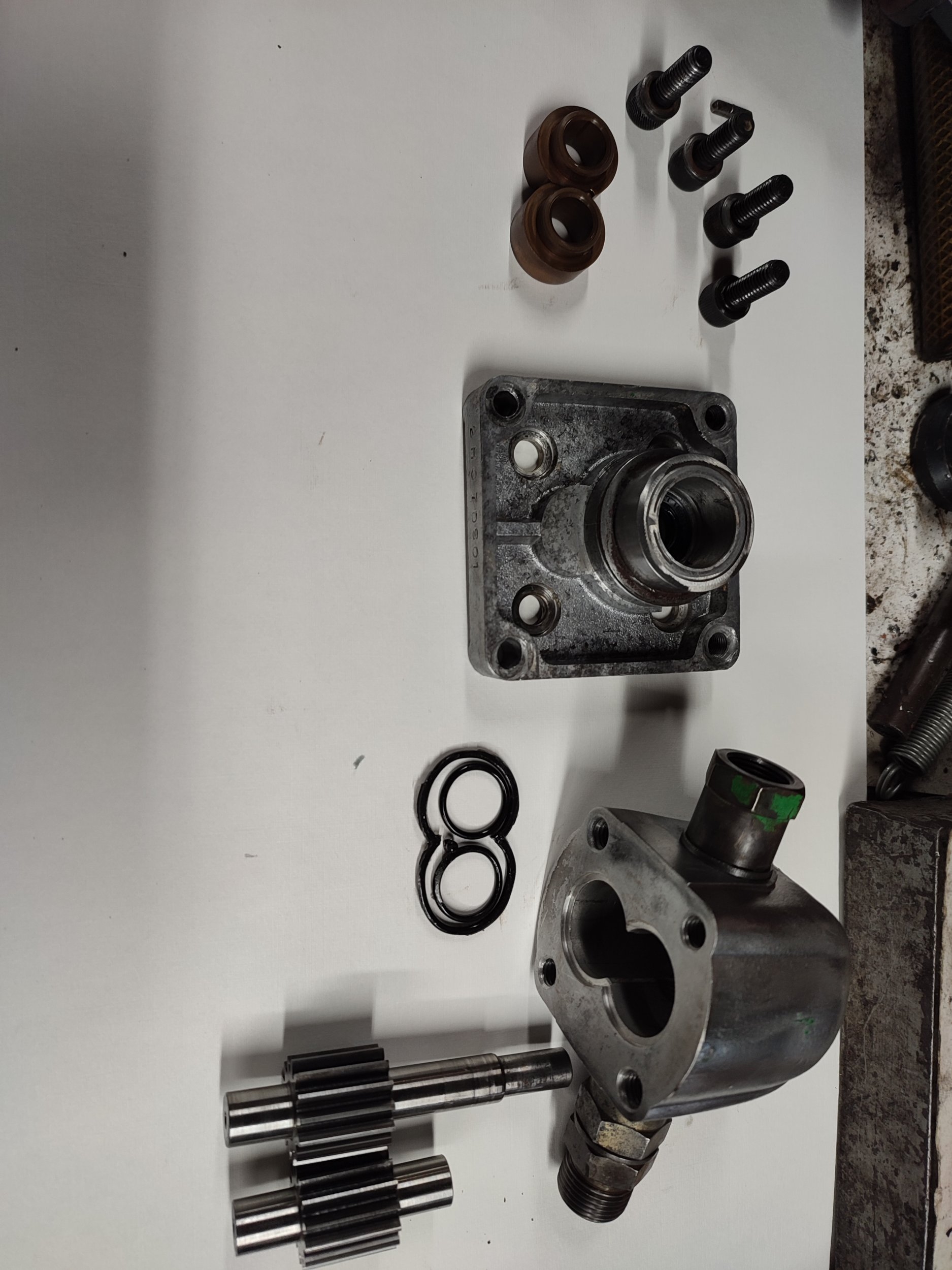

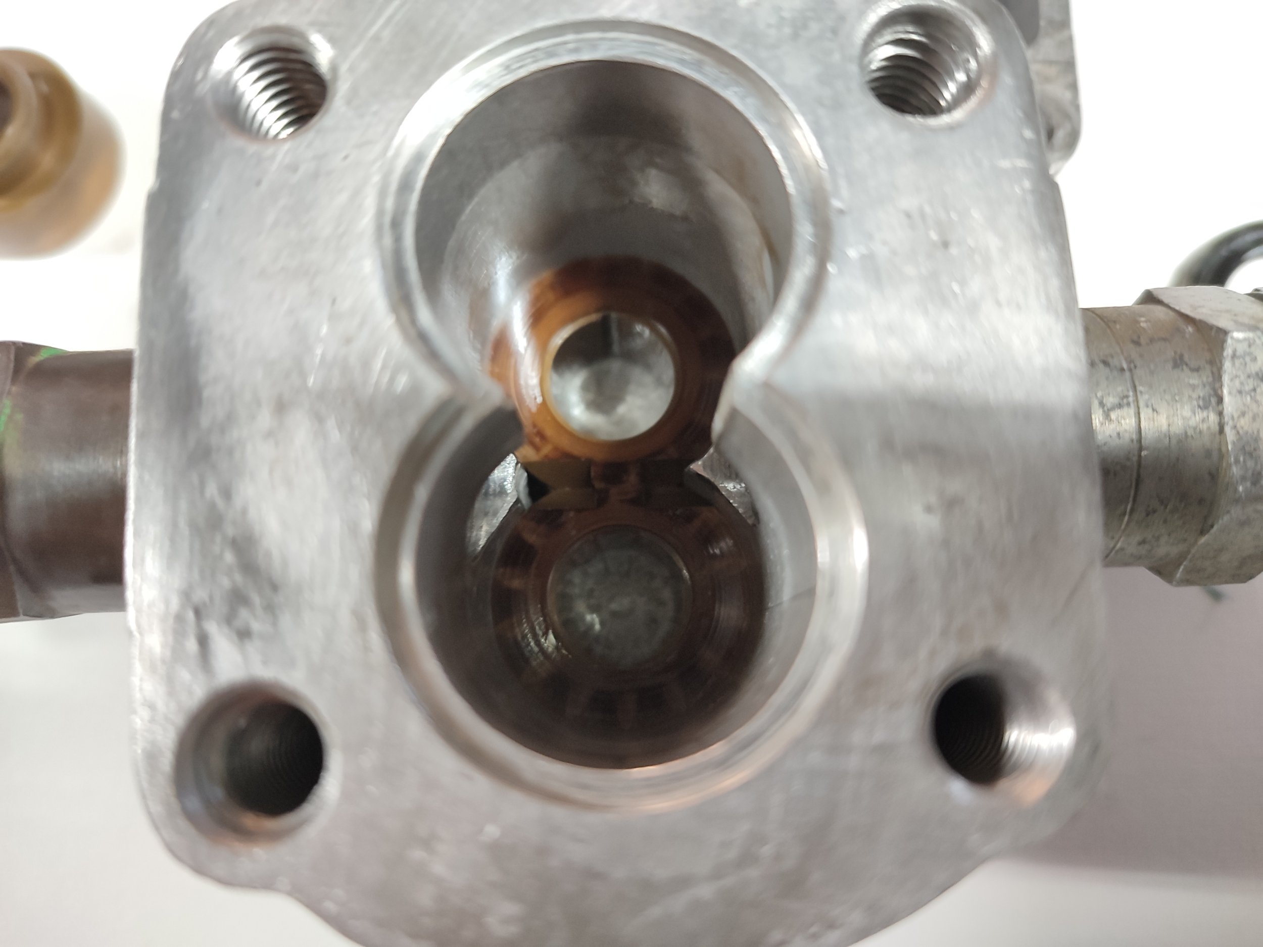

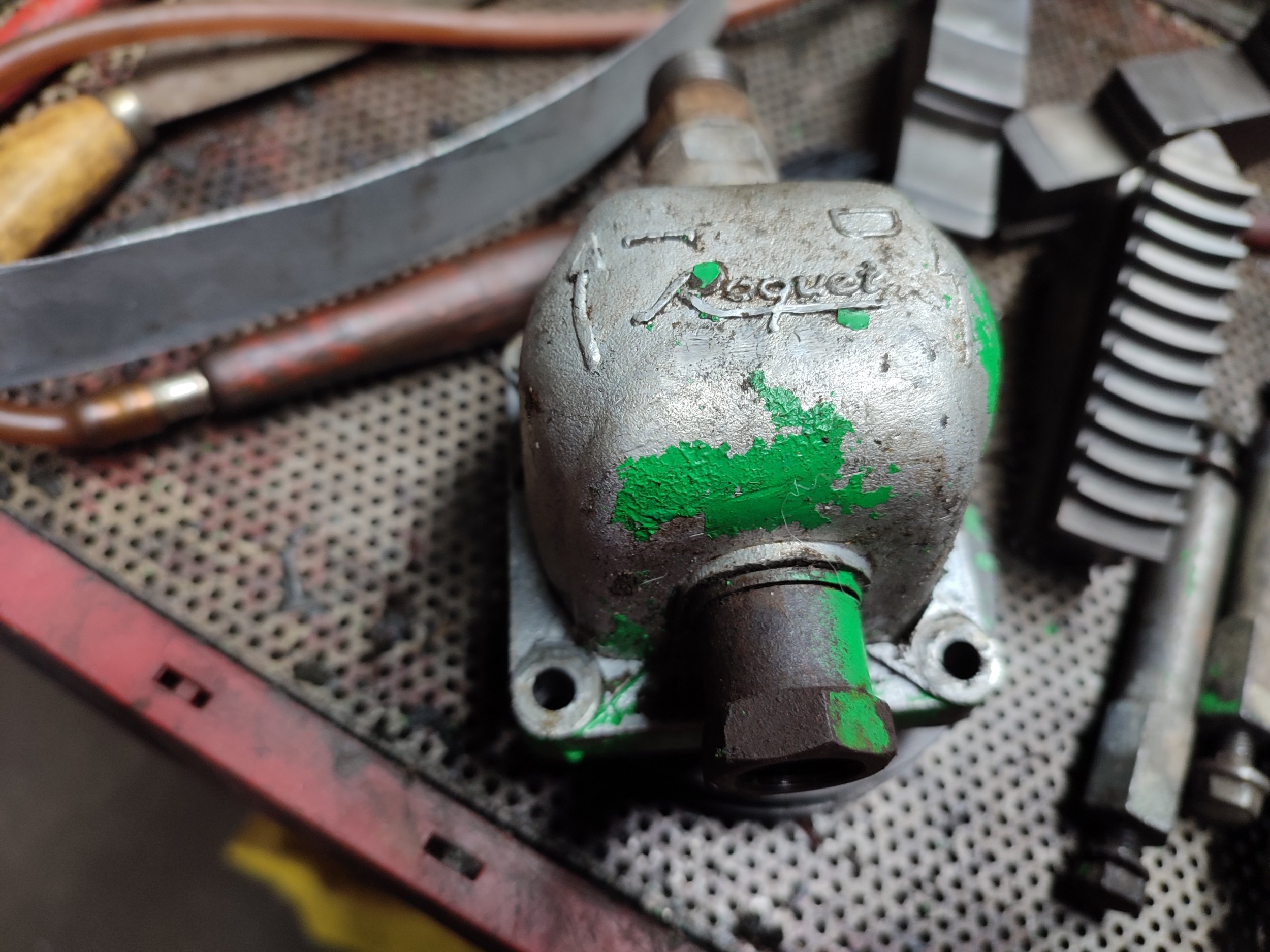

Disassembled and inspected the hydraulic pump. It's in very good shape. I really dig the design of it though. Also, they did a cool setup for adding a bearing on the pump so it can take the side load of a belt.
They pressed an hardened bushing on the nose of the pump. Then on the pulley, they bored for a needle bearing. Cool setup but tricky from a machining stand point.

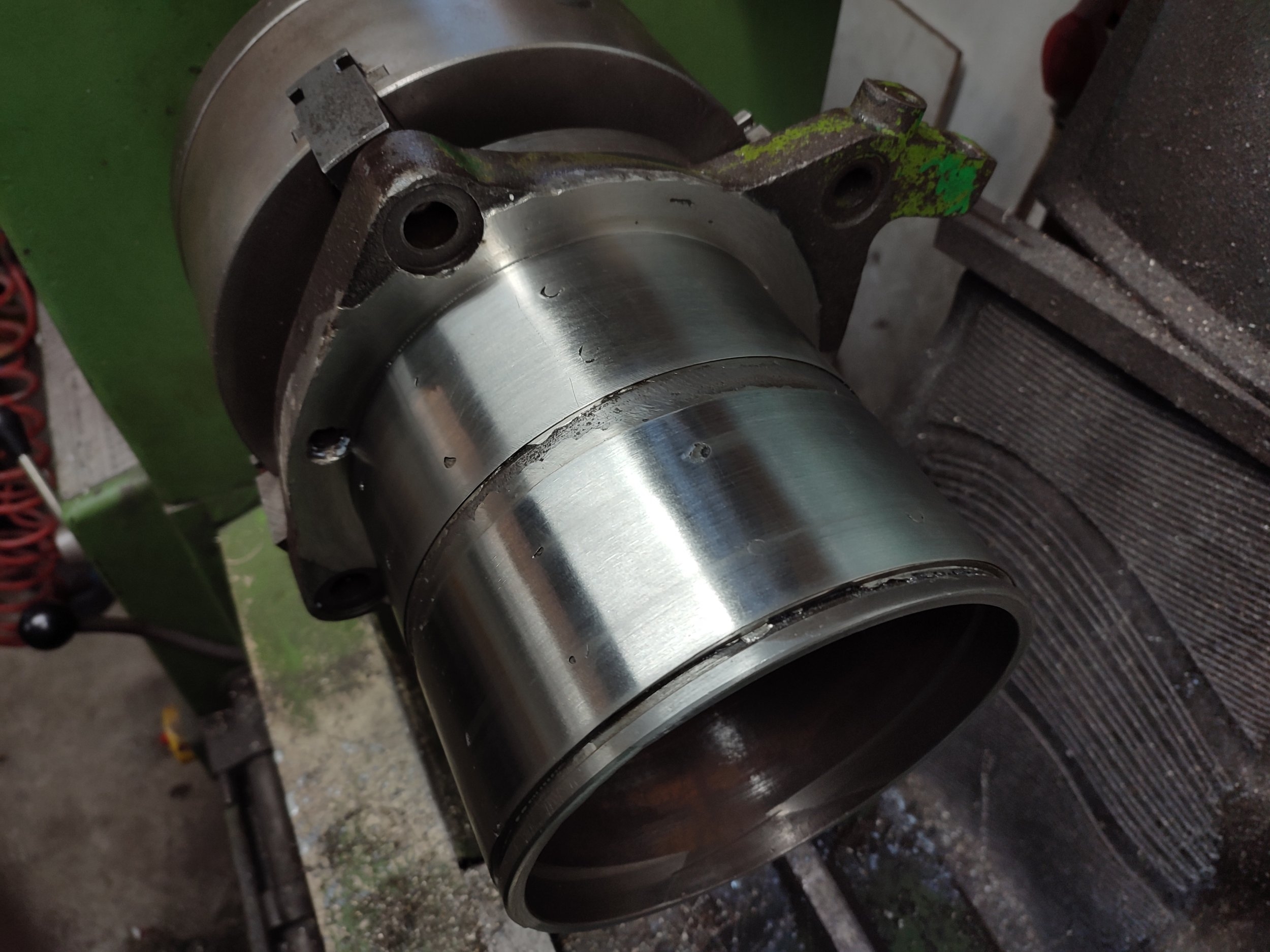

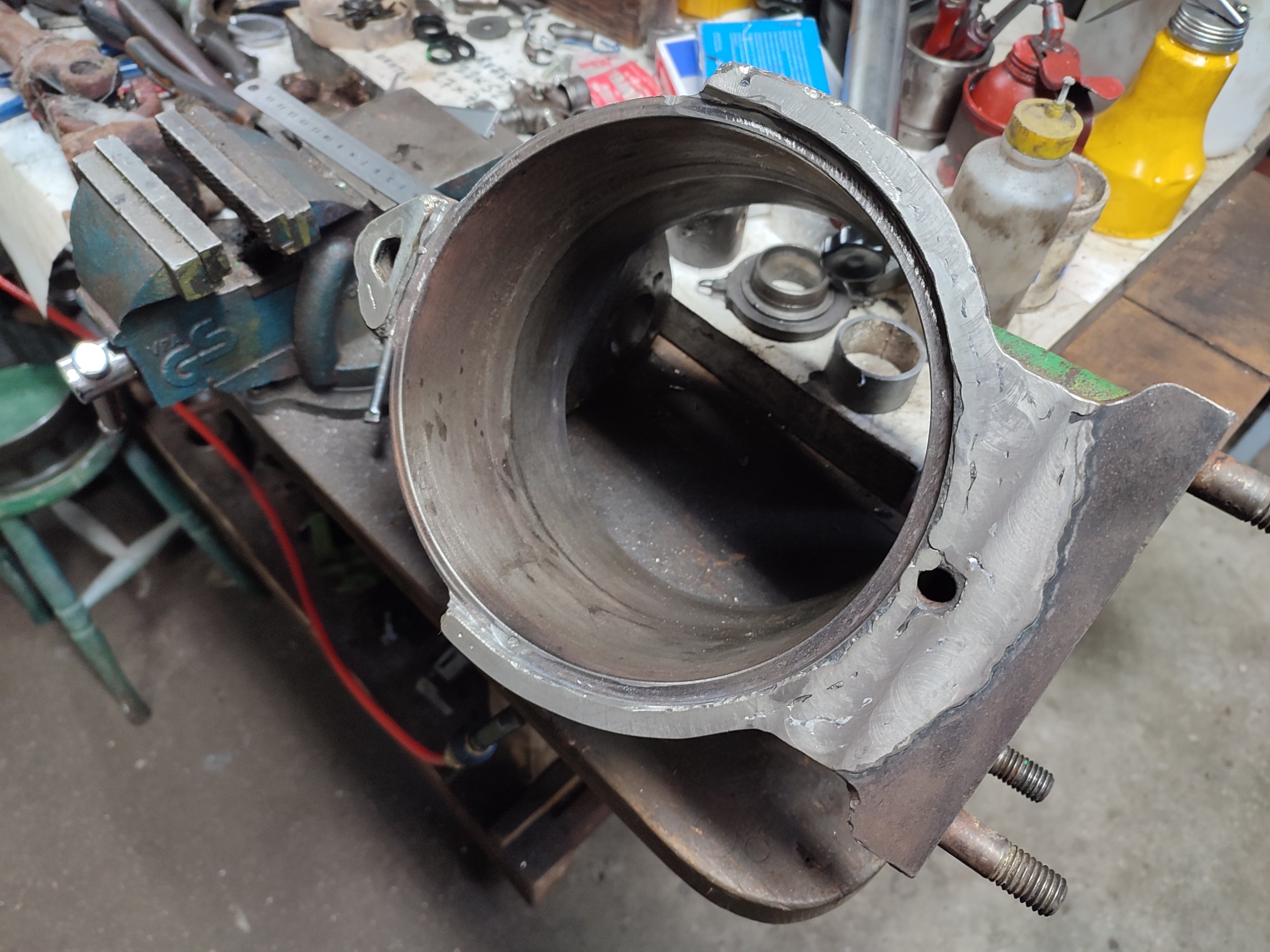

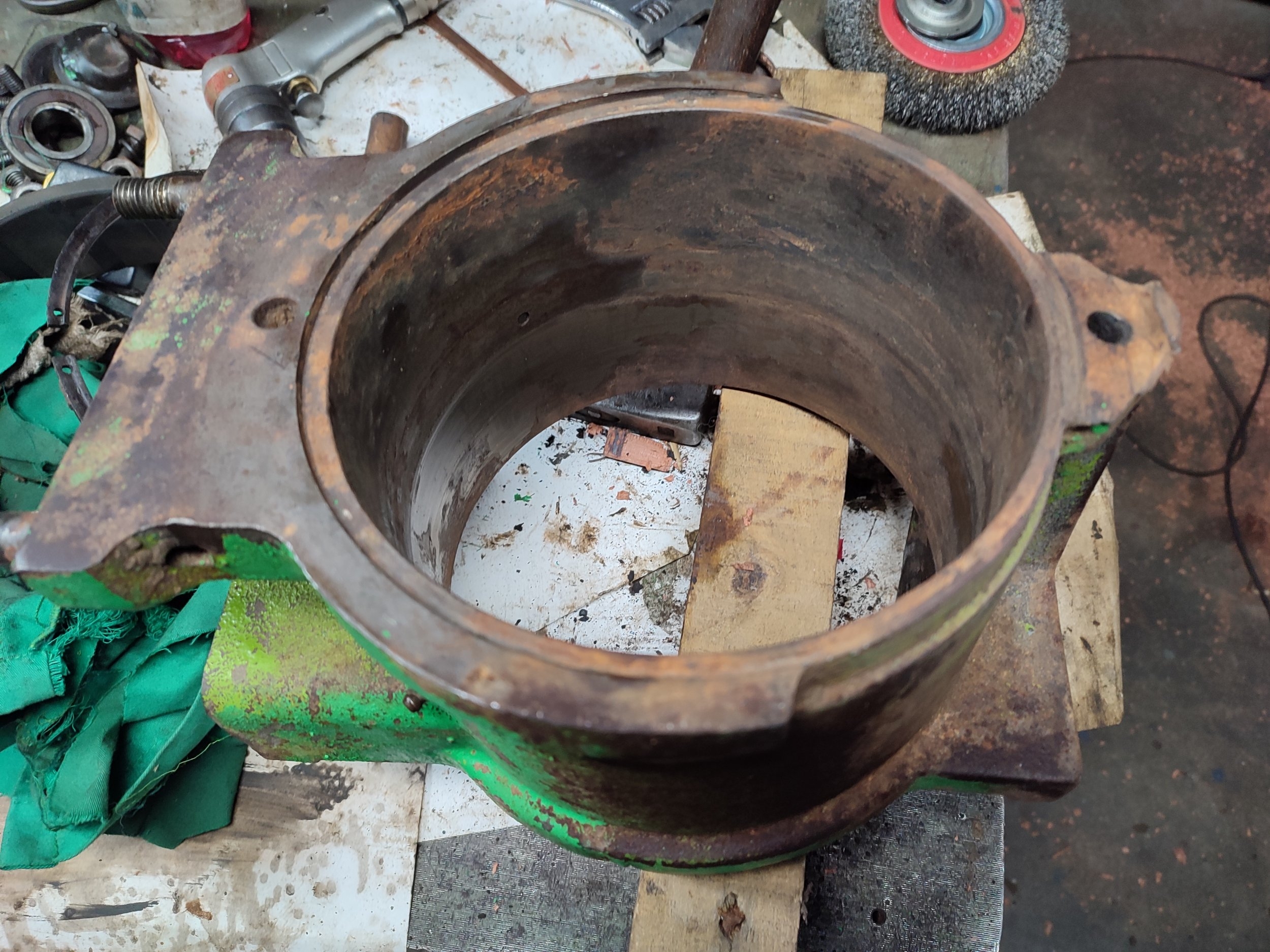

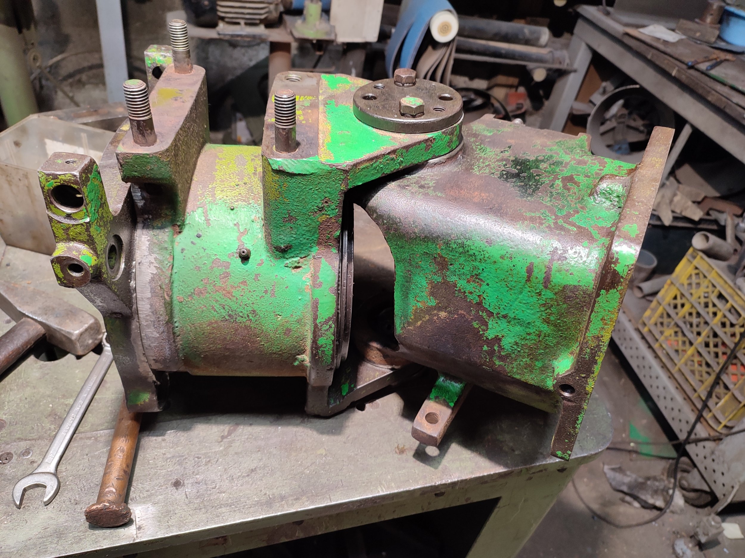

Finally finished the center section of the tractor. This one put up quite a fight and ate way too much time but sure was rewarding in the end everything just fell in place with little to no play at all. Just as planned.
This center section started with the other piece where the king pins go that I shared some posts back. Then there is two more parts, that work together to achieve the tilt. These two work with two nylon bushings. Luckily those were still in decent shape and were salvageable. Seems like it has run a lot of time without those bushings, which caused lots of wear on the parts and then they finally threw in the bushings.
Anyway, I did fail to take pictures of how those parts looked before. So I only have the pictures during the repair and after the repair.

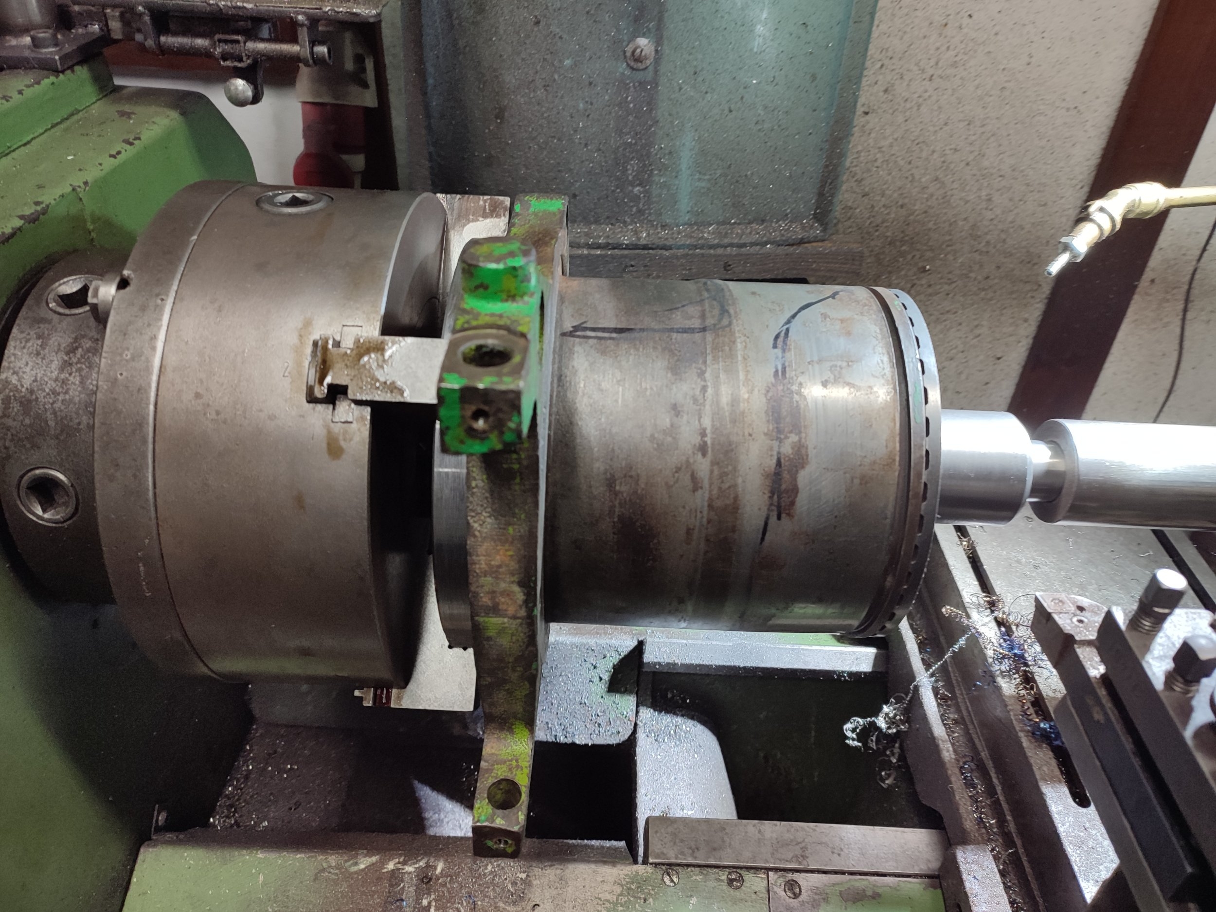

Here is one of the parts being test fitted in the lathe. I used an old brake rotor as a backing plate so I could use my live center for extra support.

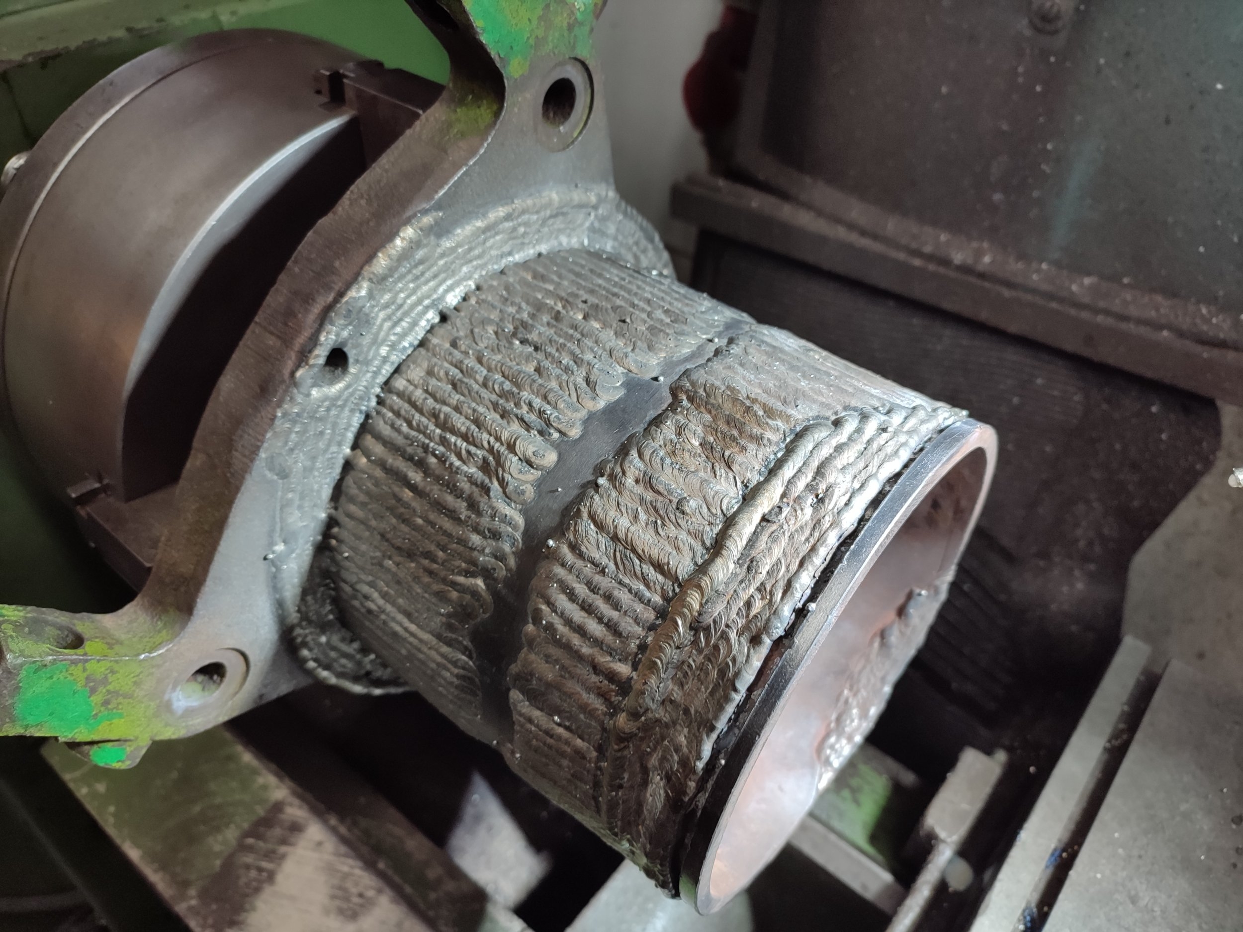

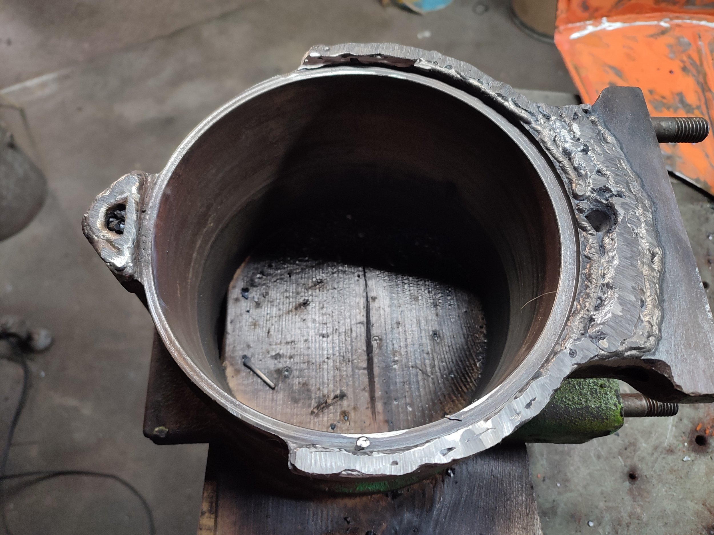

Here is the same part with but with about €100 worth of 309L rods thrown at it. This was a long ordeal. Ideally I would have used nickel rods but that would probably cost me over €250 just in rods.
There was also a chunk missing that I had to fill. Can barely see it on the picture.
All that welding, distorted the tube a lot, so I had to cut down a considerably amount, which would end up with about 1mm of play on the bushings. So I added two metal strips where the bushing rides and spot welded it. Then machined back to the proper size. Ended up getting a very nice and smooth fit.
Finally, the other part was next. This is the part that holds the bushings and slides over this tube above. It also holds the steering box. All this part needed was to build up with of the faces with weld and then machine back flat. And also add two pins that act as anti-rotation feature for the bushings.

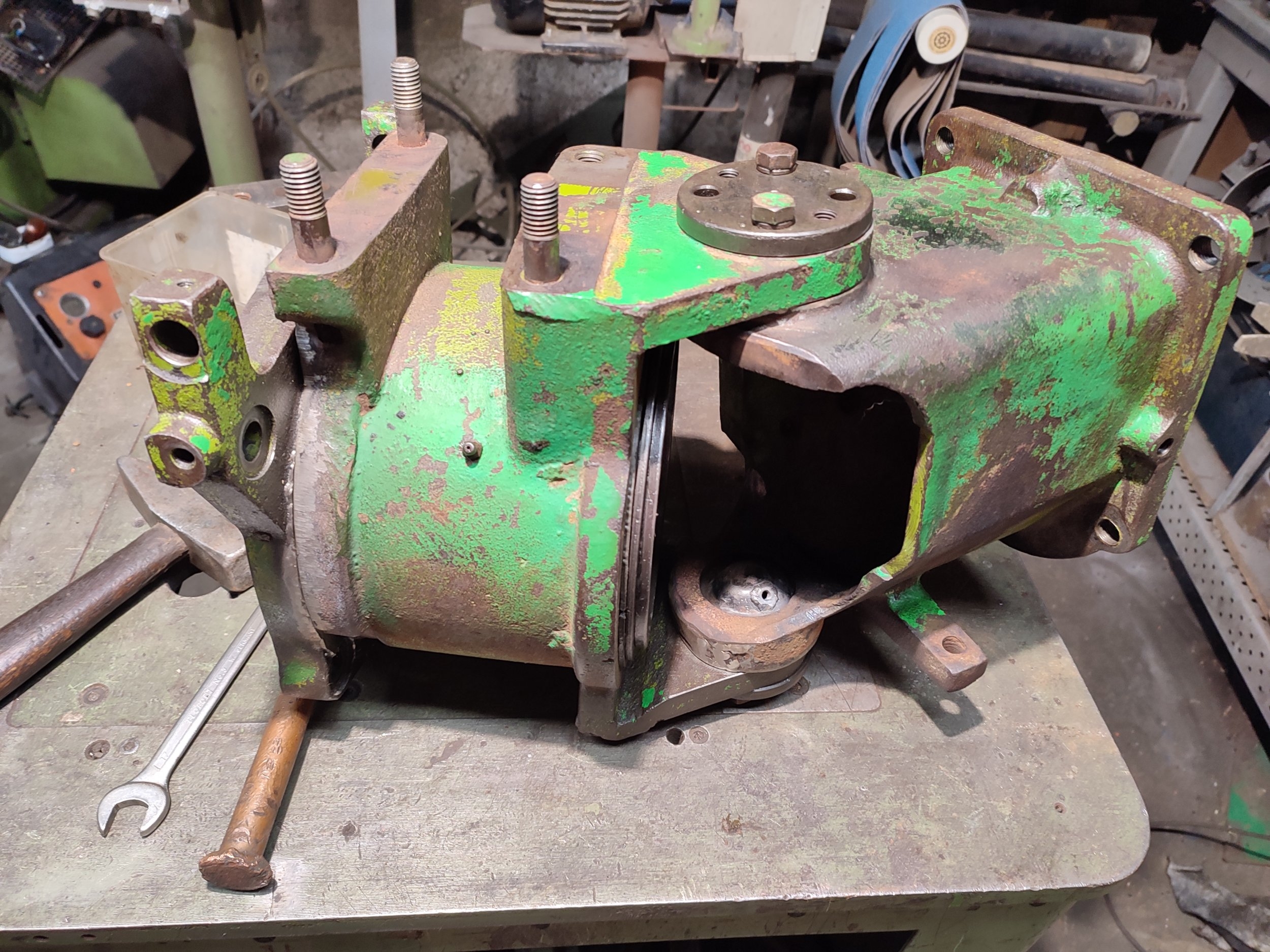

Before - After welding - After machining.
And finally, all the parts put together. Oh and turns out that when everything fits right without any extra play, the steering stops actually act as stops. Who would've guessed that? :)
