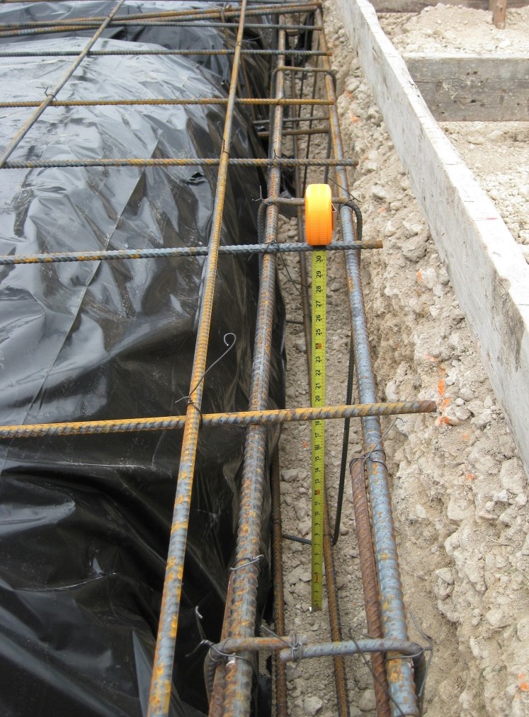

Here is a picture of the rebar and perimeter beam they spec'd for a covered porch on my house-30 x 17

I would go with design,#2.
Thicker concrete will help more than edge beam

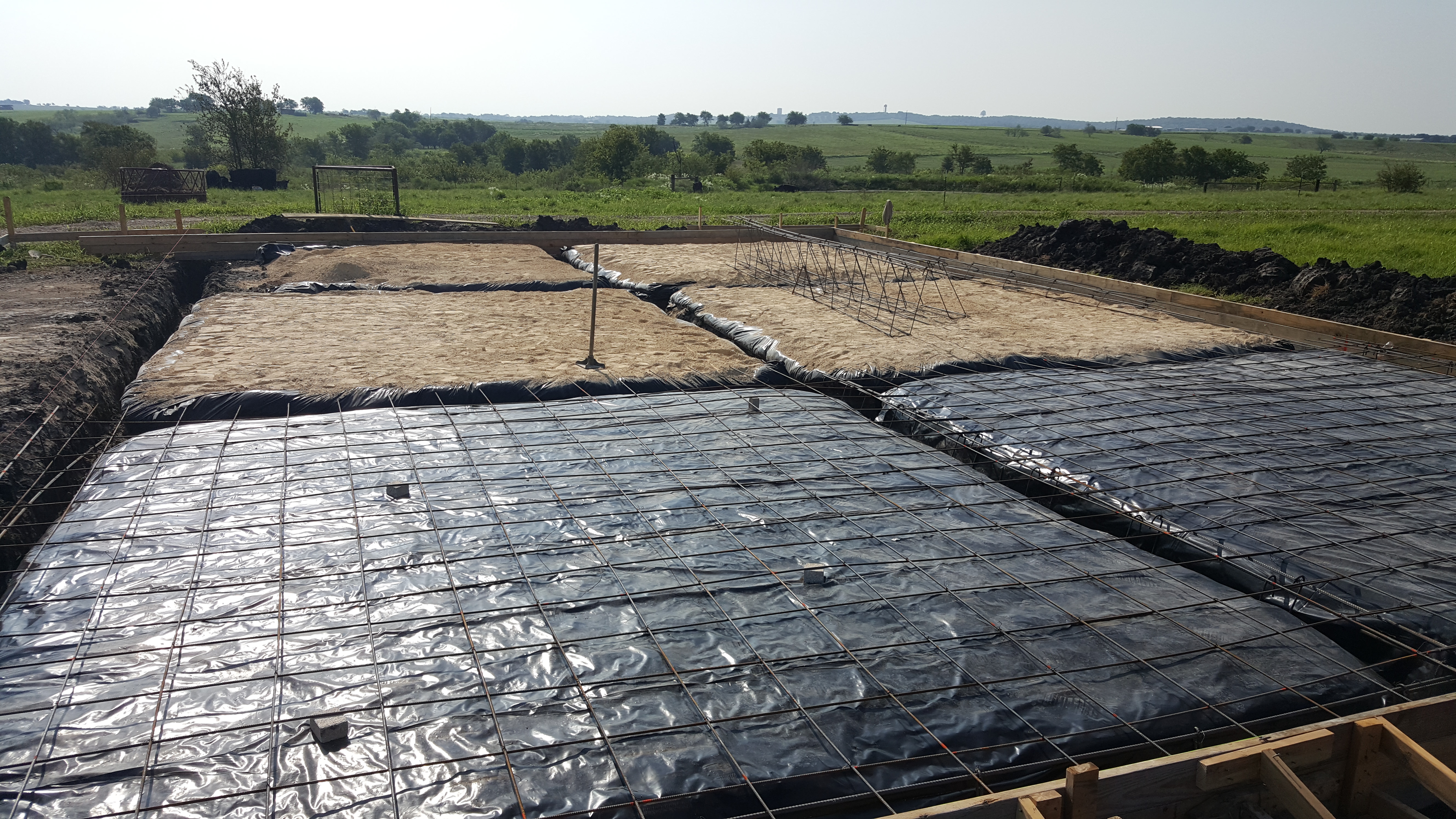

Luckily the frost level is 0" here, and maybe slopes 2 inches where I want the slab to go.
Below is a picture of the slab under my shop. This slab will be right next to it. The shop slab has 3' deep beams with #5 rebar. Just don't think a parking slab needs to be this beefy, but definitely want it to last.
With no slope, no frost and no need for footings (heavy point load on the slab) I don’t see a need to spend twice as much for a thickened edge. If you have good prep, the specified rebar, decent concrete and proper control joints a 4-5” slab should work just fine.
