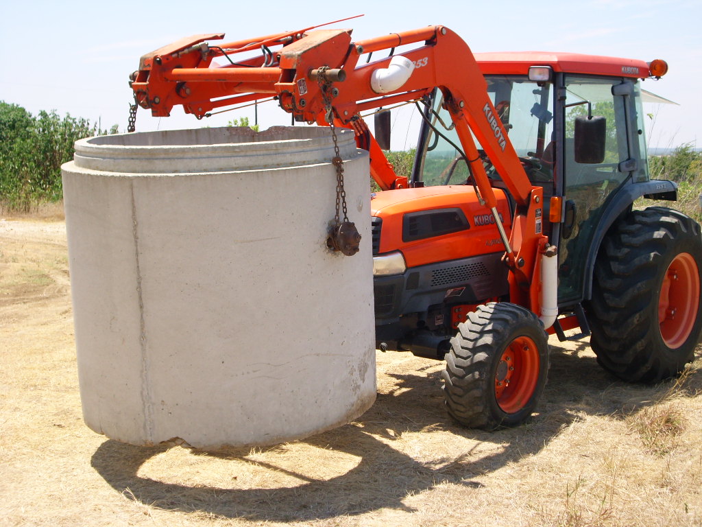

Been there, doing that...I have a source of free concrete culverts...defects in manufacturing...
Pick one of these suckers up, go to where you want a corner, plunk it down and there it sits. No drilling holes, no bracing posts. It doesn't rot. It doesn't pull out of the ground.
Wrap your wire around it, pull tight with ratchet strainers, all done.
I use T posts as line posts. Yes, they will rust away... in over 100 years.
