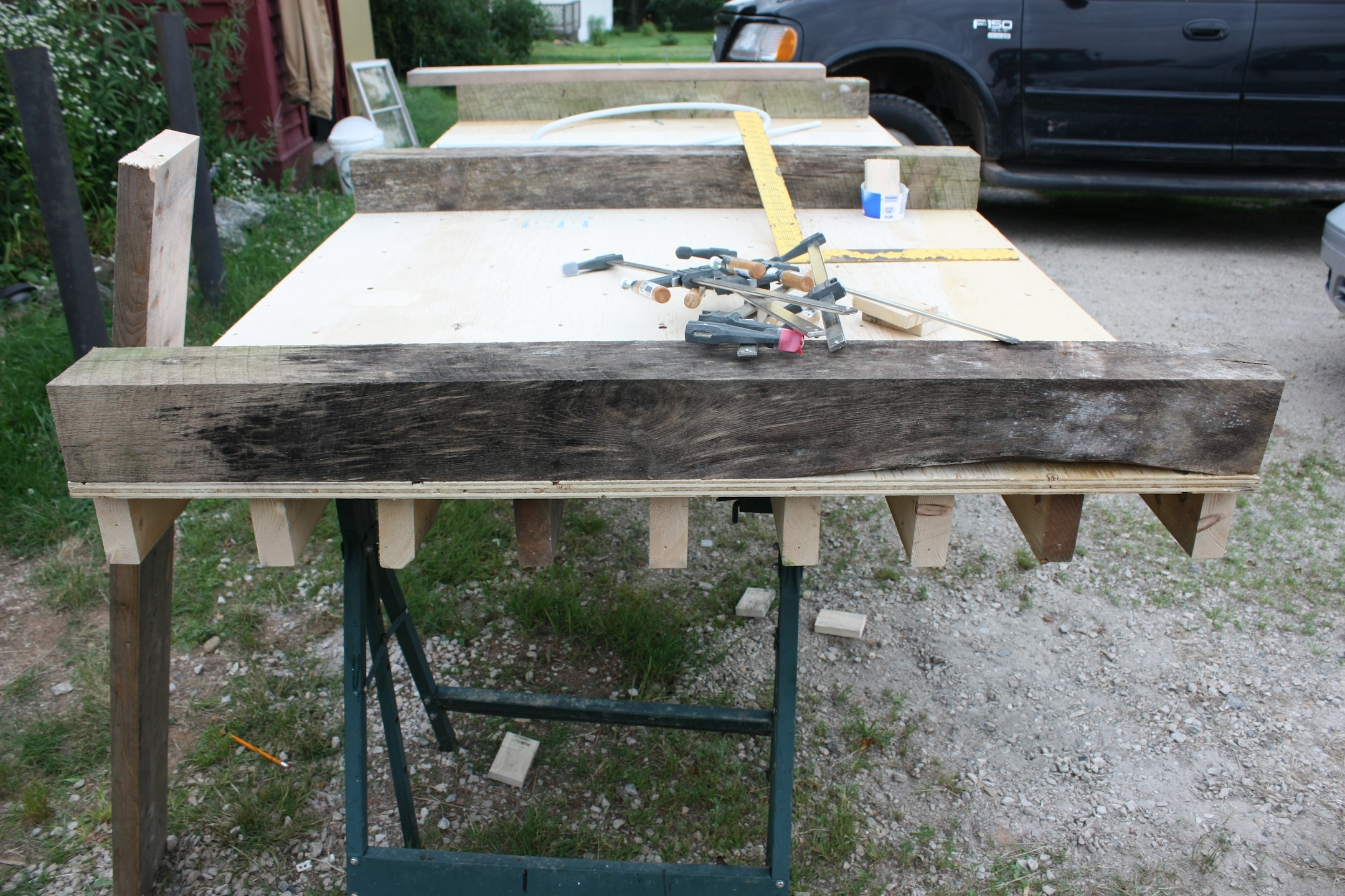

Ok... so the form is made.
We will be casting next week. We will get 6 4"x4"x8' posts plus 2 4"x5"x8' posts per cast.
I will mark 42" and 48" reference marks on concrete for hole depth. We are planning on placing 3/8"ID tube cut to 4" at intervals in the mould before pouring. The plan is to bolt a sacrificial vertical 2x6 to the concrete post. We can then nail the existing rails to the wood.
The 2x6 will be well above the ground as not to attract moisture.
We estimate post will be between 65 and 75 lbs each - I originally wanted 6"x6"x8'!!!!!
A 2x4x4" gets lag bolted on each end. These can be removed after the cast and set-up
and will hopefully assist removal. I gave the unit a quick coat of oil base paint and we will be using (trying) various release liquids.
Will keep you posted.

/ Concrete Posts. #51
Glad to see you followed through on this Loyd. Looks like you got a plan.
Looking forward to the results:thumbsup:
When is the first pour?

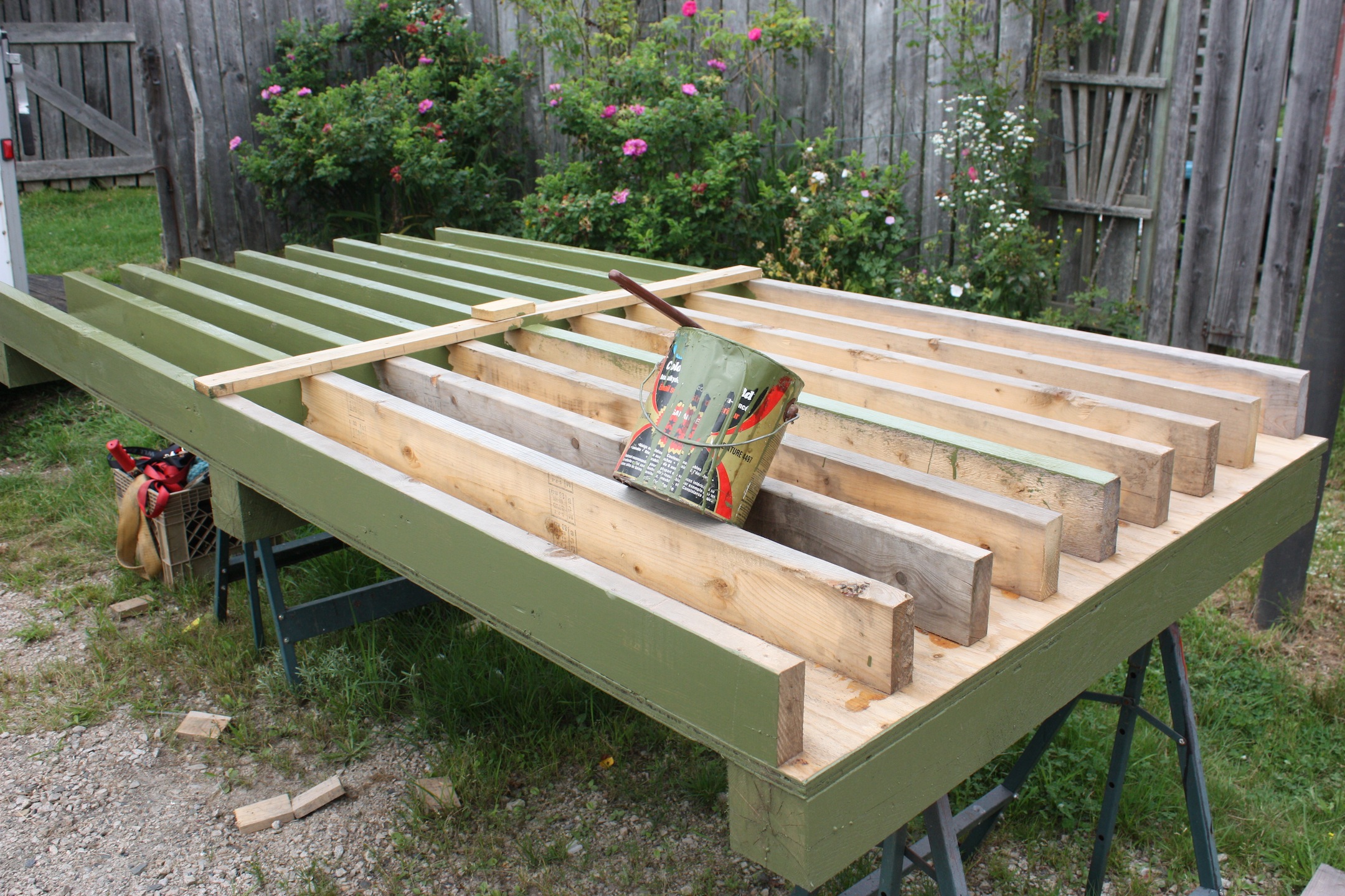

Hopefully tomorrow...
Form is complete. Marks for location of pex pipe and jig for hole placement in post is made and ready to be placed plus reference marks for 42" auger depth is scribed on form. Once the concrete is set a bit I will scribe posts at various marks - post hole depth, 1 and 2' marks from top and ground etc. Left over wire screen for slab is placed for reference and ready to cut for internal structural support. The pex pipe jig gets screwed into place holding the pex pipe vertical in the form. We will pour the mix around the pipe and into the form.
See pics...
P: form has two coats of oil base paint... just because...

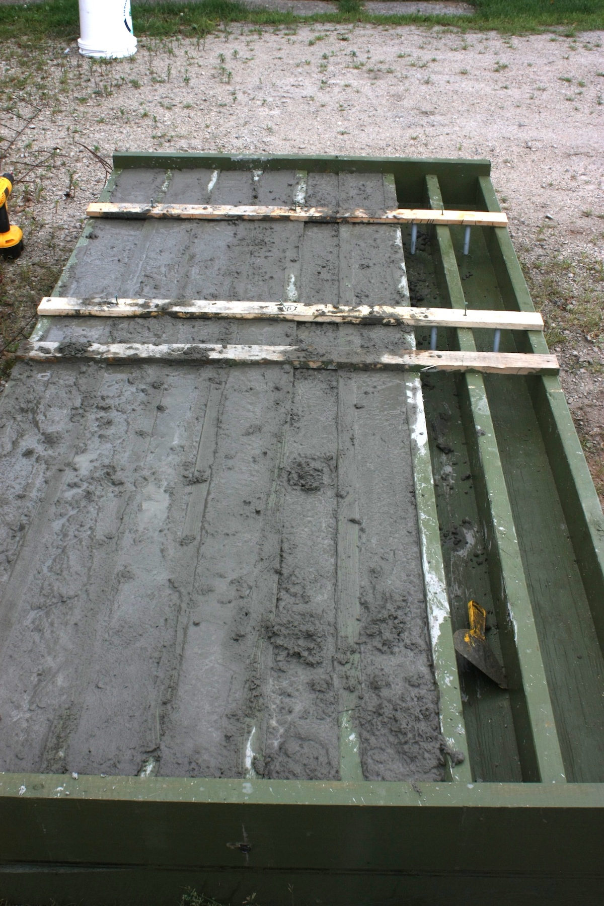

So, went at this alone... took about 3 hours - start to clean up.
I started with soap and water mix 80% soap - 20% water in a large spray bottle. It started to dry out quickly. I ended up brushing on soap 100%. Time will tell. Two guys would be better... one mixing and one pouring. I bent some old clothes hanger wire for handles and placed in a few - end that will be buried. I used an old broom/brush to go over once it started to set - very fast today - very hot. I used the spray bottle to go over it again with 100% water to cool it a bit. Will check on hardness tomorrow and hopefully release from mould Saturday morning. The rough side will be hidden with the sacrificial 2x6 which will be used to nail the rails to.

/ Concrete Posts. #60
Do you have one of those edge trowels, for rounding the corners/ edges on sidewalks, foundations, etc.? If you could run that down all edges, that would round them off nicely & reduce the likelihood of the corners breaking off.
