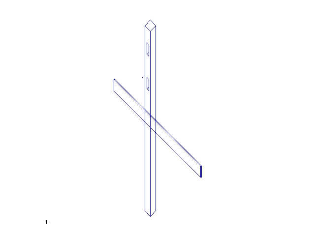

The attached pdf shows the following:page1 rough layout of 2x6 on 4"x8" plywood; Page2 showing portion in ground - large gray block - plus fence rails; Page3 fence rails only.
Dan, how big of a slot? My thoughts are if I am going to make a mould for smaller slots shouldn't I just enlarge them for the rails to go through? I assume on the back side of the slots would be a large backing plate or washer...
Not sure if I should add colour of not...
Do you think a heavy coat of rubber cement or contact cement would act as a release agent?
Or several coasts of varnish and maybe spray with oil...
The four circles represent 4 1/2" pvc pipe ganged together. This will give me a 2" vertical adjustment.
I am going to walk property and count posts but I think initially I will need around 180.
If I could cast 12 every 2 days it will take me 30 days to do the job.
Consider making the molds so that the sides lock together using the top and bottom portions. What I am getting at is, the posts are less likely to want to come out of a form with 3 sides regardless of the release agent. If you could dissassemble the form by knocking off the top and the bottom (short sides), then remove the outer posts, knock off the innner sparations (long sides) and so on. I think you will have better luck re-using them.
As Egon mentions, a thin plastic wrap that runs horizontly across the mold or from long side to long side, dipping down into the mold may work very well. I'm thinking even thinner than 2 mil something like what you would use for food preparation. The problem with using a plastic wrap is when it folds and bunches up on corners with more than 2 sides. If your only using it in one direction a careful installation should eliminate this issue, Then use whatever release agent on the top and the bottom(short sides).

If you could find a place that has real form plywood like Plywood Concrete Forms I would make your form out of it. I Like RobertBrowns idea of being able to disassemble the form to remove the post. I think one of the pdf's above had the plan designed like that.

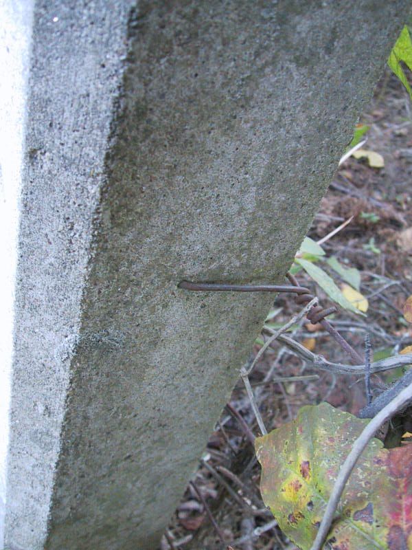

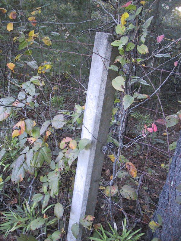

Been there, doing that...I have a source of free concrete culverts...defects in manufacturing...
Pick one of these suckers up, go to where you want a corner, plunk it down and there it sits. No drilling holes, no bracing posts. It doesn't rot. It doesn't pull out of the ground.
Wrap your wire around it, pull tight with ratchet strainers, all done.
I use T posts as line posts. Yes, they will rust away... in over 100 years.

If I was going to cast my own concrete posts I think I would have the form set up to imprint height indicators....
Would be handy setting the post and might be useful depending on the fence material.

A lot of great ideas especially the height imprint - every foot should work.
I also like the idea of dismantling the form; top and bottom could be hinged while the
2x6 form walls could be pegged into position and held in place with weight during the cure time. I am thinking of using epoxy or 4-6 coats of gloss varnish on everything and spraying with release agents...
