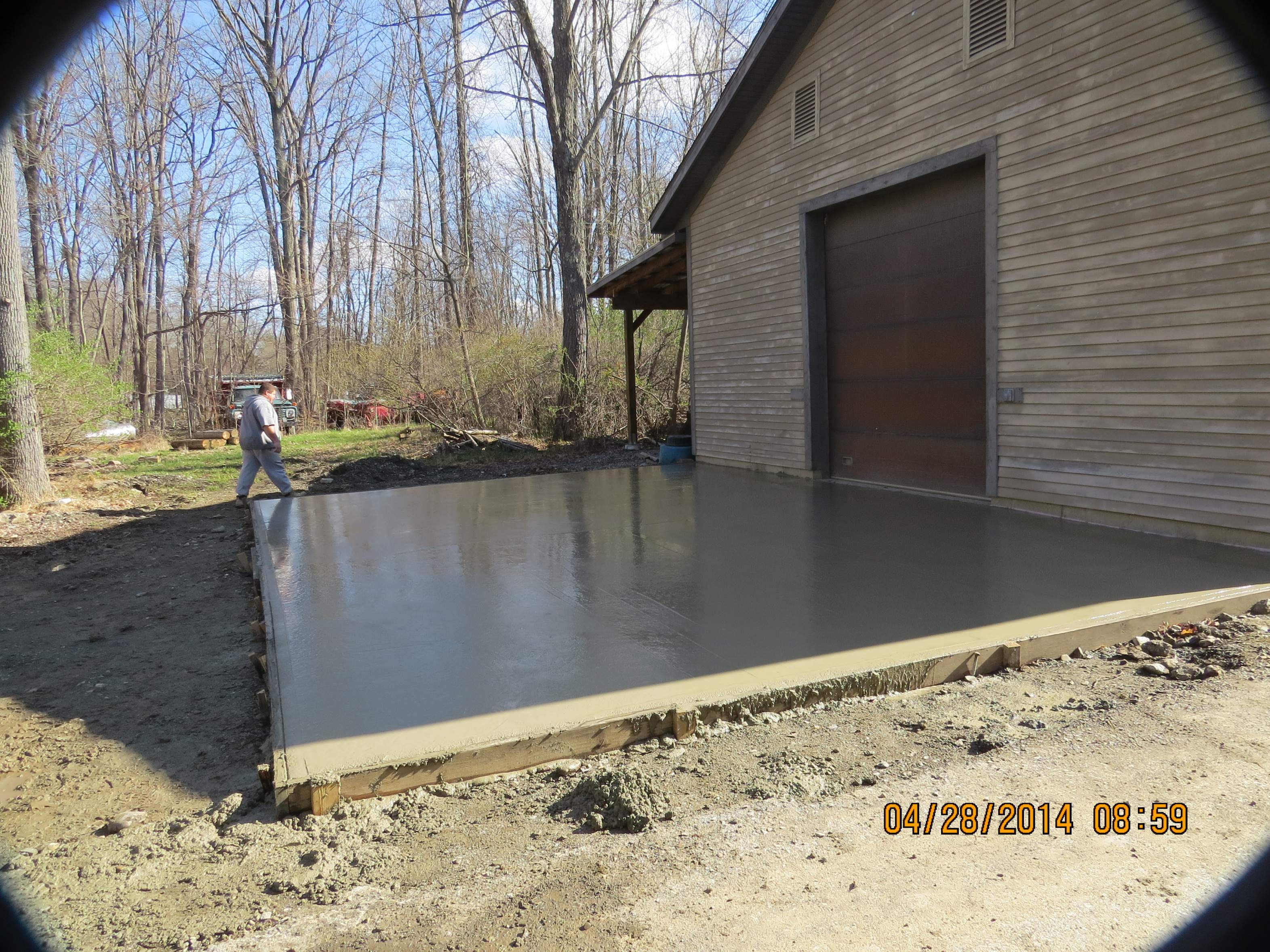

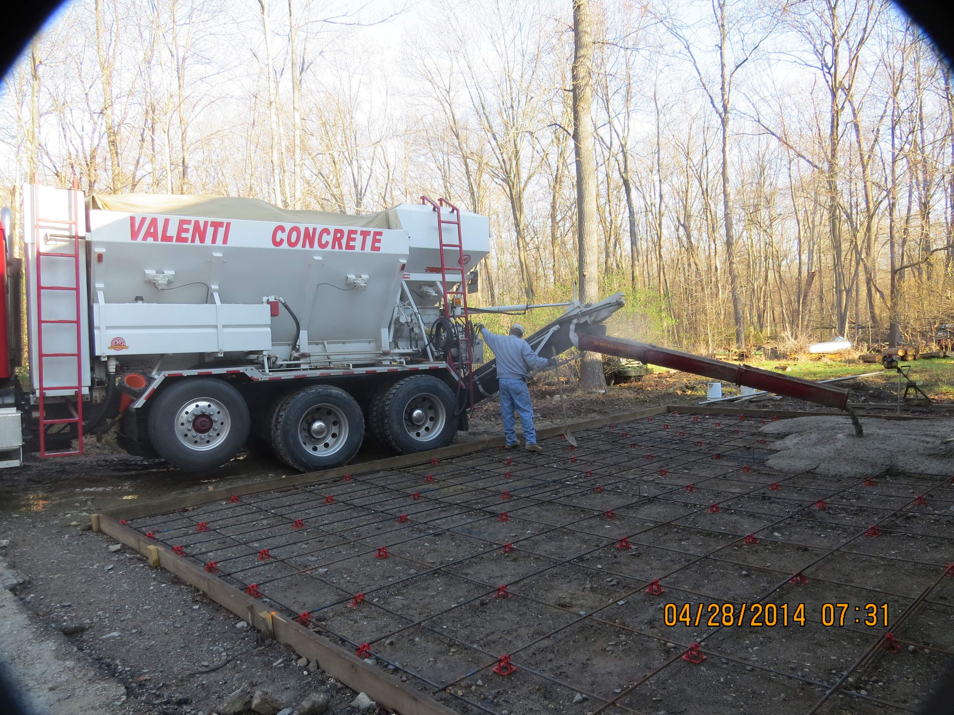

All done. under 3 hours. Only problem was it was 13 yd instead of 12. First truck had 12 1/2 on it so second truck was 1 yd min. Better than the bulk trucks though. $120 cy for 4000 psi mix. I really like the power screed. Meter MIxer.jpgIMG_0593.jpg
I am going to leave the float finish and not broom it. Control cuts go in tomorrow.

Nice Job.
A power screed is like a $45 rental where I rent from. ALWAYS money well spent.:thumbsup:

If you liked the power screed you would really like a laser screed. We have a small one we use on our bigger pours. We had to bring in a much larger laser screed the other day on a large pour for the basketball arena at the local college. It was pretty cool. Was able to screed 300+ yards of concrete in a few hours and be extremely precise. .

With all that re-bar in there you have a nice heavy-duty slab, should be super strong. Nice job, looks real good.

Nice looking job, sunset. I'm jealous!
