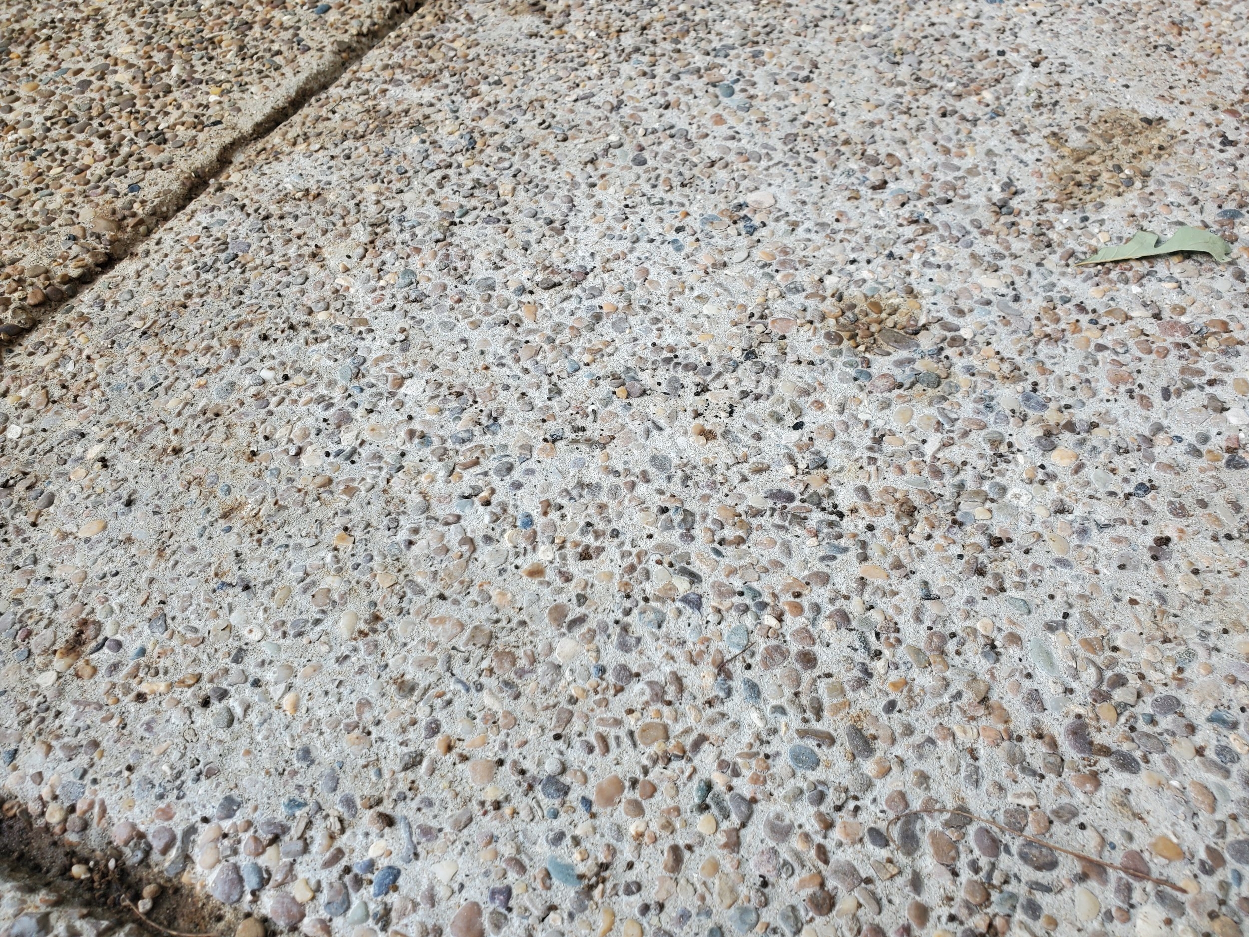

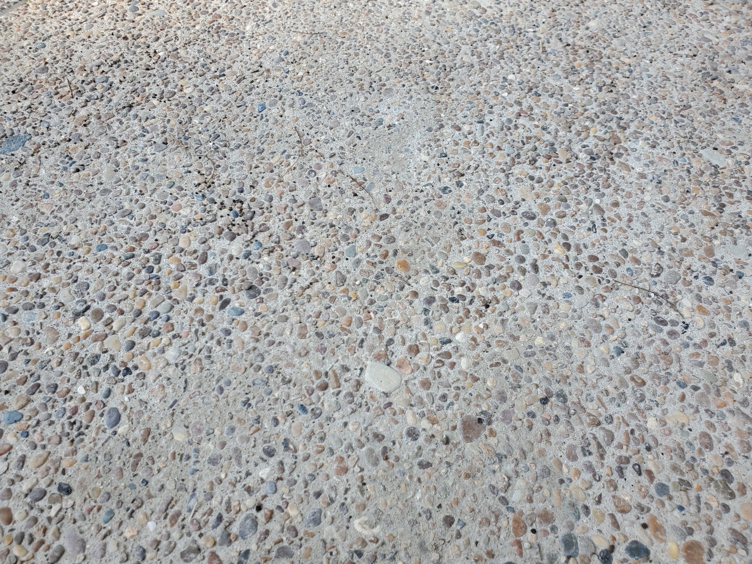

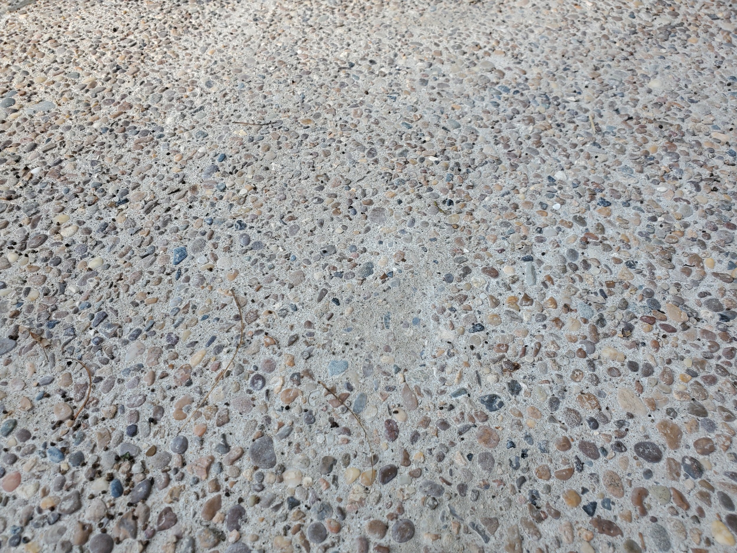

I hired a concrete contractor to make me a patio with exposed aggregate concrete.
The guy came, poured the concrete, sprayed the retarder, waited about 2 hours, washed and left.
When he was leaving i asked them why there are so many spots covered with the concrete, like 70-80%.
His answer was, it is send and concrete dust which tomorrow you can wash with regular hose. It is not going to harden.
Next morning i could not wash it not with regular hose, nor with jet spray.
I contacted him, he told me he would come later this day. Needless to say he never came, does not answer the phone, texts and such.
The question is: How do i remove a thin layer of the concrete to expose the aggregate?
I tried muriatic acid and KLEEN KREETE - no dice.
Are there any other options?

Tried it as well, the wire wheel leaves black/gray/silver metal color on the rocks, looks ugly.

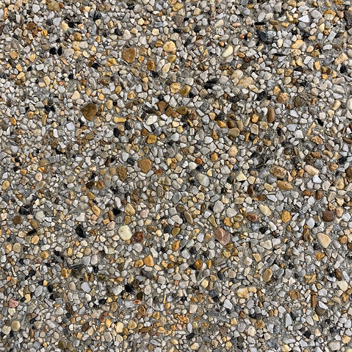

Here is what i was expecting:
Not this:

/ Exposed Aggregate concrete help #20
That is two very different methods and I believe your contractor should have known the difference. It's to late now, what you have will never look like what you want.
Yep. That's two different methods. Did you show your contractor that picture before he started or bid the price? One is the cheap route the other is a loaded aggregate. Typically done by hand and more expensive. You probably got what you paid for. But I wasn't there. :cool:
