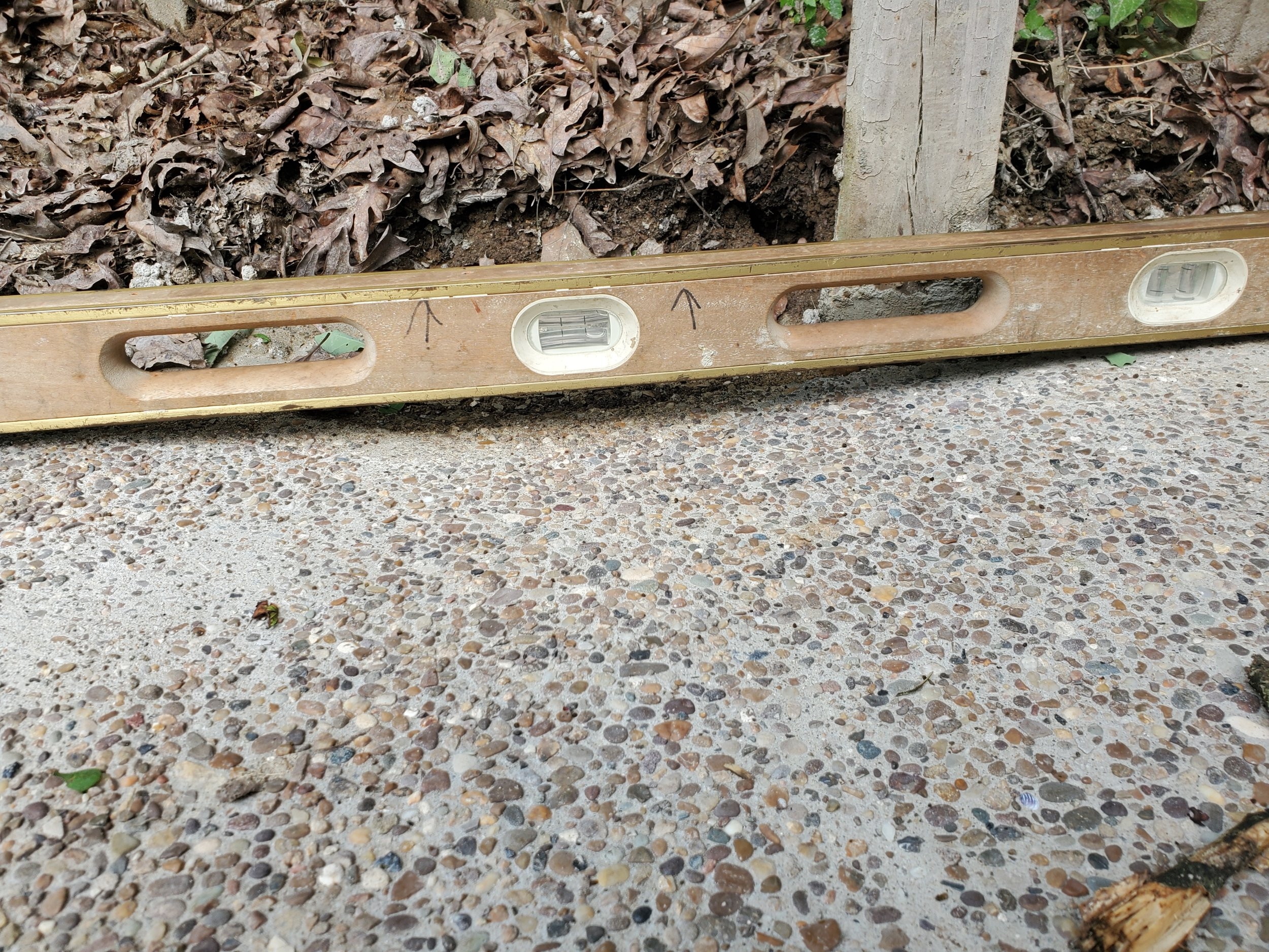

And the brake lines crooked for drainage as well? :), not it was supposed to be level because i'll put a row of decorative bricks-retaining wall on the edge.

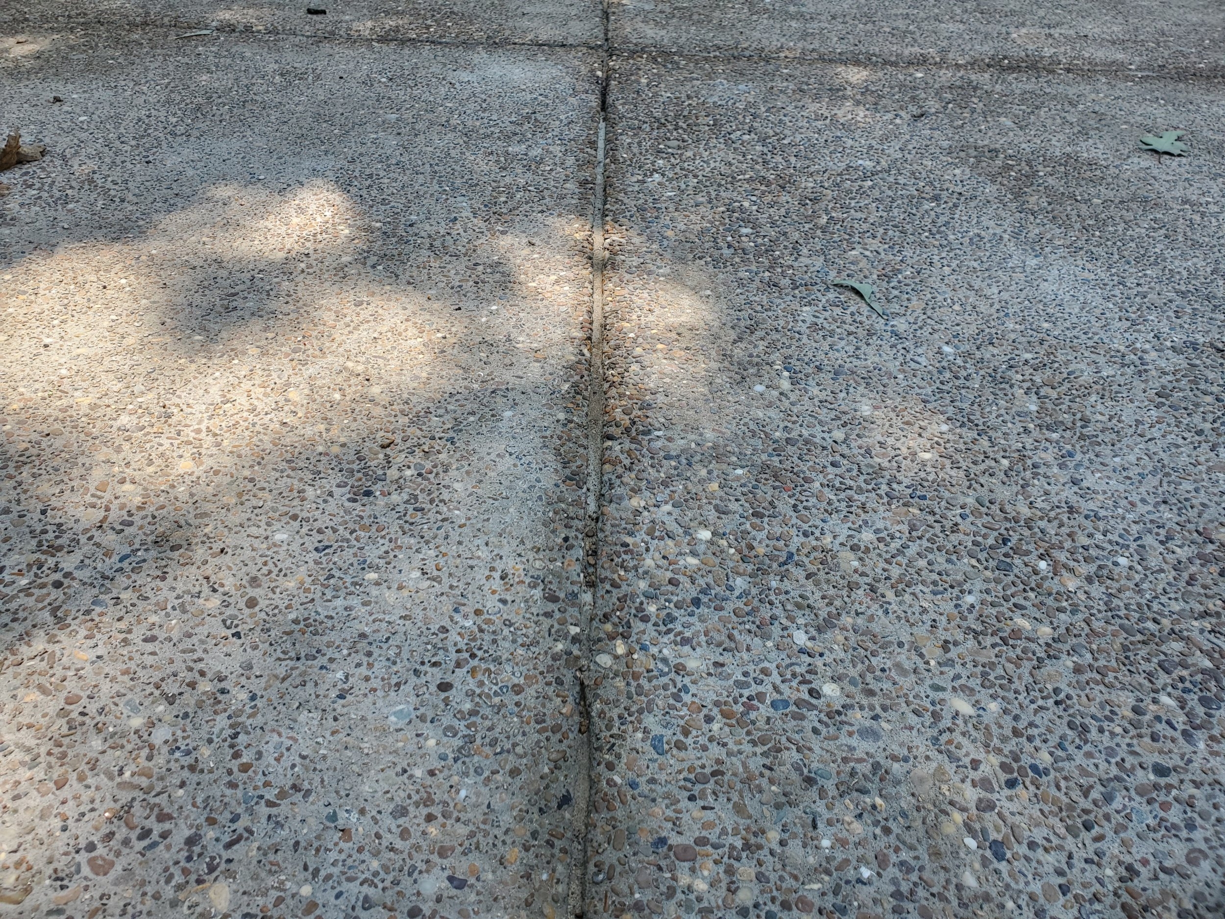

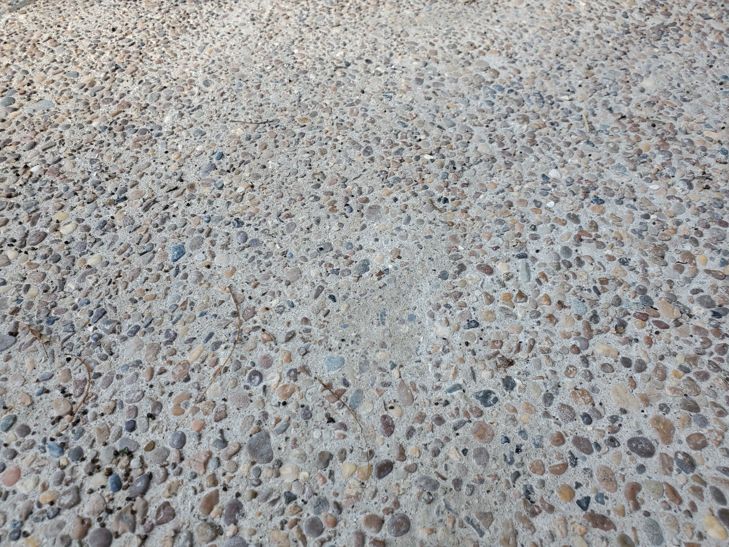

I poured concrete for nearly 20 years and was a journeyman cement mason in the 1970's and 80's. During that period, I poured and finished hundreds of swimming pool decks and patios. Most of the pool decks were either seeded exposed aggregate or Kool Deck.
My opinion is the workmanship is poor compared to most of the wash-exposed aggregate I have seen over the years.
Is there any way to make this job look like what you want? Other than removing and replacing it with a competently poured and finished patio, the answer is no. All the blasting and grinding in the world will not produce the finish you are looking for.
If you go with the "remove and replace" solution. I suggest having the contractor provide you with photos of his/her work and come to an agreement on the finish you want prior to signing the contract.

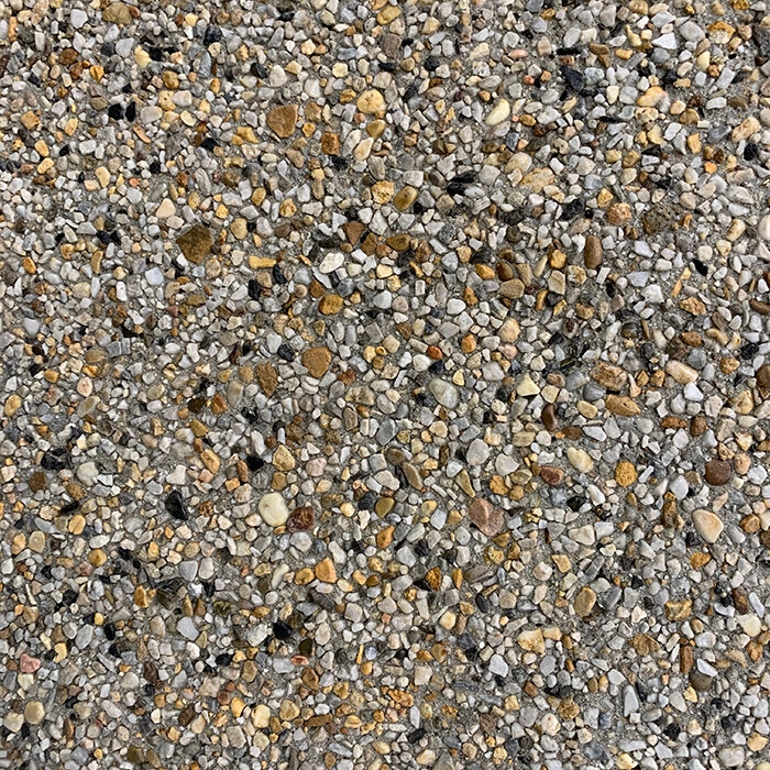

Here is what i was expecting:
Well, did you have a written contract? Did the contract contain one or more images of what you expected? Did this fellow have references? Did you visit any of his references for exposed aggregate jobs? Have you paid him? (If so, why!)

two final notes.
1. He gave me all wrong info, his name, his adres, his company name, the do not exists, so no way to find him, besides now i have more important thing to take care of. God will close account with him, such people never get rich not happy. He is going to run all his life.
2. I'm going to wash it two times with acid, then pressure washer, then acid stain light tan color, then seal it with wet look. I tried it on a small area, it worked. Not 100% but reasonable.

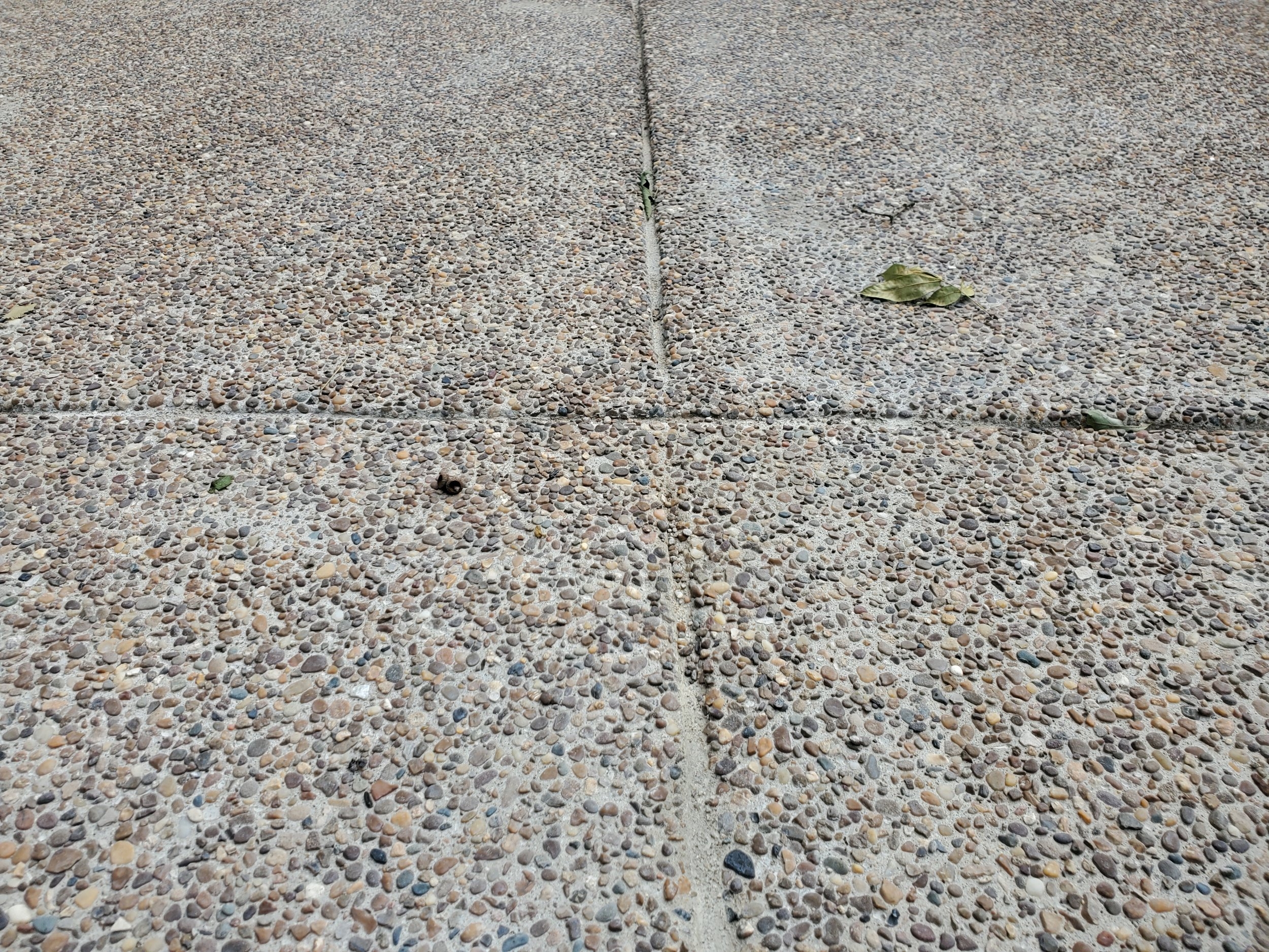

Looking for an advise and TBN collective wisdom.
I hired a concrete contractor to make me a patio with exposed aggregate concrete.
The guy came, poured the concrete, sprayed the retarder, waited about 2 hours, washed and left.
When he was leaving i asked them why there are so many spots covered with the concrete, like 70-80%.
His answer was, it is send and concrete dust which tomorrow you can wash with regular hose. It is not going to harden.
Next morning i could not wash it not with regular hose, nor with jet spray.
I contacted him, he told me he would come later this day. Needless to say he never came, does not answer the phone, texts and such.
The question is: How do i remove a thin layer of the concrete to expose the aggregate?
I tried muriatic acid and KLEEN KREETE - no dice.
Are there any other options?
View attachment 810840View attachment 810841

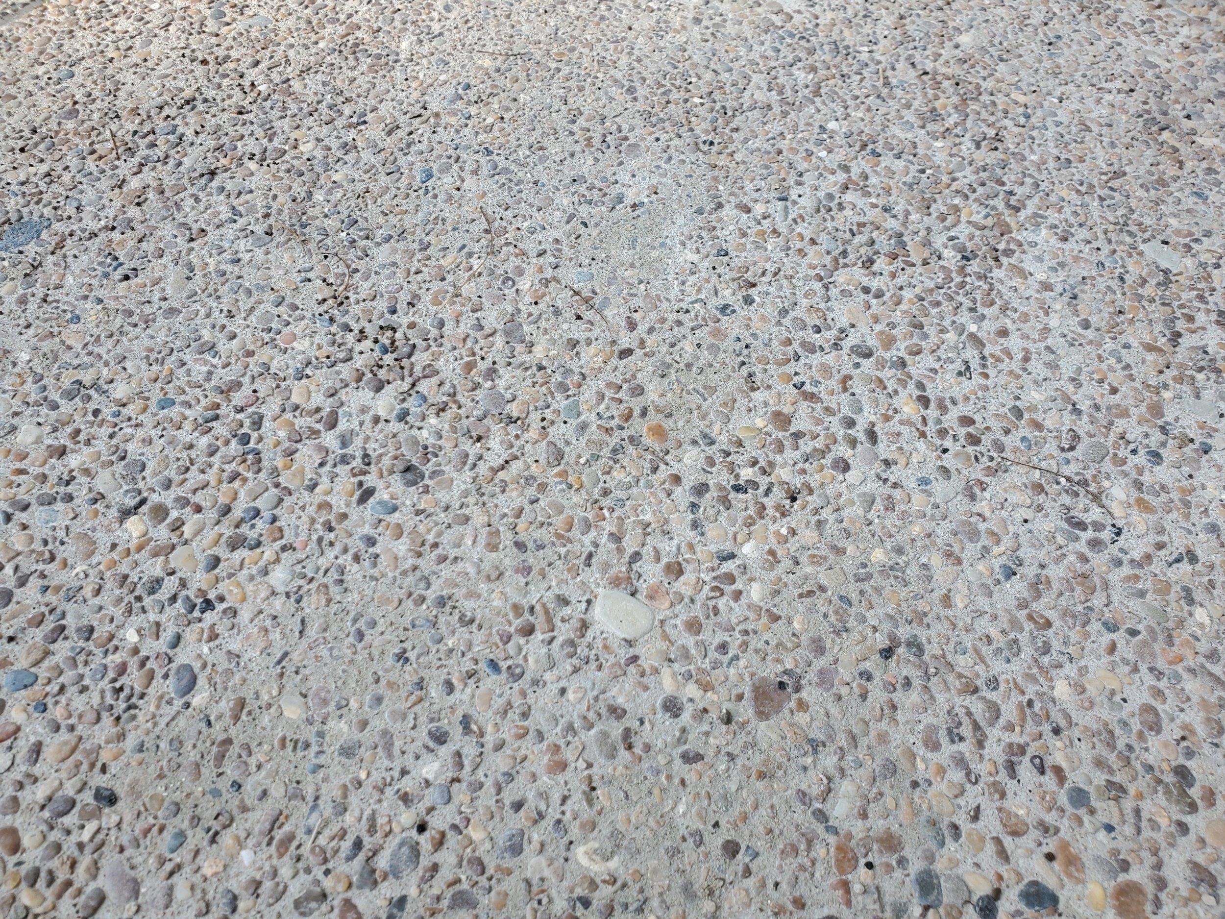

You need a terrazzo grinder. They should be available at a rental store. I have done small areas with a cup grinder an area that large needs the terrazzo grinder..

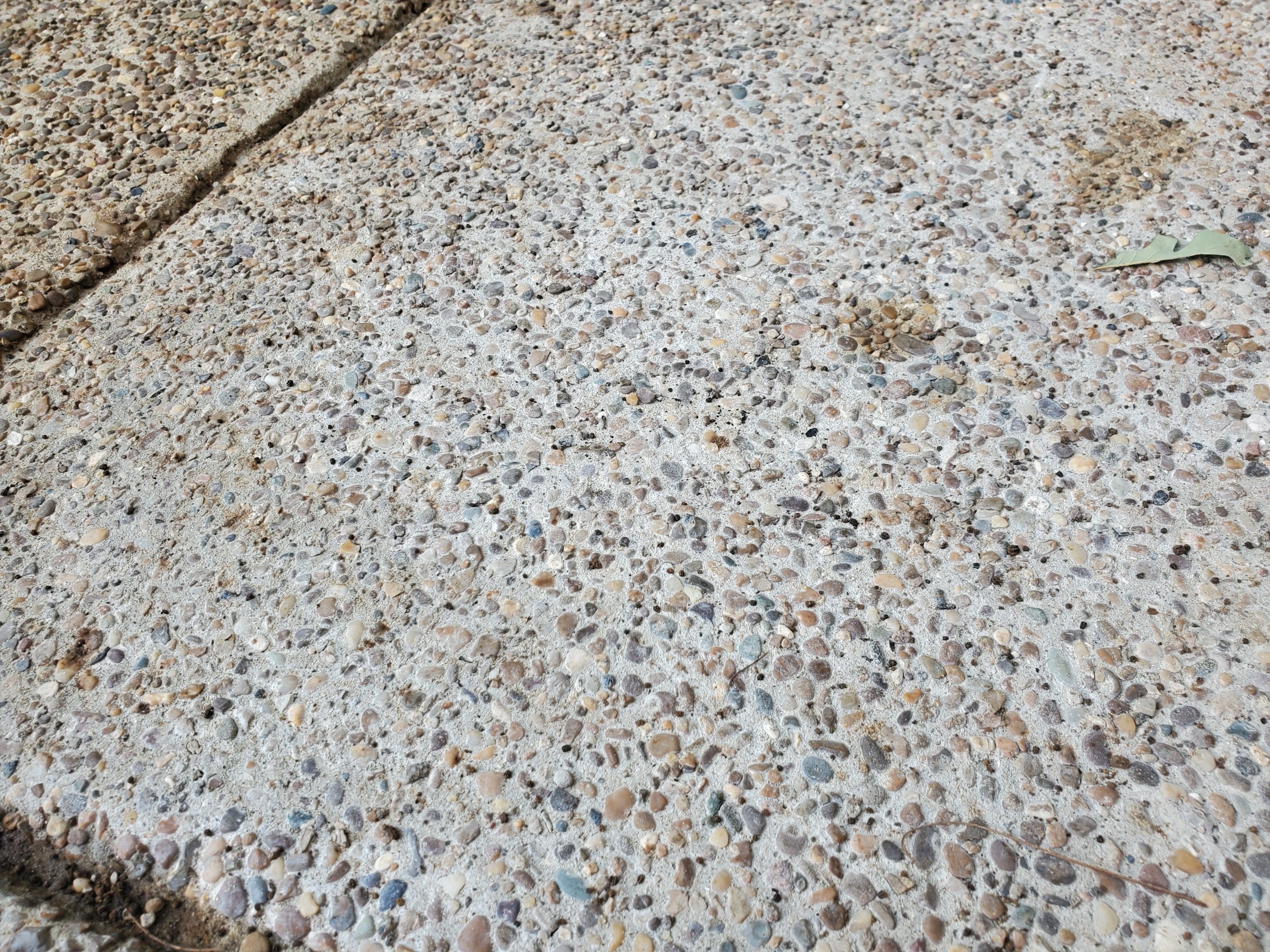

I am retired - but owned a company that fixed concrete problems. I currently consult with architects and owners in commercial construction projects.
First - Don't panic and do something to ruin what you have. It can be made to look much more like what you desire. And - Yes, you CAN make it worse. Especially by following many of the in-experienced ( and some hare-brained ) advisements I see in this thread.
Second - contact a company called ProSoCo. They are on line. They are the biggest and best at finding ways to fix and maintain exposed aggregate as well as many other forms of decorative concrete. They will have a rep that work with commercial construction material supplies that serve your area. Find out the names of the companies that sell their products.
Third - Once you know more about how the ProSoCo cleaners, acid based detergents, and sealers work - decide if it is something you want to perform or have a contractor that specializes in this type of "cleaning up behind a slob" work do this. After cleaning - this surface will need a penetrative water repellent applied to prevent freeze/thaw spalling ( rocks popping out )
And - lastly...folks who have no actual experience in these things seem to feel empowered to get on a computer and tell someone else how to fix" a problem. They ought to be head slapped for that. And, you really should do your research for fixing this with an attorney letter to the concrete contractor - and Google. Not a discussion forum about tractors.
I will private message you my phone number and if I can be of further help - please give me a call. I feel your pain, and in honor of your wife and her diagnosis - and will do my best to answer any questions and direct you to people/places for getting this solved.
