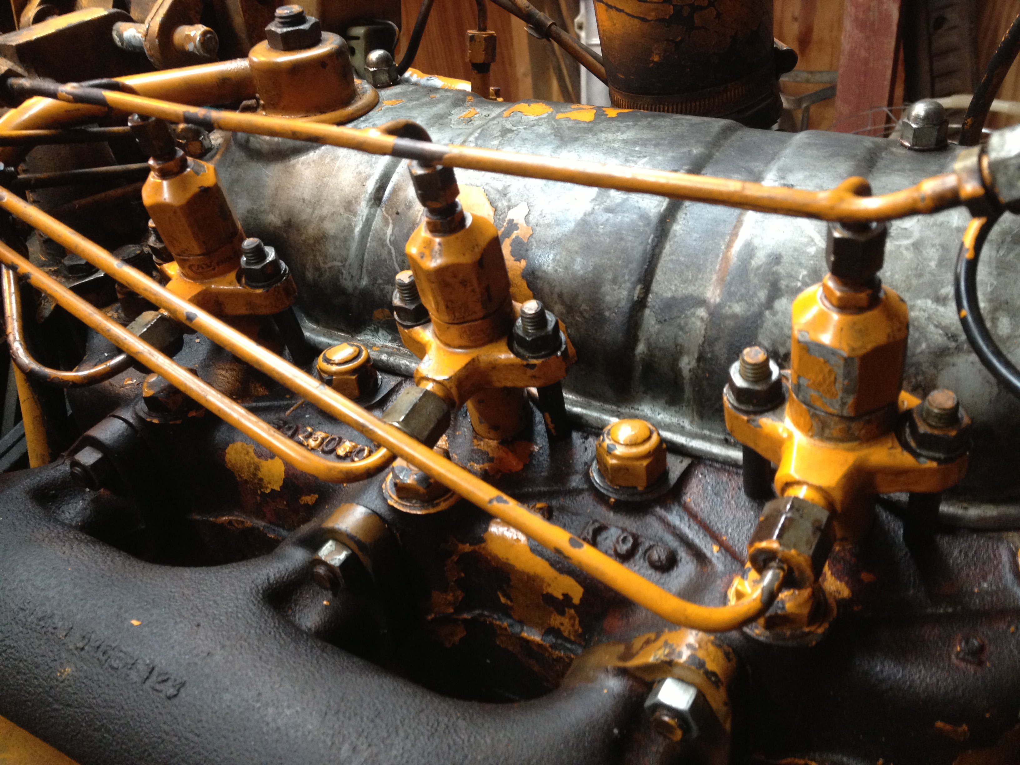

How do I test compression on an engine with bolt on CAV injectors? Every kit I see seems to thread into the cylinder head.
Is there an adapter or special tool for this type of cylinder head? Or can I take apart an injector and thread the compression tester onto it?
Engine is in a 1980 Case 380CK.

Nice pic. Artistry in engineering!
Don't take your injectors apart!!!
Remove injectors and install adaptor. You may be able to hire them in US from NAPA or a diesel shop?
Snap-on has various types for approx $120. eg. Adaptor, Diesel Compression Gauge

The issue might be pulling the injectors. They can be a bugger.

On this engine there is only a cold start assist located on the intake manifold.
