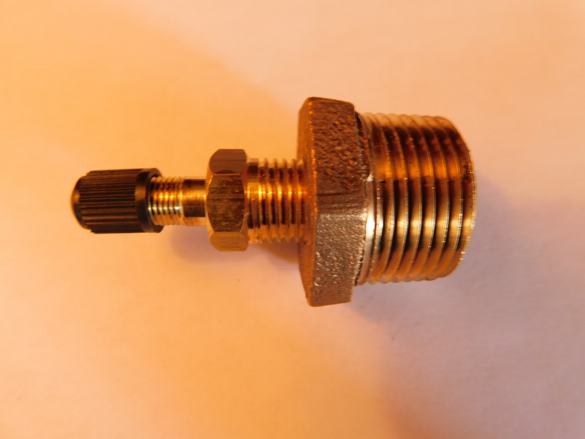

another good post for my challenge. i can basically gravity drain my system under sink as the pump house is below the cabin. but pockets remain such as tankless water heater reservoirs. during the outage the reservoirs froze solid necessitating new purchase ($600, ouch). so i will need to air purge as well under the sink.

thanks to the info in this thread lead me to the simplest adapter shrade/3/4 pipe thread thanks for input on this

I like to use a larger fitting than a tire valve so that a greater volume of air gets into the pipe quickly to get the water moving. You want lots of volume of air quickly. I usually just use a rubber air hose nozzle and push it against an open spigot at a high point in my plumbing. Open a spigot at the far end - usually a garden spigot, set my air pressure to 60/70 psi, and give it successive 10 or 20 second shots until water quits coming out the far end of the plumbing.
