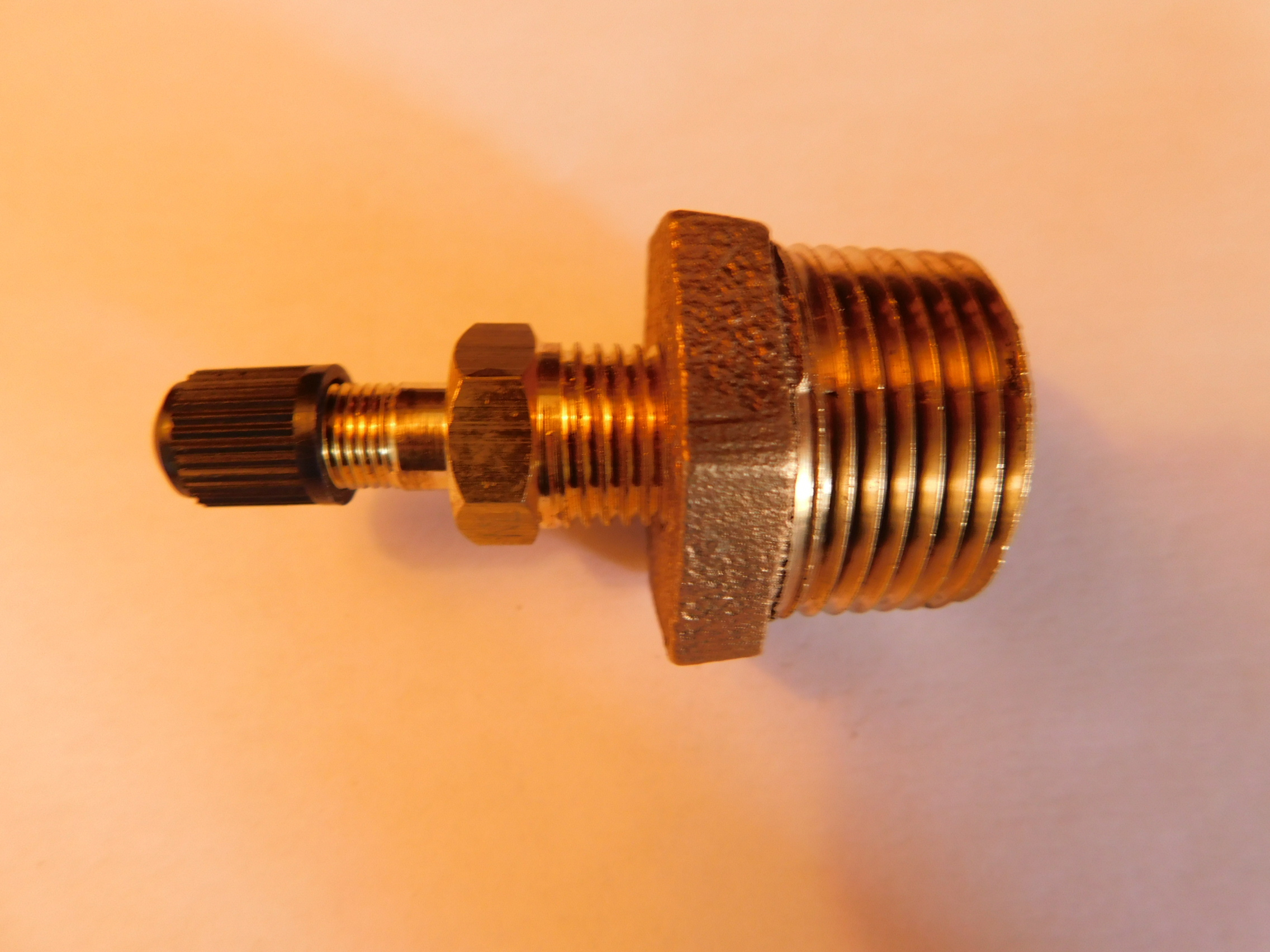

thanks to the info in this thread lead me to the simplest adapter shrade/3/4 pipe thread thanks for input on this

I like to use a larger fitting than a tire valve so that a greater volume of air gets into the pipe quickly to get the water moving. You want lots of volume of air quickly. I usually just use a rubber air hose nozzle and push it against an open spigot at a high point in my plumbing. Open a spigot at the far end - usually a garden spigot, set my air pressure to 60/70 psi, and give it successive 10 or 20 second shots until water quits coming out the far end of the plumbing.
