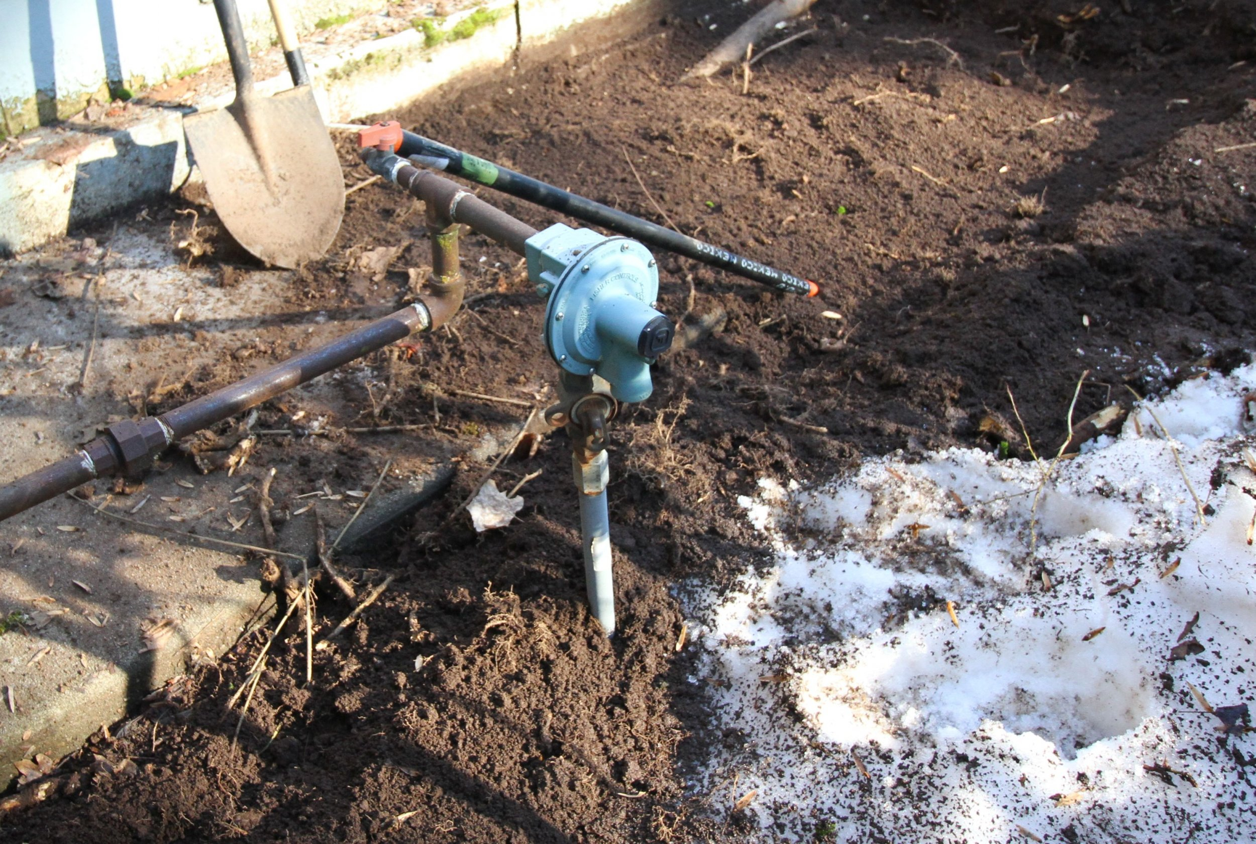

To those advising I not do such work, the grand total of work involves about 3 extra feet of pipe, replacing a T, and a new shut off valve. There is a union already in the existing pipe which makes disassembly and reassembly easier. Everything is outdoors. No gas inside the residence, no pipes in walls, etc. And there was an existing propane appliance (spa heater) that is being replaced.
I'm not minimizing, at all, that things should be done correctly, safely, and to code. That's why I am posting with questions.
I'll take a photo of the existing piping and slab location and post that later.

What generator? That will tell you the gas line size needed.
3/4" should be fine for most under 22K or so. My 16K required 3/4" up to 80' or so.
If you're doing LP, you need to be off the low side of a second stage regulator.
I used a mix of yellow paste or tape based on what I had handy at the moment. Used a T-post to stabilize pipe where needed. I also pressure tested everything to 15 pounds for 24 hours --- didn't drop a bit.

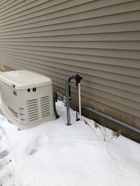

As a point of reference.
I just had a 22kW standby generator installed last September.
The propane supplier made the connections along with bringing in a 500gal tank. The previous existing line to the house was left as is. A dedicated supply was run to the generator from the tank. The propane installer fabbed up a black pipe manifold at the tank and connected both lines to that.
The work was high quality and I'm happy knowing that there is a dedicated line to the house and the generator.
Something else that surprised me was that the installer ran a 1" plastic pipe vent from the vent on the regulator at the generator about 12' away from the generator with a screen on the end to keep out bugs. I asked why that was done and he said that with the regulator being at the generator, the generator could be a flame source if the regulator vented with the generator running. I would not have known that was a code requirement in my locale.

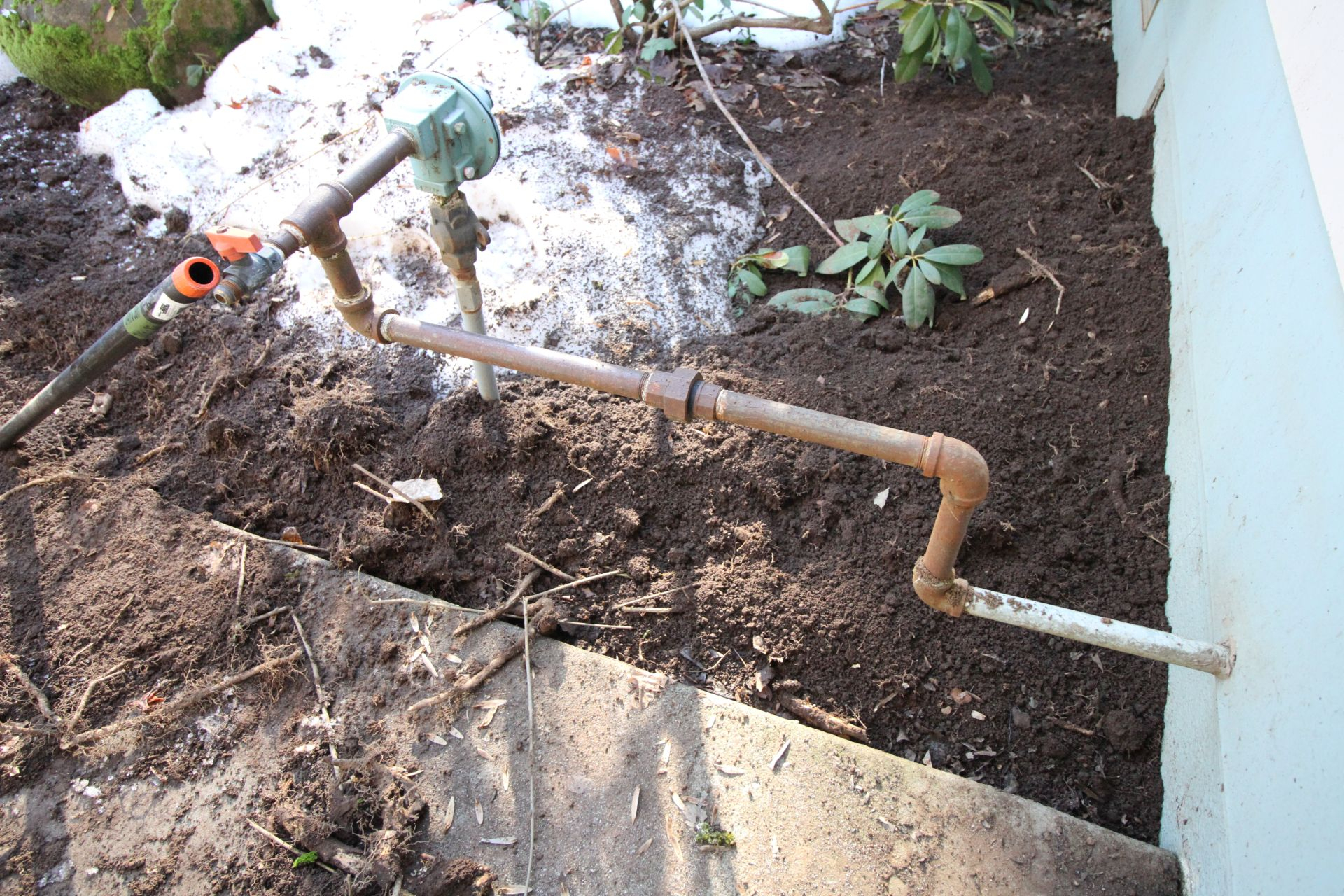

I will double check the btu's and answer a few questions (soon) in a later post. I do agree it must be rated at substantially more btu's than that .... will check.
Here are a couple of pix ... it's 3/4" pipe. I placed the black pipe in the direction I want to run it, just setting it for an example. Where the propane line goes into the house-- it runs about 10 feet and feeds a water heater. No other gas demand.
The main tank is about 50 feet away. I can trench and install a home run pipe if needed .....
