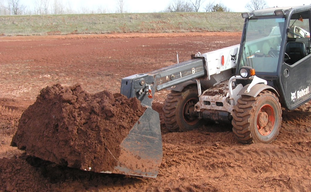

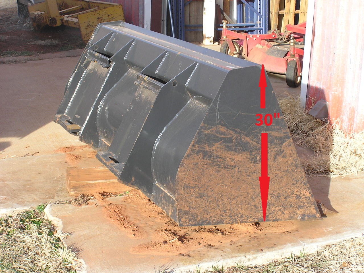

My 6' wide, 1 yard SSQA bucket is from Bobcat:
With 17 feet of lift, it has no problem loading a truck. 👍
View attachment 574275 View attachment 574276 View attachment 574277 View attachment 574280
With 17 feet of lift, it has no problem loading a truck. :thumbsup:
Mine is deeper but not as tall (also 6ft wide). I like the shape because I can see the front edge of the bucket if I scoot forward on the seat and sit tall. I can't do that with my stock bucket. At 778 pounds, yours is much heavier duty. I weighed mine right at 500 pounds but it is plenty heavy duty for a CUT and the weight savings helps me because I don't have the kind of lift force that you have.
