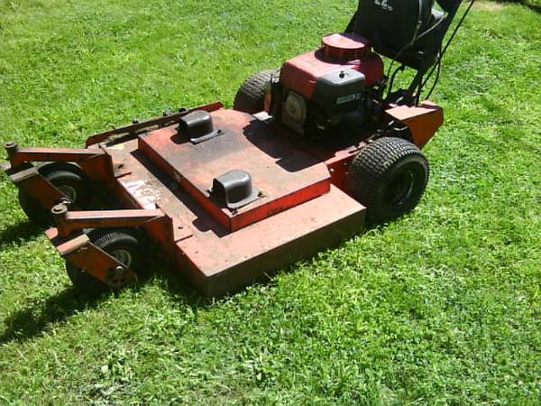

Kees 1.jpgCame with a 12hp originally... someone put a Honda 8hp on there and blew it.. now its mine :)
DR Field and Brush's come with a 17hp Kaw..
/ Compact tractor horse power #34
<img src="http://www.tractorbynet.com/forums/attachment.php?attachmentid=328639"/>Came with a 12hp originally... someone put a Honda 8hp on there and blew it.. now its mine :)
IC. A beast of a walk behind. I have a DR with a 15 HP Kaw and it is sweet. Just wasn't thinking of it when you said walk behind.
/ Compact tractor horse power #35
LOL.. I got ya... Would be cool though.. Imagine a 12 horse on this :)
