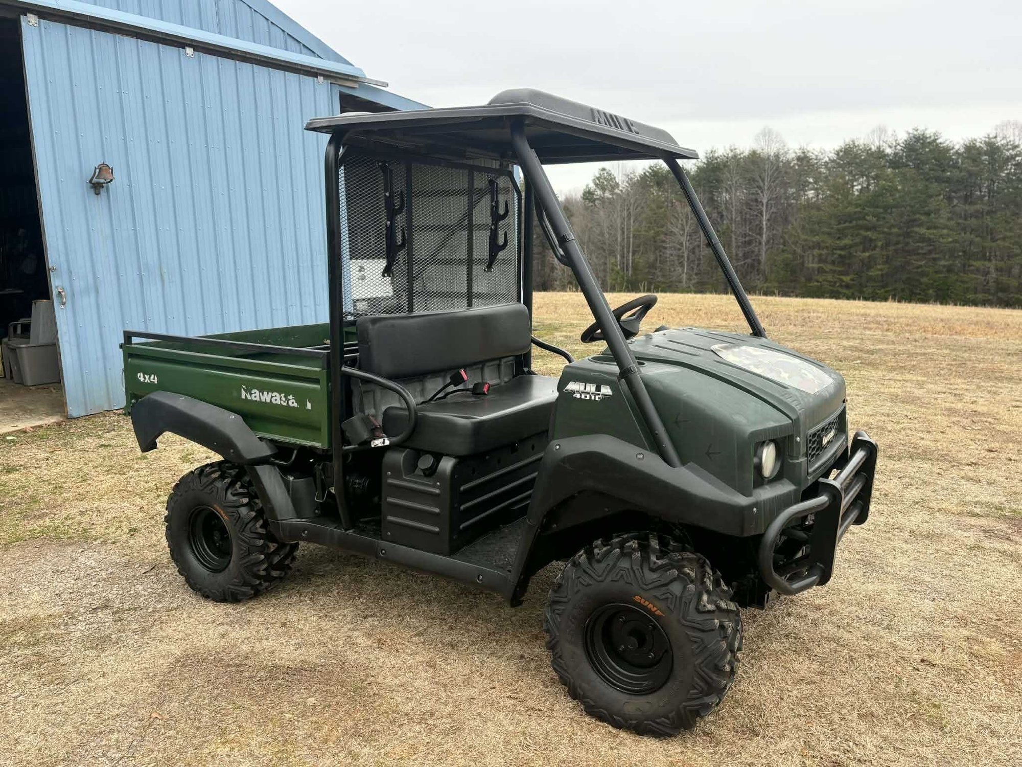

I’ve got 2 Cats but Kubota offers a hard to beat deal in a skid steer and mini excavator. And I’m sure his brother could figure out how to work on a Kubota.
