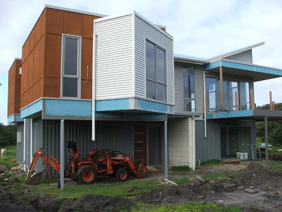

If space and transport are not significant problems I think you'll be sorry pretty quickly if you get a small TLB. I've never owned a full size TLB. I've just got this B1550 Compact, and whilst its been invaluble (and wonderfully manouverable) its limitations are very obvious. My requirements were pretty similar to yours except I had a much smaller block - just an acre. I also had a transport problem. (It would have cost a small fortune to get a full size tractor to the site, but I was able to tow this down myself on a car trailer. And I'm going to be towing it to some other sites too). But the small tractors just don't have the weight (traction), lift power, lift height, and backhoe reach to do big jobs quickly. In some cases they don't have the balls to do the big jobs at all, and believe me, you WILL want to tackle bigger jobs than you think at the moment. Although I could sell it for what I paid for it, I'll probably keep this little beast for quite a while yet, but in hindsight a full size TLB would have been more useful... and possibly cheaper. My advice to you then it to get a full size TLB. You've got plenty of space. But in my opinion, one ABSOLUTE MUST on any TLB is a 4in1 loader bucket, especially for the site work you have planned where you'll want to do a lot of dozing, scraping and 'picking up'. You'll find more of those, cheaper, on full size TLB's too.
