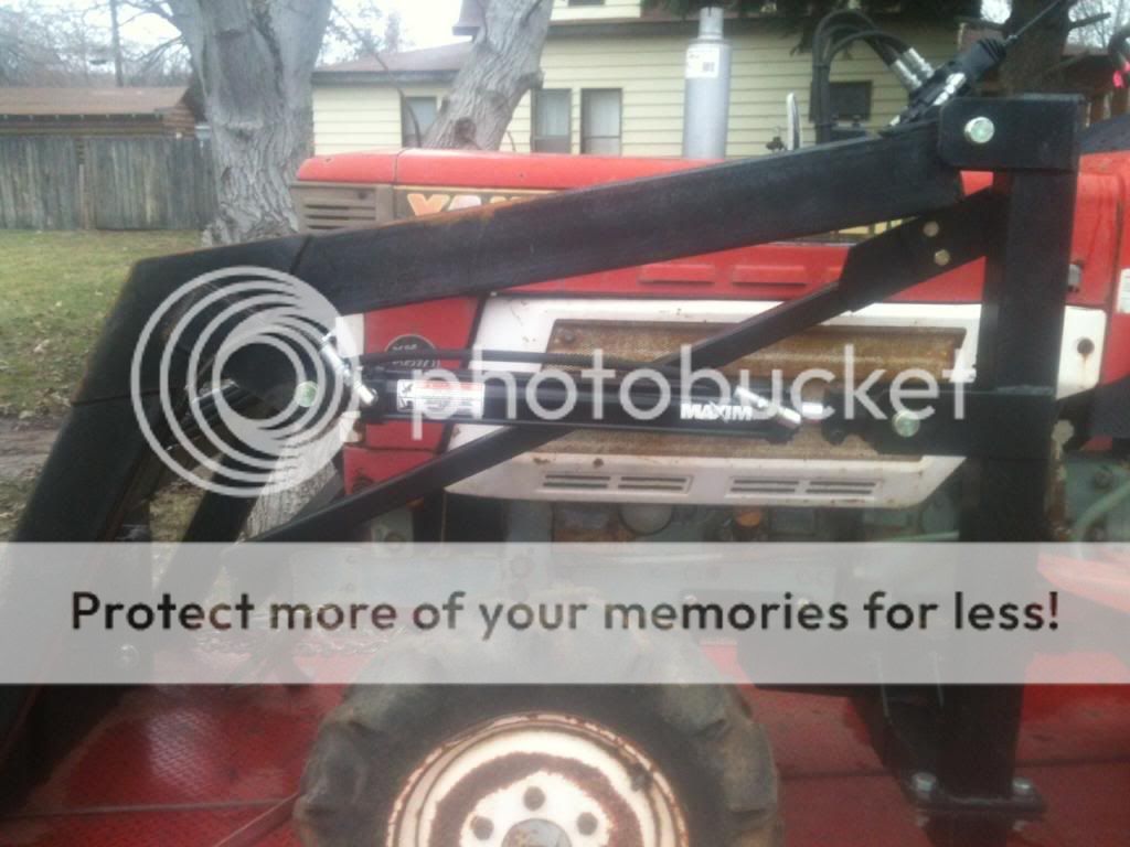

I will send a picture of what mine looks like soon.
/ Cold water tractor loader just ordered! #25
Is there an easy way to make it quick attach/detach?
/ Cold water tractor loader just ordered! #26
I bought my 2210 DB and my loader and post hole digger from them. Although I was a little disappointed in the fact that my tractor WAS NOT serviced in any way/shape or form and my 4x4 died within an hour of use (locked up, bad bearing) and had to be rebuilt, I LOVE THE LOADER. I picked it all up as they are 8 hours from me and since I rebuilt the 4x4, so far (FINGERS CROSSED) no more issues thanks to the fellas on here and lots of advise.The loader works wonders.
#28
Looks nice. I will be getting the loader next Wednesday. It's sitting an hour away. They don't deliver up here till then. **** mad !
