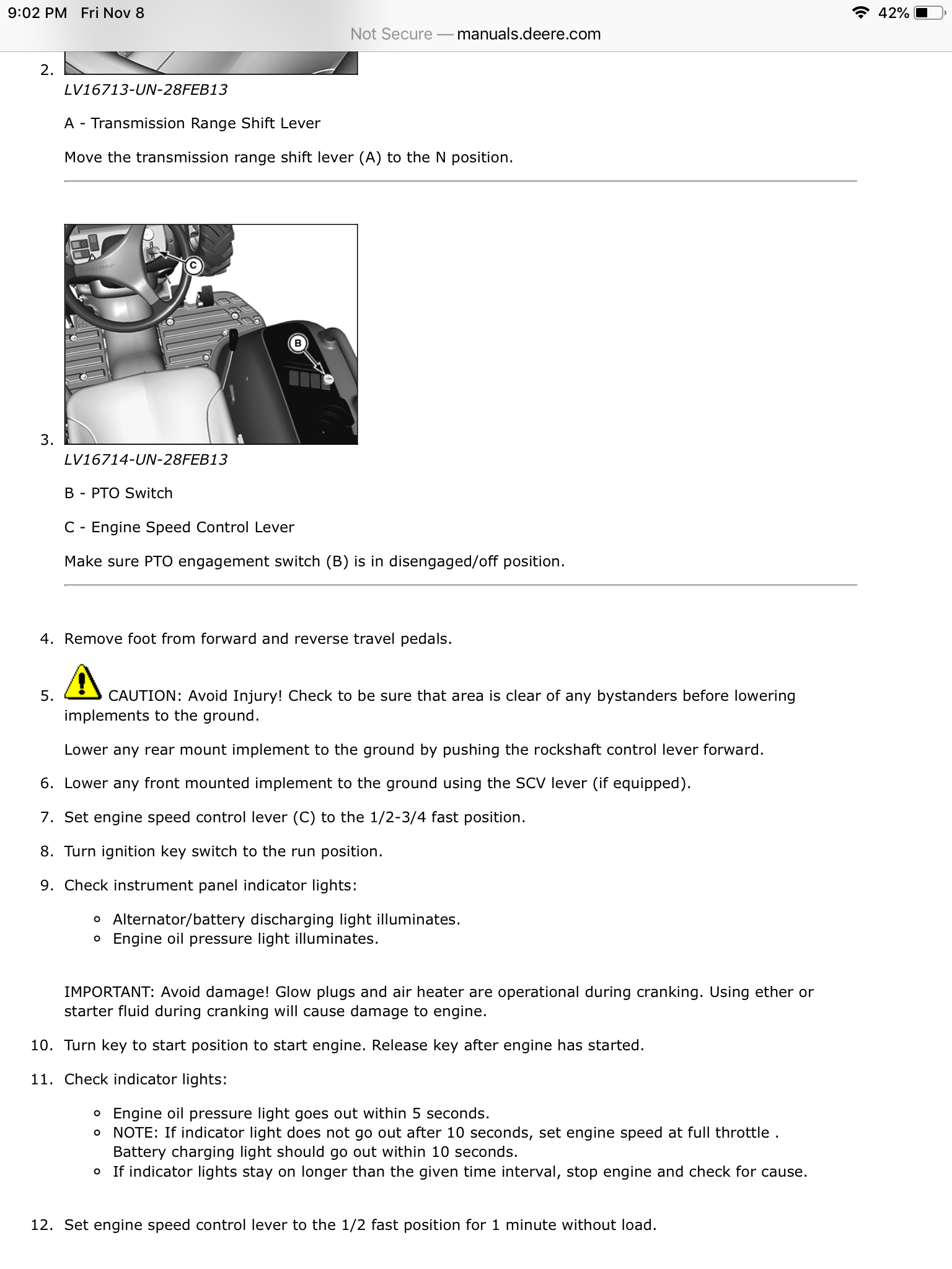

I do exactly as the Op Manual suggests. Throttle to half throttle, depress the clutch, turn the key to "on", wait for the glow plug light to go off, turn the key to start. 38 years - starts every time. Hot wx( 105F ) or cold ( -20F ) - - every time.
Length of glow plug being on is temperature dependent. Once the tractor starts - back the throttle down to 1000 rpm. Let it run until there is obvious movement of the temperature gauge - off I go to do work. I make dam good & sure the tractor has come up to full temperature before I do any work.

Yep, I agree...an hour or two is quite sufficient even on the coldest days. I plug mine in about an hour or so, even on below 0 F days (or nights) and I don't even need my intake heater (Deere's equivalent to glow plugs). Starts like Spring time...
Some folks wrote their tractors start with just glow plugs even in single digit weather...that's true...and so will my Deere. The block heater just makes it so much easier on the engine.
