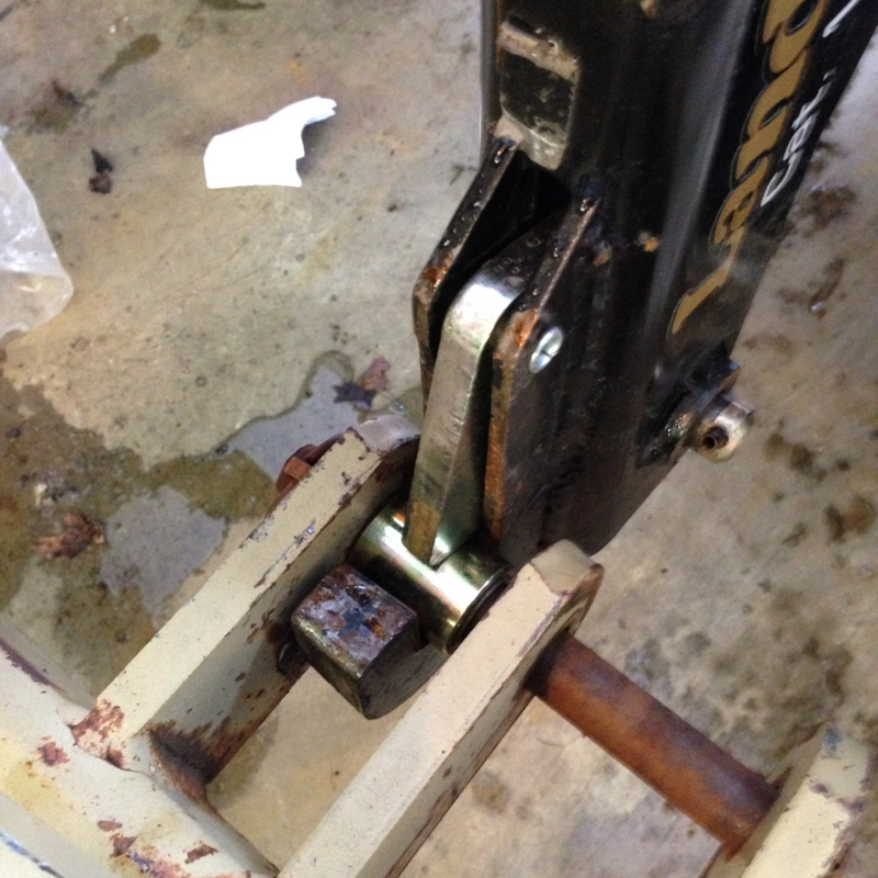

I used bushings as well for my Clevis style implements.
I didn't have any on my rear blade and had a REALLy lot of excess movement.
I put a cat 1-2 and the cat 2-3 bushing on (one inside the other) and this really tightened up the slop in the fit to the quick hitch.
