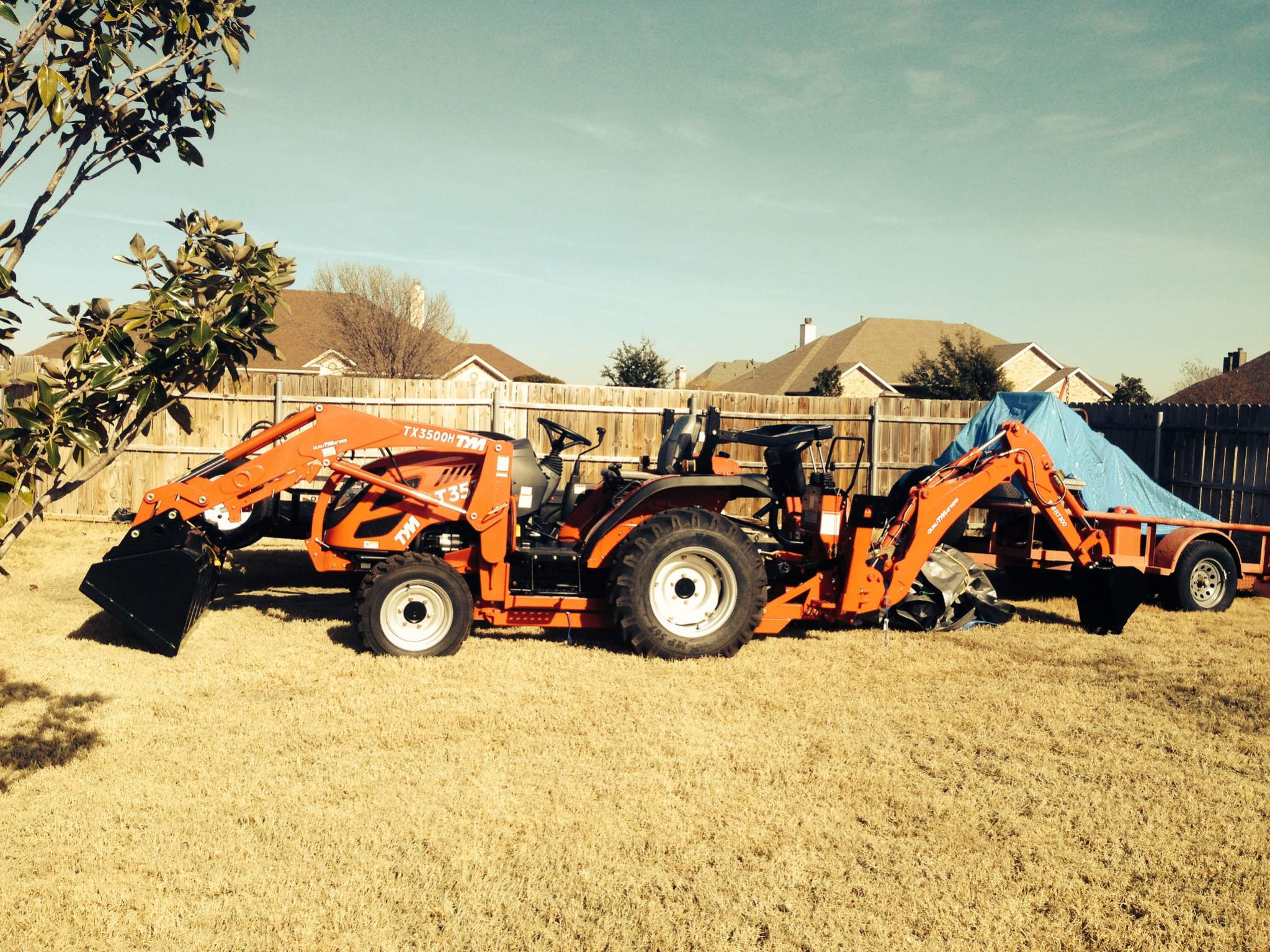

I have a TYM T353 HST with a TX3500 FEL and BT300 backhoe. I am in the process of clearing a couple of acres of land that was heavily wooded. We have a couple of hundred stumps to clear and we left about 3ft of trunk sticking up out of the ground on all of them.
Are there any good rules of thumb as to the size limit of pushing a stump and then pulling it out vs. digging out with a backhoe then pushing it over or pulling it out of the ground with a logging chain? The ground is sandy loam with very little clay content which should help.

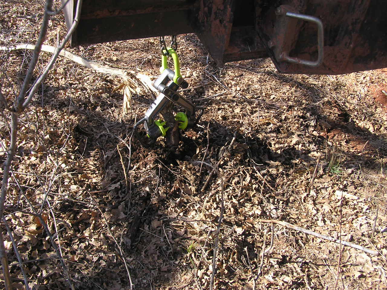

I have the next size bigger, a BG-20, it weighs 36 pounds, gives me a real workout!
They make a BG-30 that is 51 pounds, way too heavy for this old man! Brush Grubber from Northern Tool + Equipment

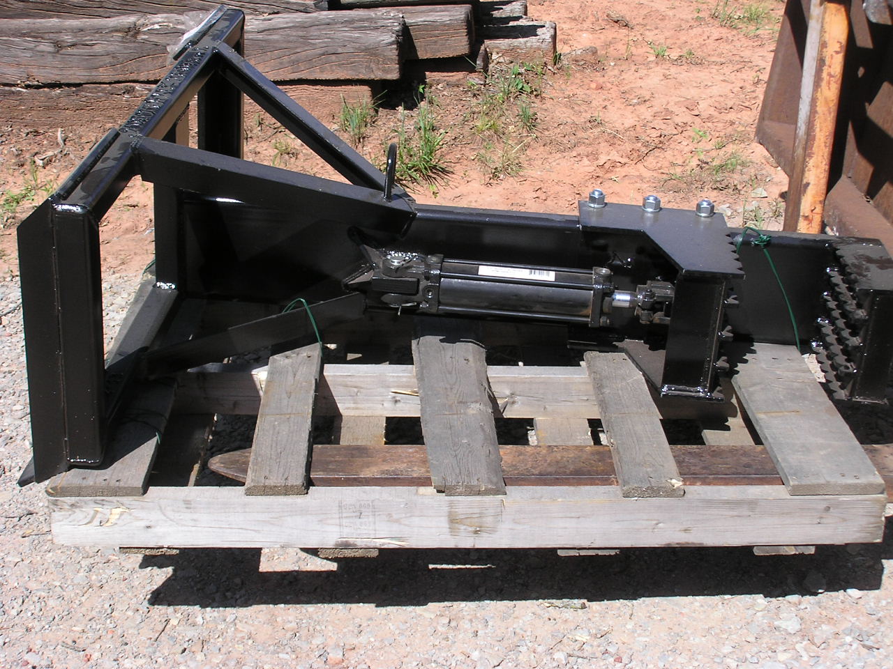

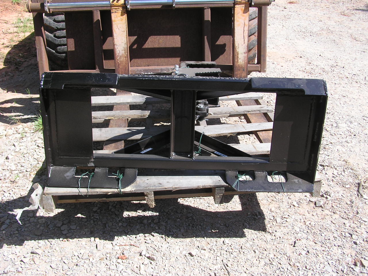

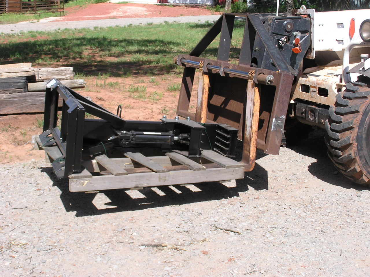

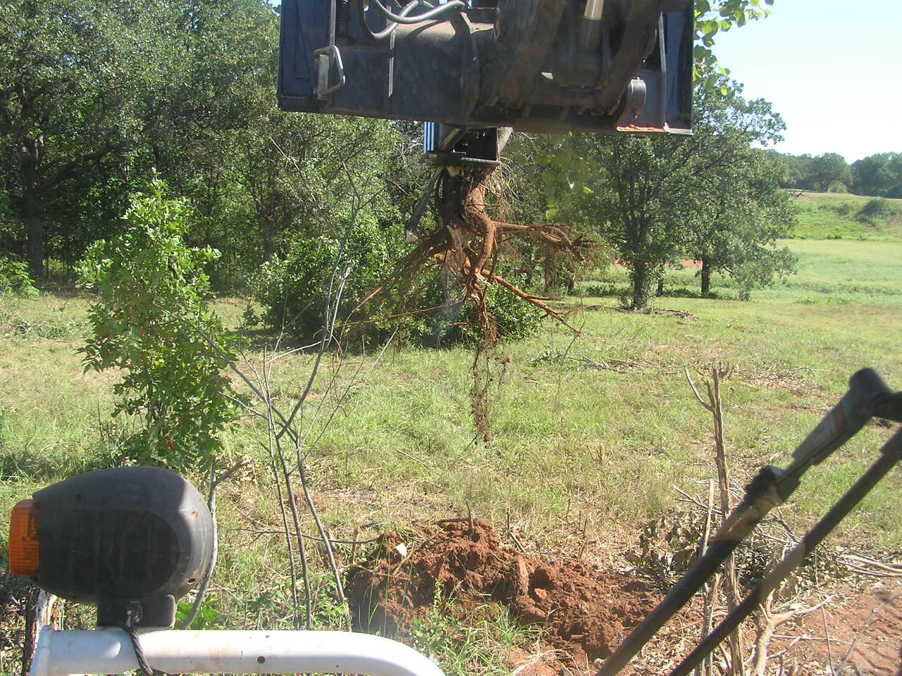

This is what I use now, much faster. :D
Buckthorn Puller - Custom built Skid Steer attachments to fit almost any need you may have.
And the biggest that it pulled: http://www.tractorbynet.com/forums/attachments/277824-tree-puller.html#post3444397

Now that has me envious. Next time I'm pulling with the Brush Grubber, I'll really be dreaming of that contraption.
/ Clearing Stumps #18
Yep, it is so much faster than the grubber. But I still use the grubber for pulling roots that break off when pushing over big trees.
It only took a few minutes to make this pile.
The view from the seat.
