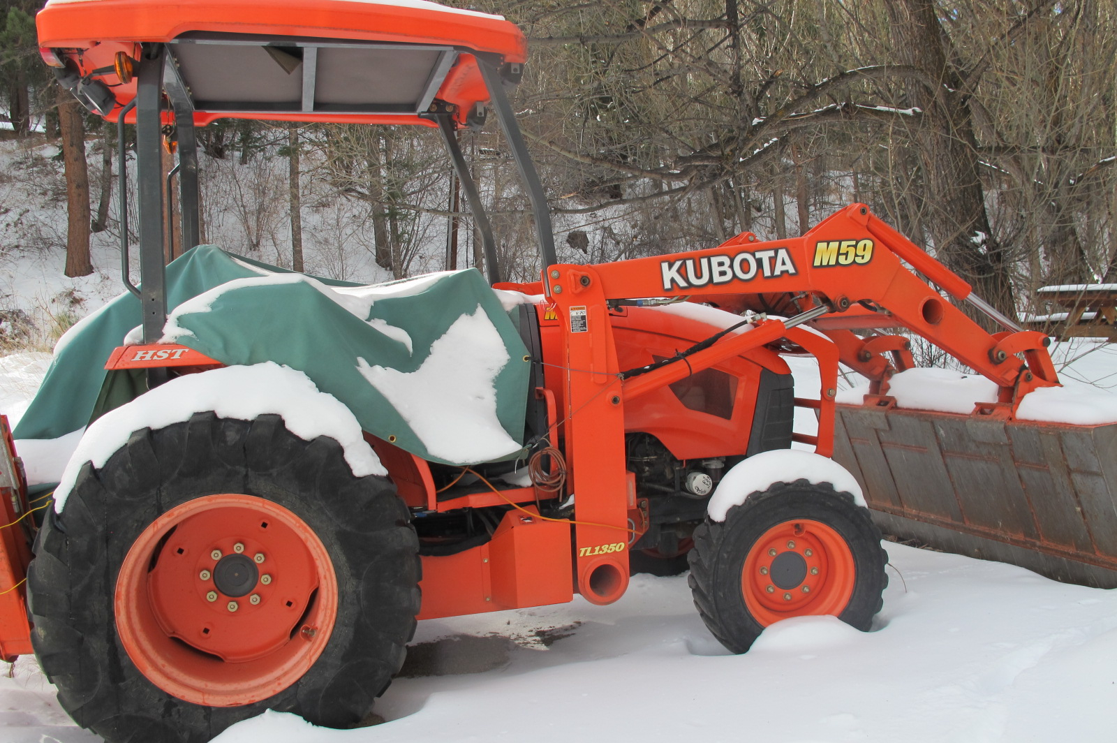

Our M59 looks to be the same size as your MX6000
We also have a canopy, live in cold and snow country, are kinda particular about the condition of our tractors, and we don't have inside storage. So we have tarped our tractors for many decades. This M59 since 2008. Summer and Winter both.
For your MX6000 with canopy - or similar size tractor .... Get this exact tarp below from TarpSupply.com:
You can order online. I've bought from them 3 or 4 times now - always different material and weight but this is far and away the best stuff. It's a poly&cotton blend. Tough, lightweight, waterproof but breathes, flexible in the cold. good stuff.
Price is decent, and this is the right material and weight:
July 3, 2021
7'x9' Green Polyester CTP0709FF 1 67.99
Canvas Tarp [EXACT SIZE Special)
Subtotal 67.99
Shipping 25.81
Total 93.80
ULTRASTRONG GREEN CANVAS TARPS
DURAMOST POLYESTER GREEN CANVAS TARP
This 7 foot wide by 9 foot long is the exact right size to cover your tractor and keep snow off the entire operator's area and dash.
You want to fasten the tarp well against snow and wind but it needs to happen quickly. That way you will actually use it. More on that below. You want to cover the entire operator's stattion, seat, steering, and especially the dash.
For fastening to the tractor I first make short wire loops out of single pieces of one foot long 12 gauge Romex that I twist onto areas the tractor. One loop on each FEL upright or better yet on the hoses, one loop under the right side fender to hold the middle of the tarp over the electrical controls, and a loop on each side back at the bottom of the rear canopy supports. Total of 5 is all you need.
To those loops I tie a cord that ends in a CanJam. Canjams with cord come in packs of two buy 3 packs to get 5 canjams.
(https://www.amazon.com/Nite-Ize-NCJ-25-2R3-Tightener-Mechanism/dp/B08582L8BF/ref=sr_1_3?crid=28LFOXXLO5UUP&keywords=camjam&qid=1641221578&sprefix=camjam,aps,127&sr=8-3
That size CanJam will clip perfectly into the grommets in the tarp. The CanJams and cord stay on the tractor, clipped back to the wire loop. Leaving them on the tractor is important because that way the tarp is easy to take on and off without getting hung up coming and going.
Good luck, I can send a photo if you need more info. But we've been tarping our tractors for 30 years now - and I admit to being a bit of perfectionist. This system looks and works well. The trick is to get the exact right tarp and clips. Just dumb luck that you and I have the same size tractor.
Good Luck, you can order this all online.
Oh, your hydraulics and FEL cylinders can stand the ice just fine. A 4 post canopy can handle the weight, If yours is he 2 post type cantilevered off of the ROPS, I'd put a prop in the front. A 2x4 propped through the steering wheel and resting on the cab floor and extending up to just touch the under part of the canopy should do it. Then you can leave the canopy up. It is much preferable to leave the canopy up.

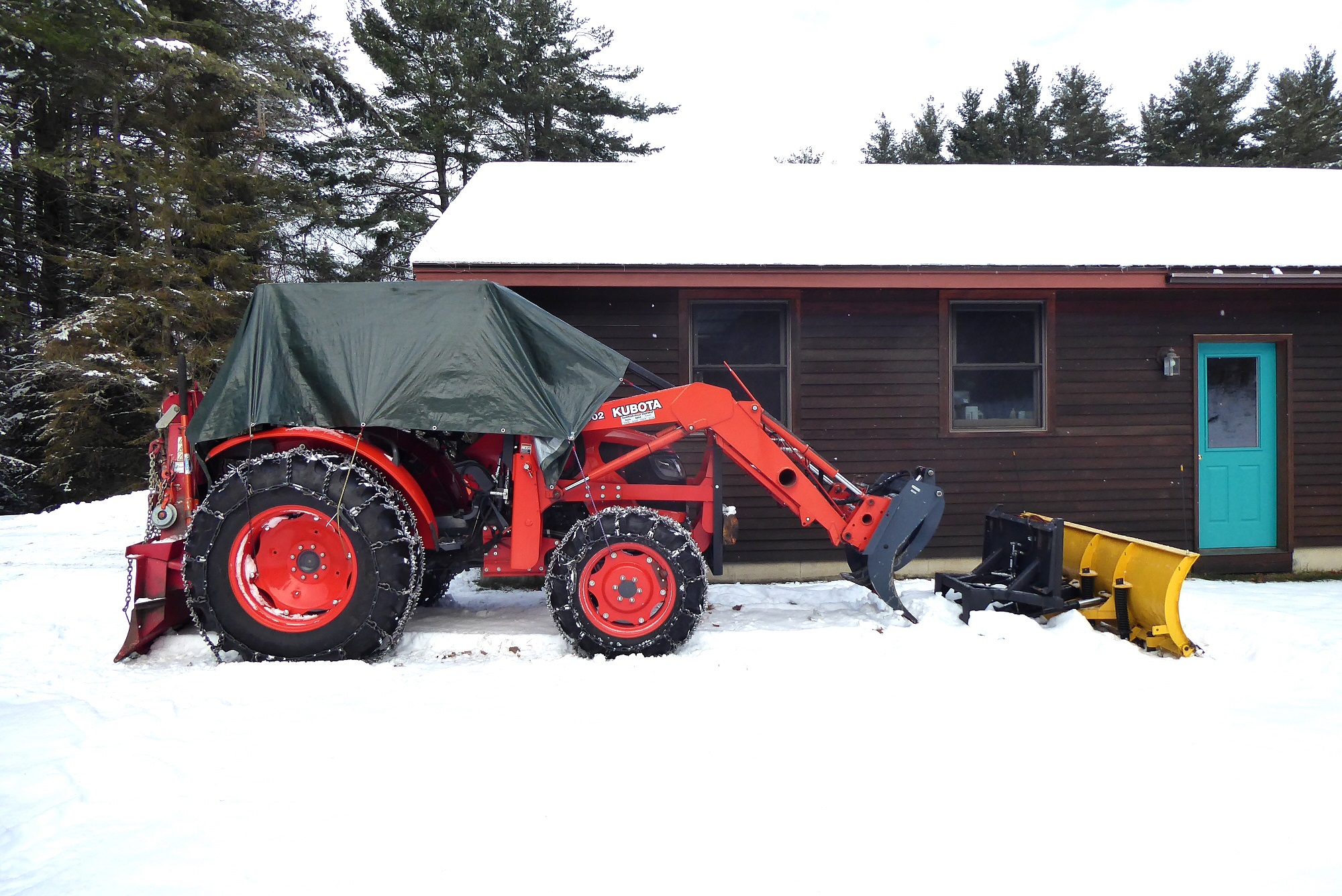

Several ways to go about;
a tarp over the canopy as was shown;
a tarp folded and pulled to the rear under the canopy and unfolded to cover the operators station;
Sweep it off with a broom before using;
Cover my tractor has some nice looking fitted soft cabs;
If you goggle soft cab over canopy tractor you will get a lot of results;
I bought a 4 place golf cart cover for my IH;
doesn't look like much in the first pic,
but in the 2nd and 3rd it was working good.
