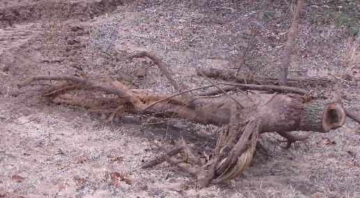

There is no need to monkey around with an aggravating brush grubber when a chain can be attached with the correct knot in less than 5 seconds. It will pull saplings from about an inch in diameter to however big your tractor is. This walnut stump was 6 inch diameter with a 7 ft. root system. It took all 70 horses of a 4x4 NH with loaded rears and wheel weights but the 1/4" grade 70 chain does the job.
If you need more information about how to pull several trees in one pull just ask. Since retirement all my advice and tricks I've learned over the years are free.:D
Dang! That is one impressive taproot. Given a few more years it would have made it to China. OK, gotta ask - what knot do you use with your chain to grab a stump, clove hitch? Any other advice or tricks?
To the OP - I have had really good luck grubbing up to 6" diameter hardwoods with a subsoiler. It takes a little fussing around, but it works when conditions are not the best for getting traction to do a straight pull with ropes or chain. Not the best choice if you can't get at the trunk from different directions, as the first step is to rip up the roots about 12-18" around the base. Second step is to get the point of the subsoiler under the rootball and simulatneously pull up and drive forward (slowly). The pulling up part helps the traction fot the pulling forward part. Disclaimer: anything with a taproot like SandburRanch shows would require a lot more weight and power than I have. Or The Good Reverend Blair's BIL.
http://www.tractorbynet.com/forums/land-clearing/190062-pulling-trees-saplings.html
This earlier thread shows how the clove hitch can be quickly tied and be used from one stump to another stump without having to re-tie. When the knot is removed from one stump, by retaining the two loop shape, it can simply be dropped over another stump.

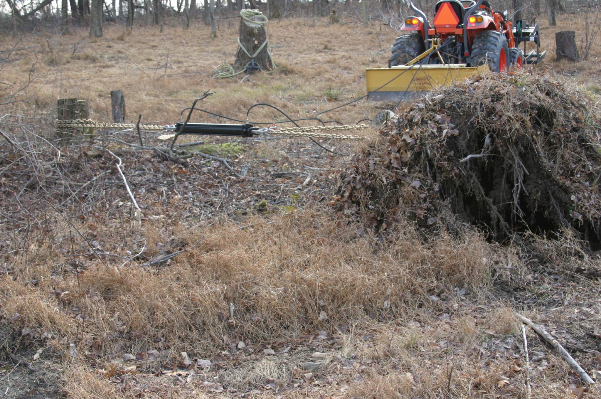

This is how I've been doing it lately. The cylinder pulls with 29,000 lbs. of force.
