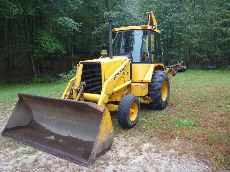

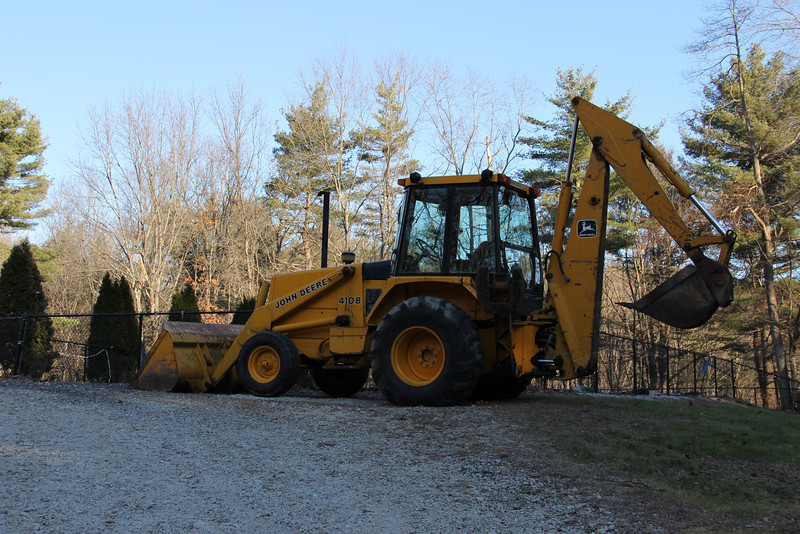

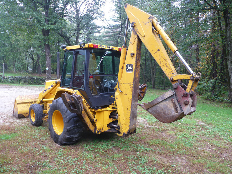

I may as well include a pic of the new backhoe I'll be using.

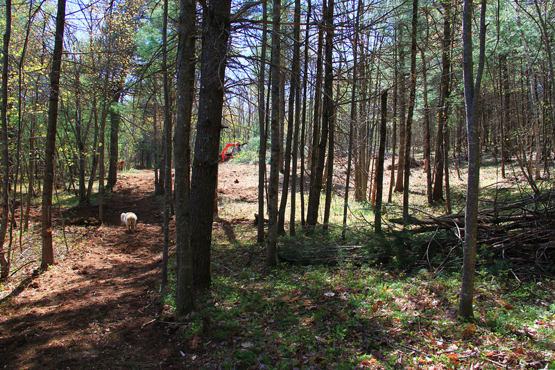

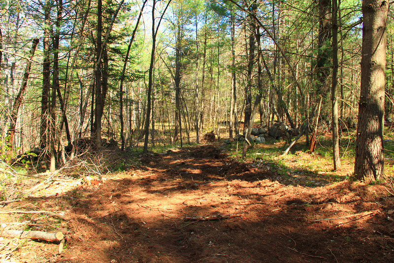

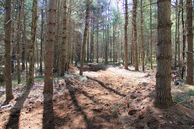

We first had to get the tractor back into where I wanted to start clearing, so of course we needed some sort of access. The woods are too thick to simply drive the tractor through. We started off making a small road to the area I wanted to clear first.
That is most of getting the "road" in. It tooks us a half day just to get back to where we wanted to start. We picked our way through the woods using the easiest path we could find. I didn't measure how long the trail was, but probably close to 600' or so. I wasn't able to get the backhoe up there yet but the little tractor did quite a fine job considering it was working alone.

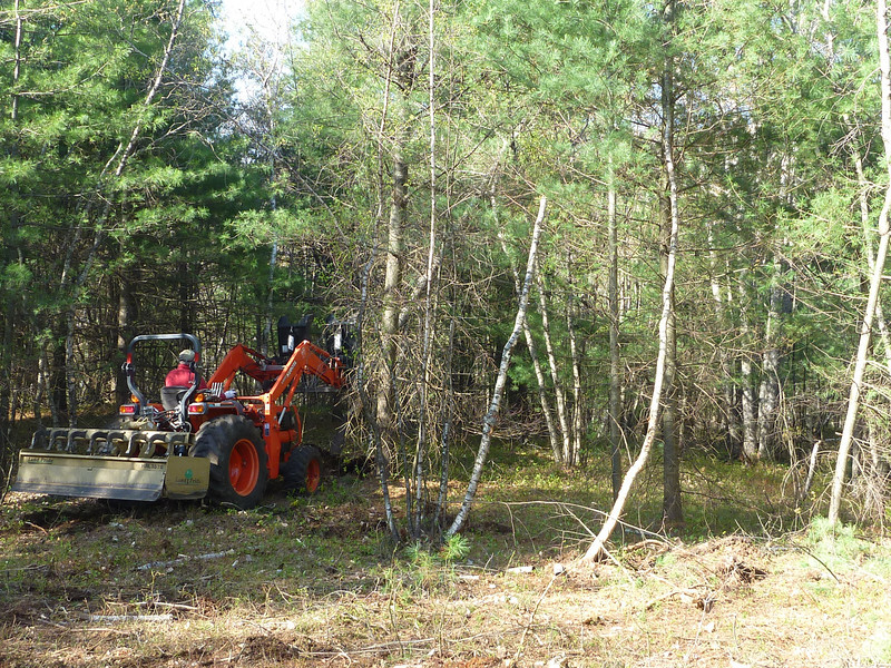

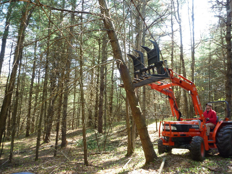

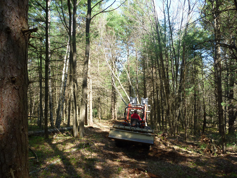

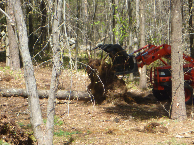

Here are some pics of the start of the clearing. All in all, my goal for this initial clearing, was to open up the land enough to get a good idea of where the best location to put a house will be. I figured I'd clear about an acre and thin out the rest, then go from there, not just clear cutting everything I see.
The woods were thick, most of it was smaller trees that were able to be pushed over with the tractor. We would push a number of trees over, then carry them to a pile. It took a while before we had enough land cleared to even make a pile.

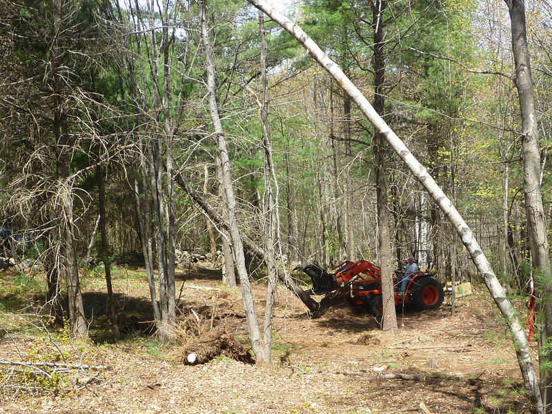

You can start to see the small trail we made, to get up to where we started the clearing. In the first pic below, you can see the tractor through the trees, and see the clearing starting to open up. I took the second pic just by turning to the right about 45 degrees or so with the camera.

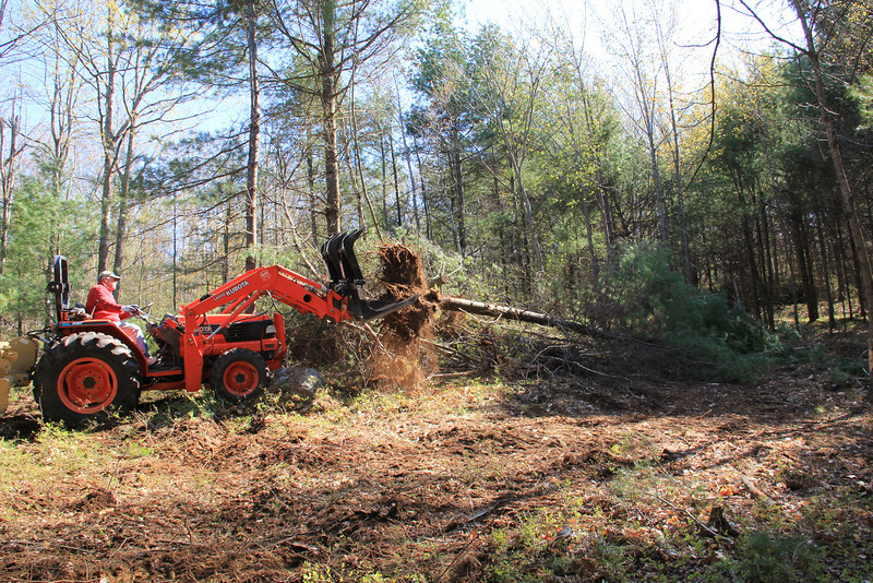

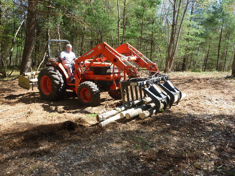

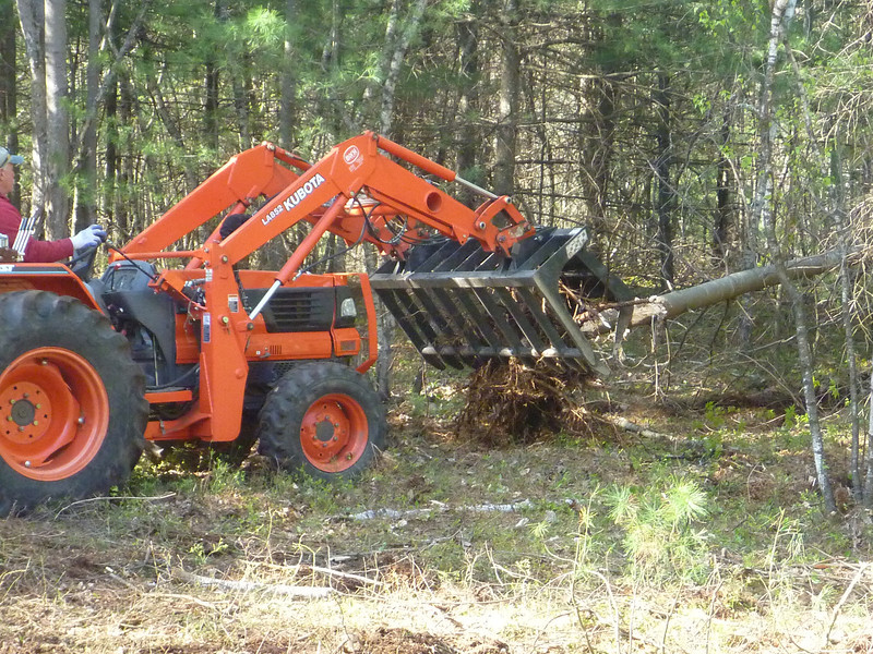

The grapple makes fast work of tree and brush material handling.
It was mostly all softwoods, but for the hardwoods, I cut them into sections and piled them to be processed into firewood later on.

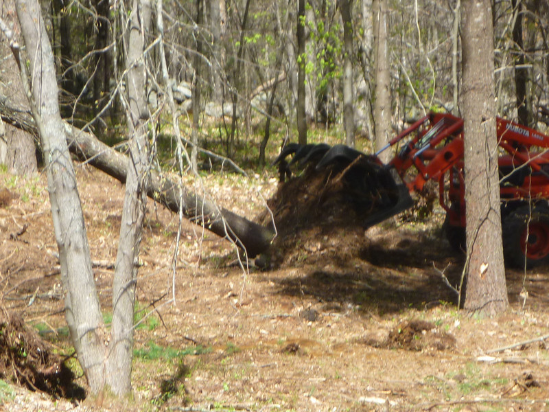

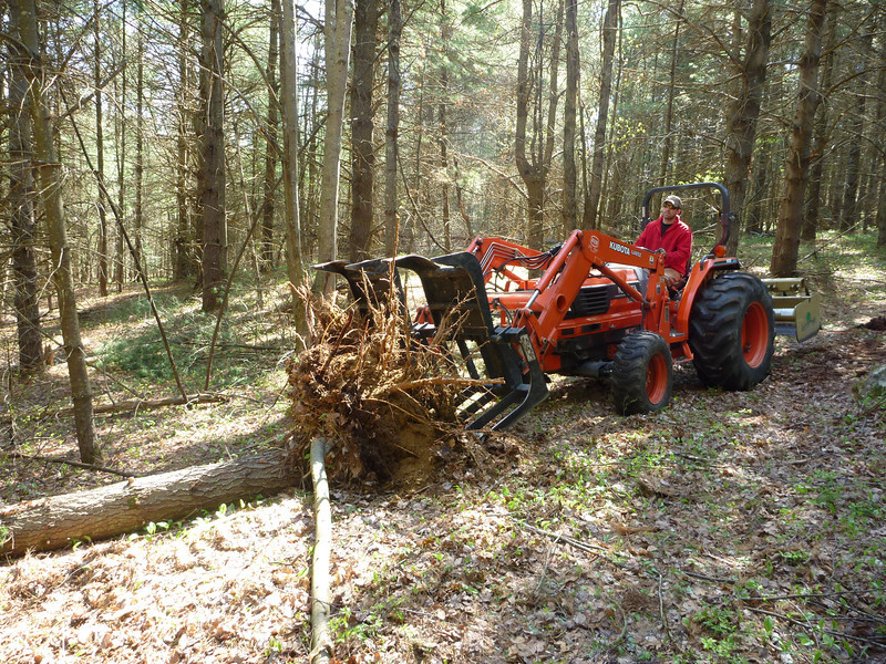

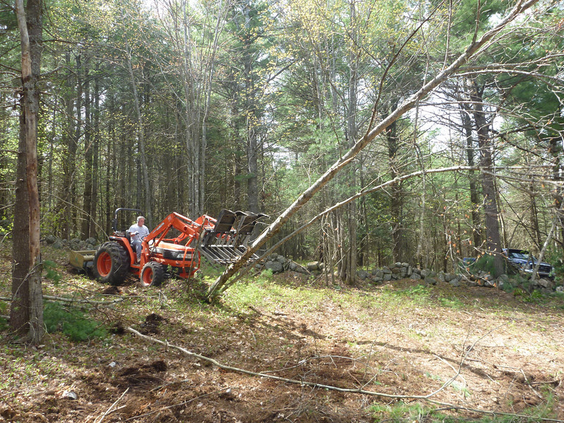

This is a pretty good series of photos showing how much of the work was done. We would knock the tree over with the grapple and once it was almost down, and only held up by the remaining roots, we'd back up, then insert the lower part of the grapple under the uprooted stump, and lift and drive forward at the same time. This would free the stump/tree from the ground, then cut it in half or thirds if need be, and take it away. :D

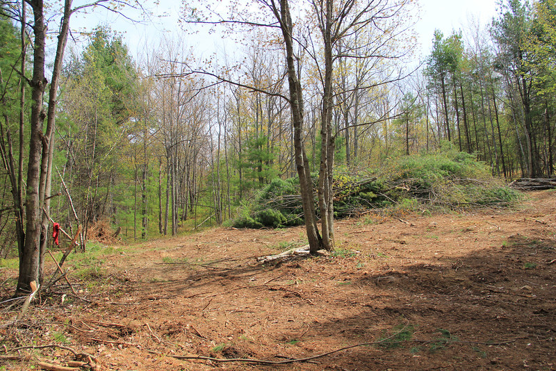

It's starting to open up a bit now. That pile is going to be fun to burn this winter.
