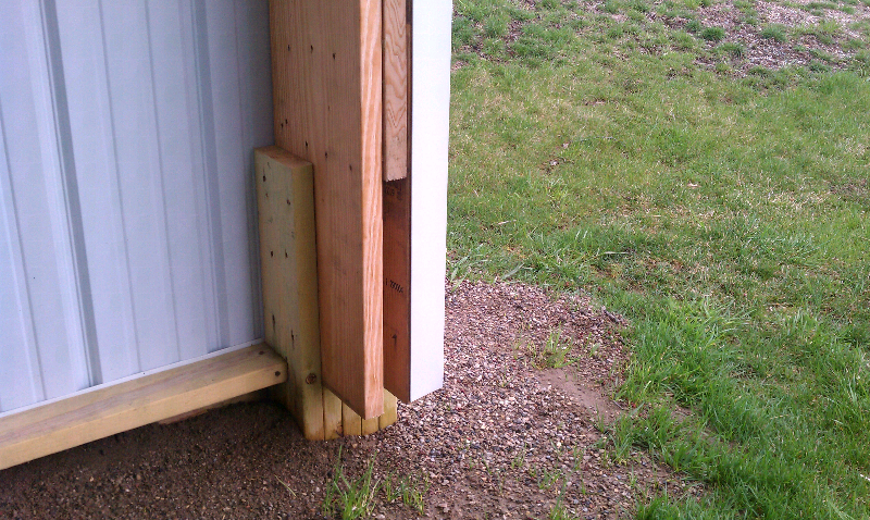

#9
I have a better idea about the barn now, attached is the photos from the barn I looked at today. The posts are buried just like a normal post frame only they are made out of multiple 2x treated boards. The trusses (I think that may be what they are called or rafters?) Are made out of bolted together 2x as well.

/ Clear-Span or Box Beam Barn #10
That price sounds in line with some typical pole barns that I have seen advertised. There is a 30x40x10 advertised for 8995 installed in todays paper.
What is the advantage that they are promoting over typical post construction? Is it strictly not having the bottom truss chords?

Besides not having a lower truss cord the price is the advantage. I want options such as ability to have or add a second floor for storage, which I can do with the 7/12 pitch and a loft. Also I want 12" eaves all the way around and a shingle roof. I've called on the news paper adds locally priced like that and after all the options I'm close to 12 grand without the flatwork. This type barn fits my budget with all the options I want. I was concerned about how sturdy the barn is, but after talking with the gentleman today who has one built, I am sold. I will post my progress so anyone interested can check out this type of barn.
If you think you want to add a loft, you're going to have to add posts in the middle of the structure to hold it up. If that's true, you might think of a traditional pole building with rafters instead of trusses. That keeps the upper area clear for later loft, and also has all the structural elements in place to support the floor of the loft. I think you'll end up paying more to add the loft to the design you're looking at than you would to a pole building with a steeper pitch.
