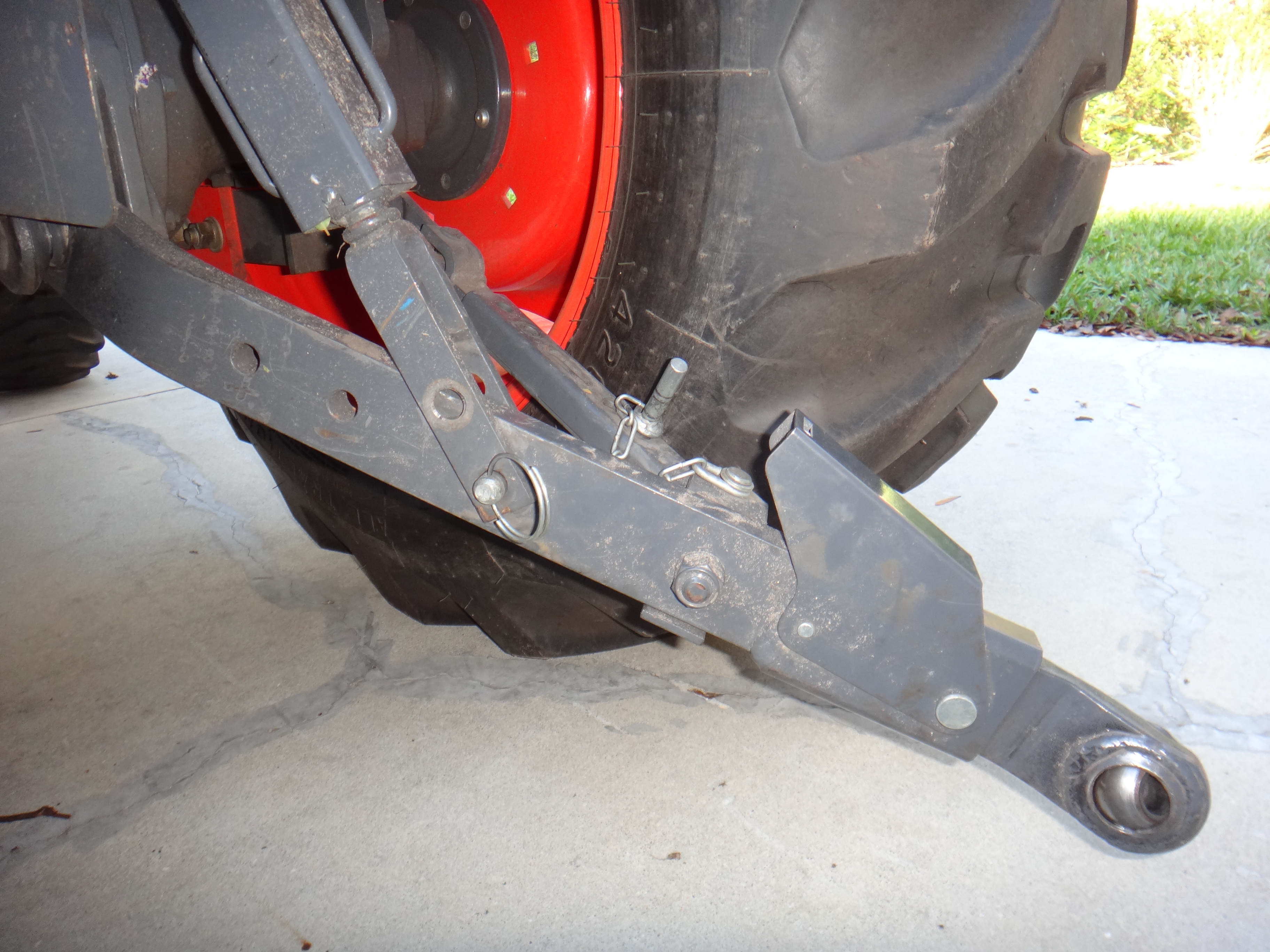

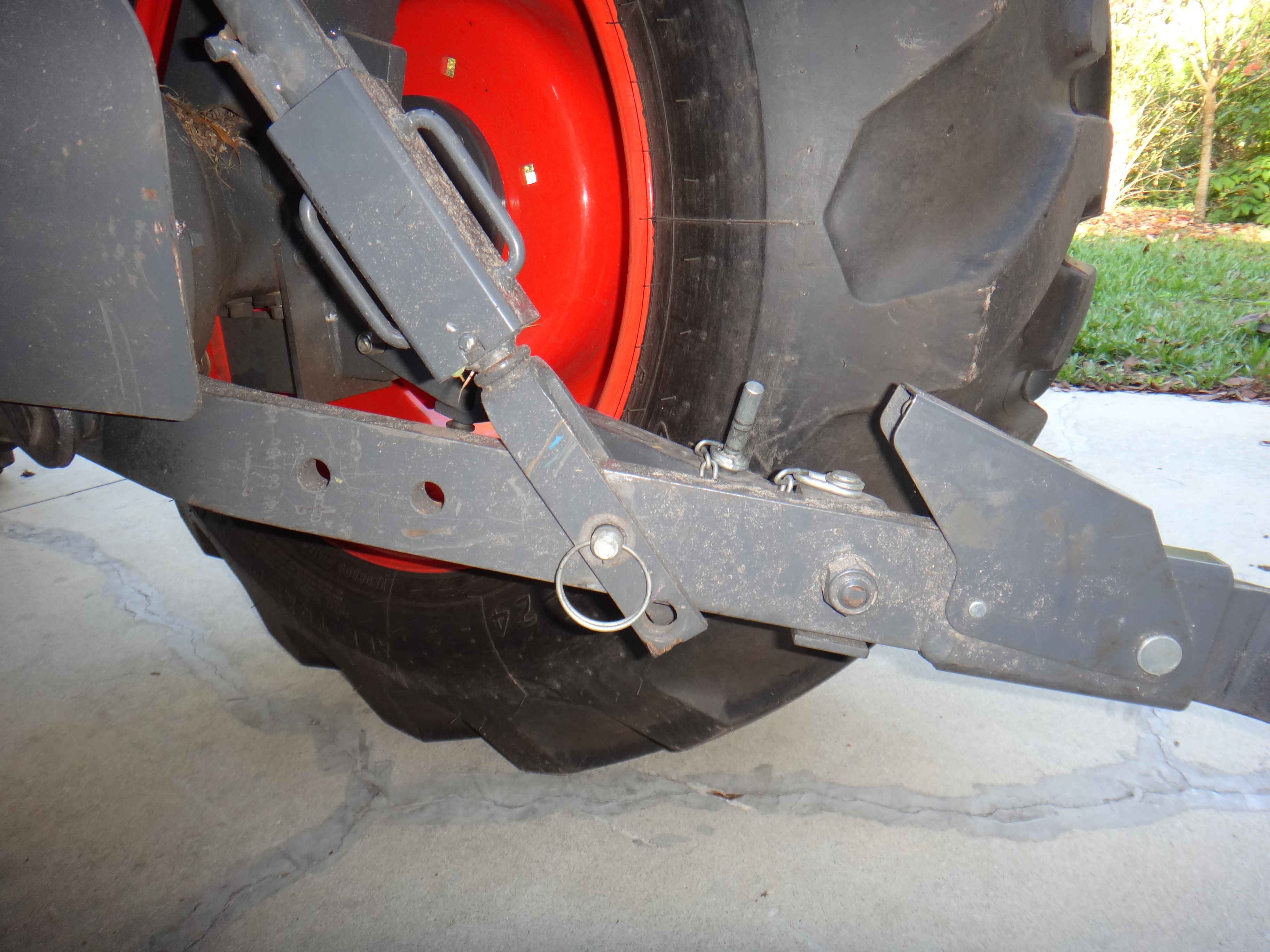

If you want deeper soil penetration with Middlebuster or Subsoiler move pin to bottom holes on Lifting Rod stirrups. See photos.
