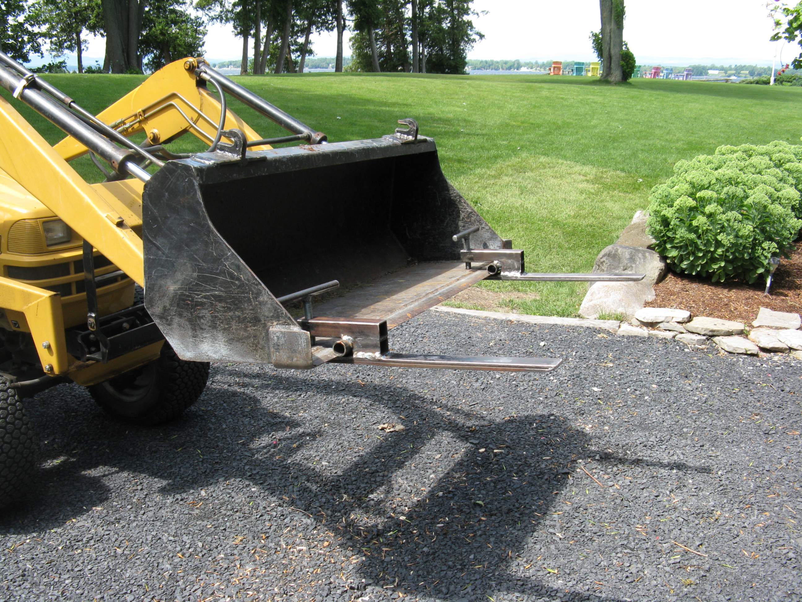

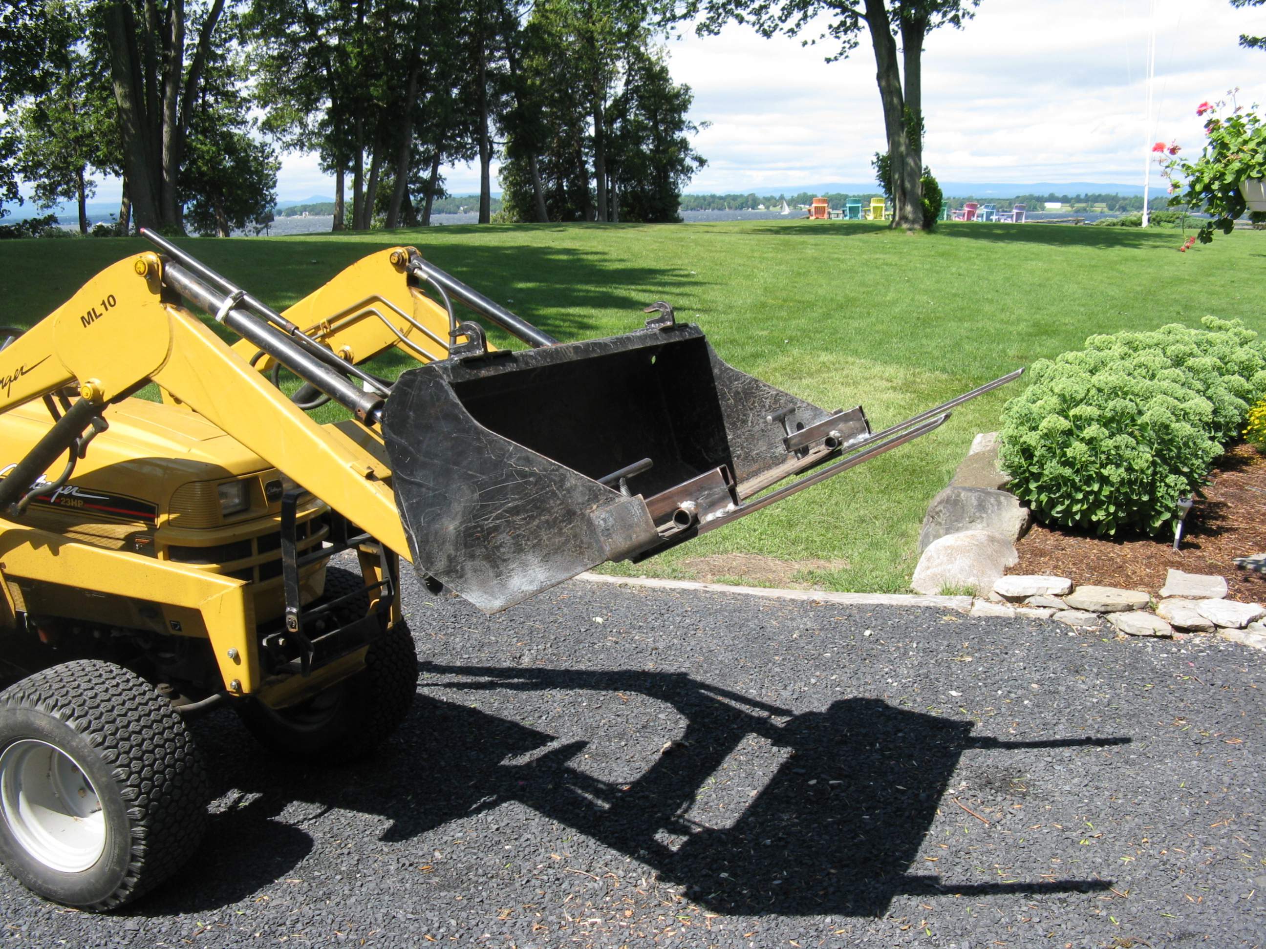

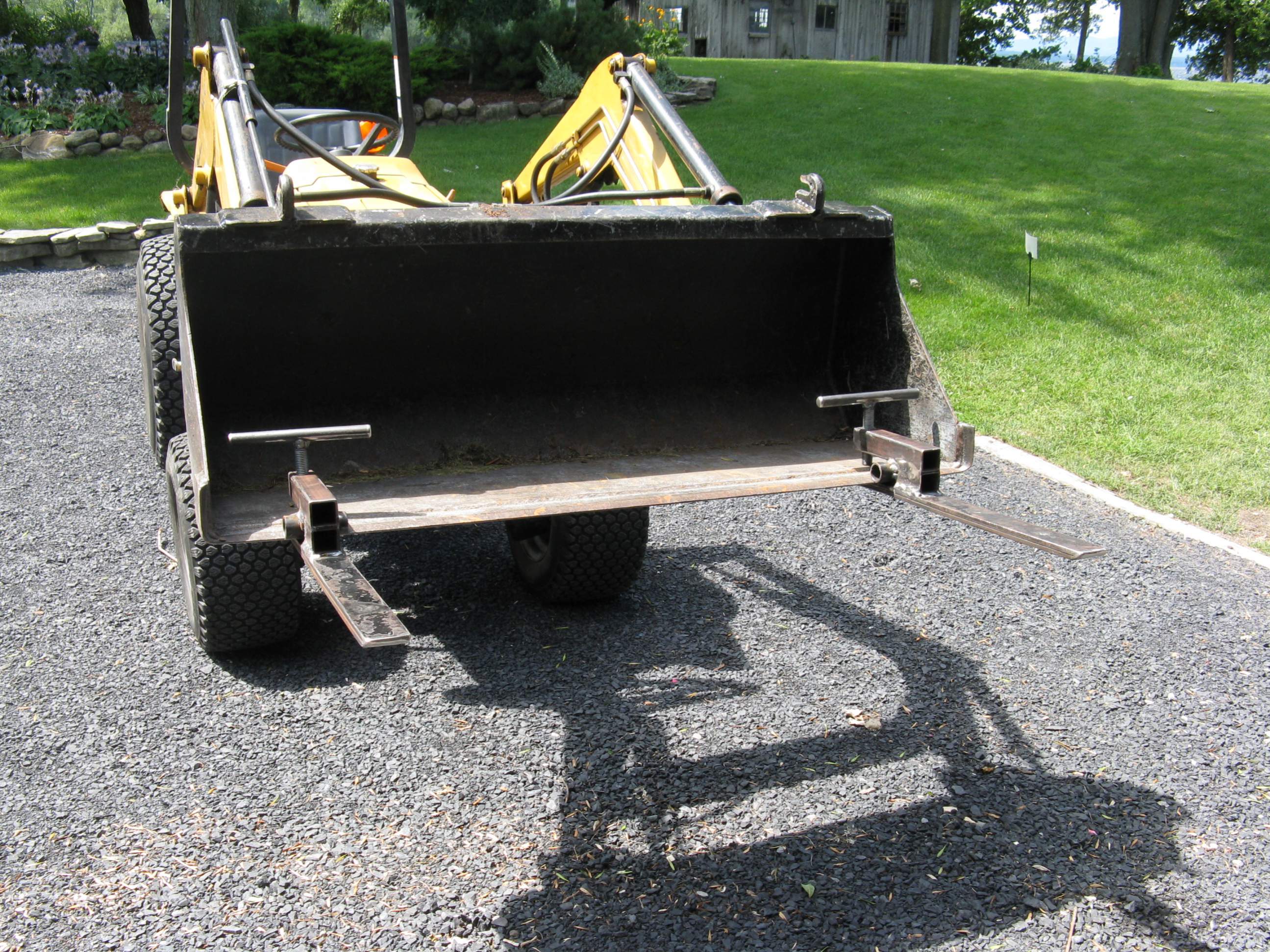

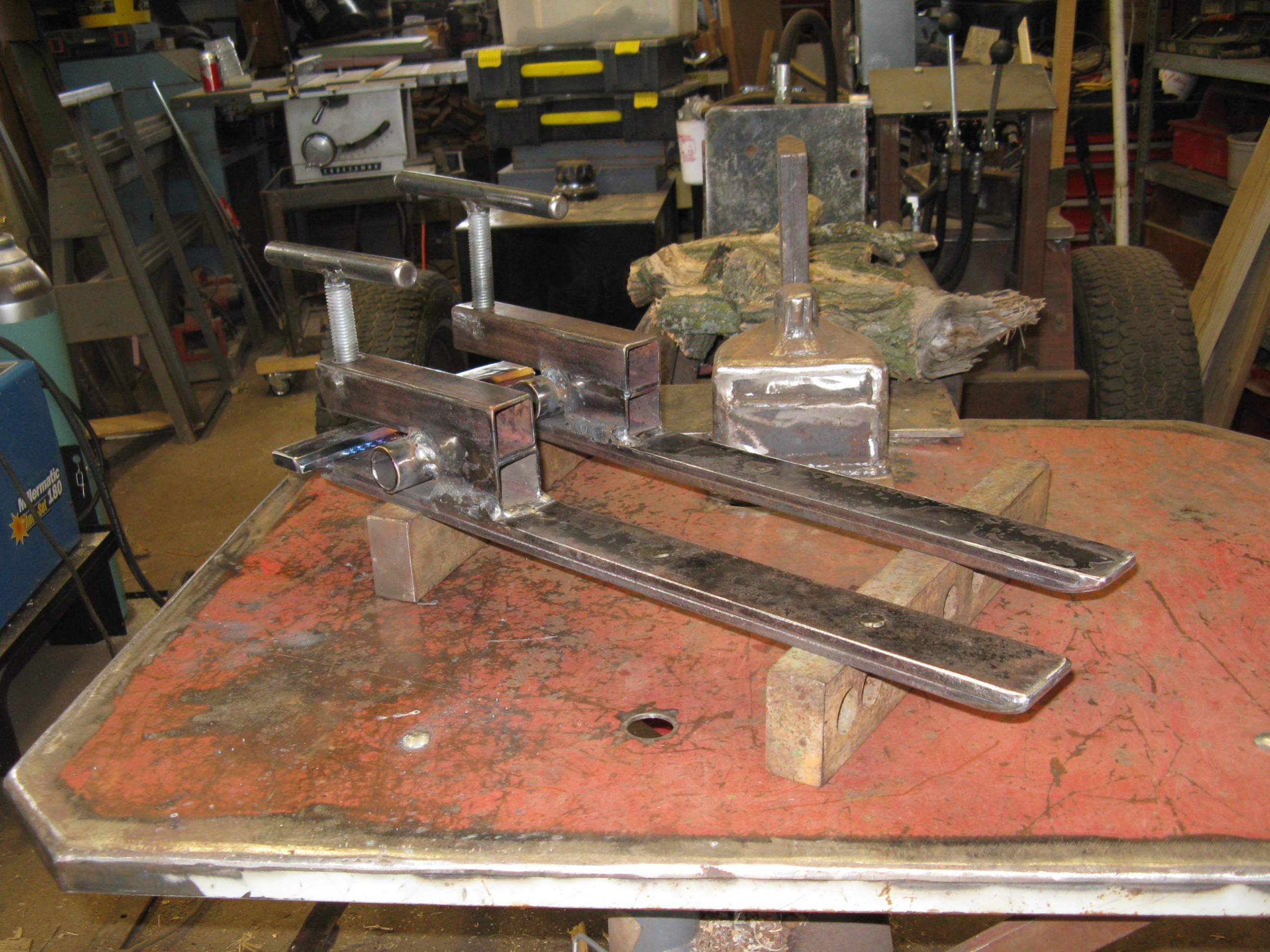

Dec 24, 2013 / Clamp on bucket forks #1 ajmaxham Bronze Member Joined Feb 17, 2012 Messages 76 Location South Hero, VT Tractor Cub Cadet 582 A set of small bucket forks I built for a friend.

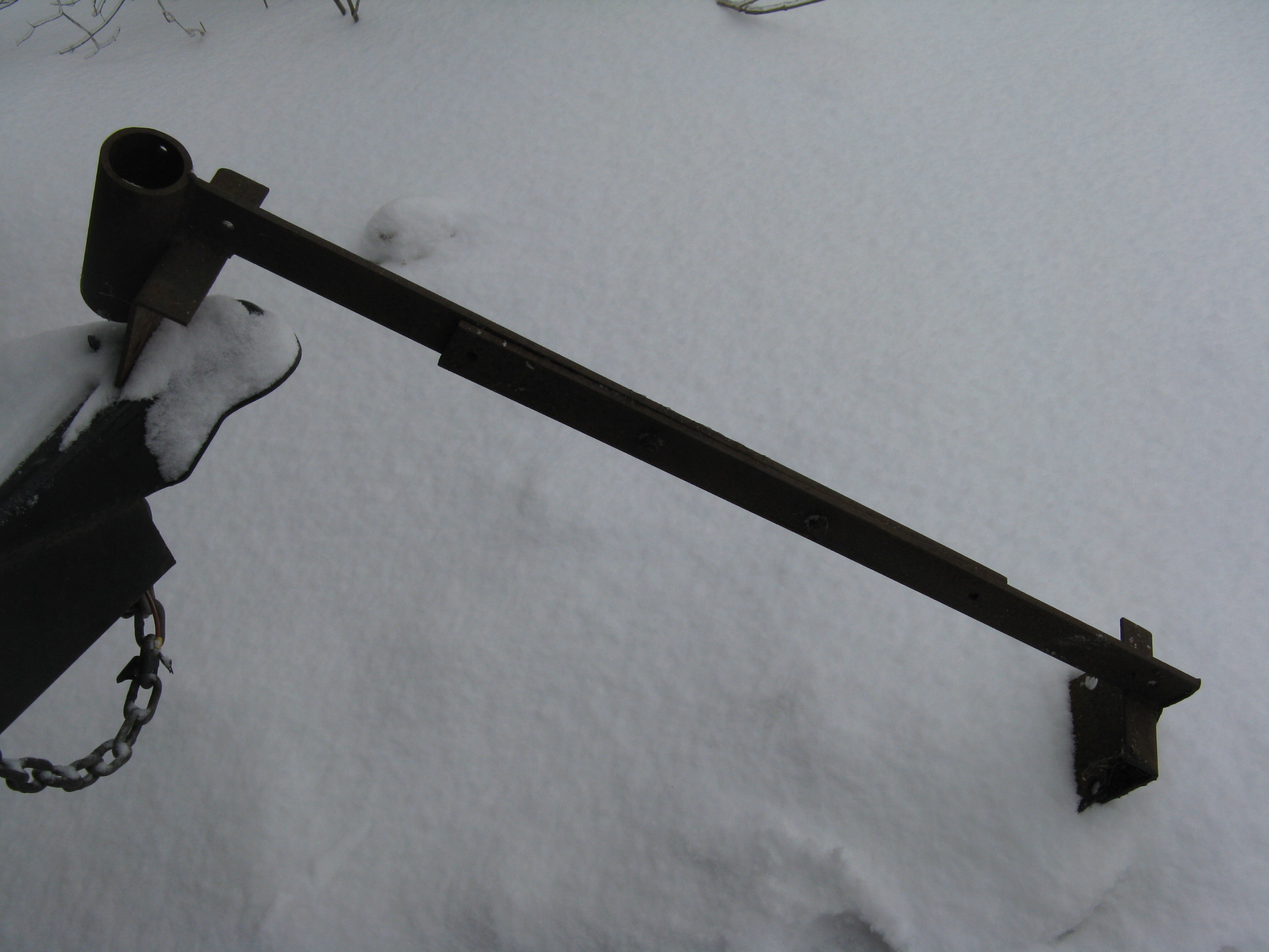

Dec 25, 2013 / Clamp on bucket forks #5 Xfaxman Super Star Member Joined Feb 8, 2013 Messages 13,323 Location Guthrie, OK Tractor Toolcat 5610 G - Bobcat V417 - TORO+Loader Gooder-uns :thumbsup: What where the forks? Can't figure out the groove on the side.
Dec 25, 2013 / Clamp on bucket forks #6 k0ua Epic Contributor Joined Jun 28, 2009 Messages 30,638 Location Branson, Mo. Tractor Kioti DK35se Hydrostat Xfaxman said: Gooder-uns :thumbsup: What where the forks? Can't figure out the groove on the side. Click to expand... I am betting that is where he welded up 1/2 inch bar stock stacked on top of each other. See the plug welds on top?
Dec 25, 2013 / Clamp on bucket forks #7 Xfaxman Super Star Member Joined Feb 8, 2013 Messages 13,323 Location Guthrie, OK Tractor Toolcat 5610 G - Bobcat V417 - TORO+Loader k0ua said: I am betting that is where he welded up 1/2 inch bar stock stacked on top of each other. See the plug welds on top? Click to expand... Yep, I do now!
Jan 3, 2014 / Clamp on bucket forks Thread Starter #8 OP ajmaxham Bronze Member Joined Feb 17, 2012 Messages 76 Location South Hero, VT Tractor Cub Cadet 582 The metal in the forks started life as dock hardware. It is 5/16'' by 2'' flat bar with holes every 8'' that I stacked on each other. Off set the holes so I could plug weld every 4'' and weld at both ends. So far they have worked very well.
