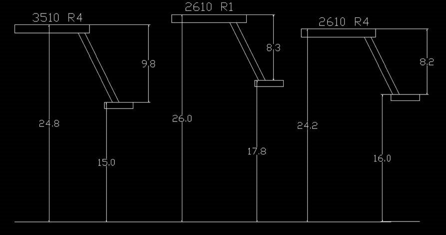

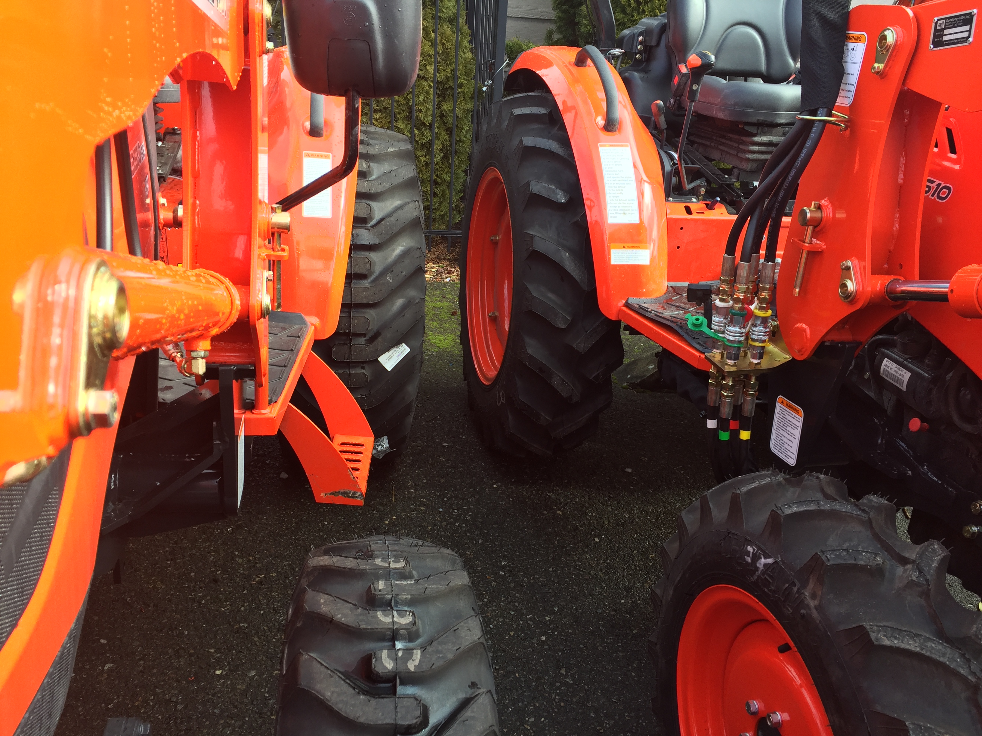

I went and saw my new tractor yesterday, now waiting for the options to be installed. Being new to specifying tractor tires and the associated impacts, I was surprised at how much higher the first step was now that I'd asked for R1's. So I started reconsidering my decision, and the dealer said it was fine if I wanted to change to R4's. As I stated in other threads, I'm buying this tractor to take me into geezerdom and my last tractor purchased, so I'm getting all the bells and whistles.
My knees continue to go south, so the step height is more important to me than most, and will assuredly get worse. So I started measuring the impact of R1's to the step height and operator's deck, and those numbers are in the diagram attached. I found that the 3510SE model (on left in photo with R4's and right is 2610 with R1's) uses a different step than the 2610 base model, and the 3510 step is a better fit for me, given it drops down further from the operators deck. Dealer says a $100 to get the 3510 version installed on mine.
I've reviewed the countless threads on chains and I'm buying them regardless of tire choice. I have a shared asphalt driveway, and looking at tirechains.com resources, it appears the best choice is 2 link ladder, or rubber style, if I want to keep the neighbor from complaining (and they will, without a doubt) if it get's marked up.
I infer chain fit is a function of tire type, chain type, and is tractor model specific. I saw comments of fit on R1 tires with chains for the 3510, and 3510 with R4's but chain type not stated.
Question: I measured the tire clearance on the 2610 with R4, unfilled, air pressure unknown at 1 5/8" clearance (R1's were 2 1/2") to the fender on the side. Is that adequate to run ladder type chains? I did not see a 'rule of thumb' for clearance stated anywhere.
Thanks, Toukow

To me the 1 5/8" clearance is completely inadequate the 2 1/2" would be the minimal acceptable for chain clearances.
The main reason for chains to mark up a driveway are spinning the tires.
In my experience you will definitely NOT want the duo-grip chains especially on pavement,
every time that grip point hits the ground will be the same as hitting a pot hole.

My CK2610 has 1 3/4" clearance with turf tires to the fender supports.

I stayed with the R1's and ordered the CK3510SE step, which gets me back close to R4 step height per the drawing I posted. I figured by the time I made it and painted/powder coated it, it was worth the $100, and I'll have a spare step if it ever gets damaged. Still waiting for a quote on the 2 link chains from the dealer.
/ CK2610HST R4 chain clearance
#9
Update: My dealer said the 3510SE step would not work on the 2610 model. I'll make something new or modify the existing and have it powder coated.

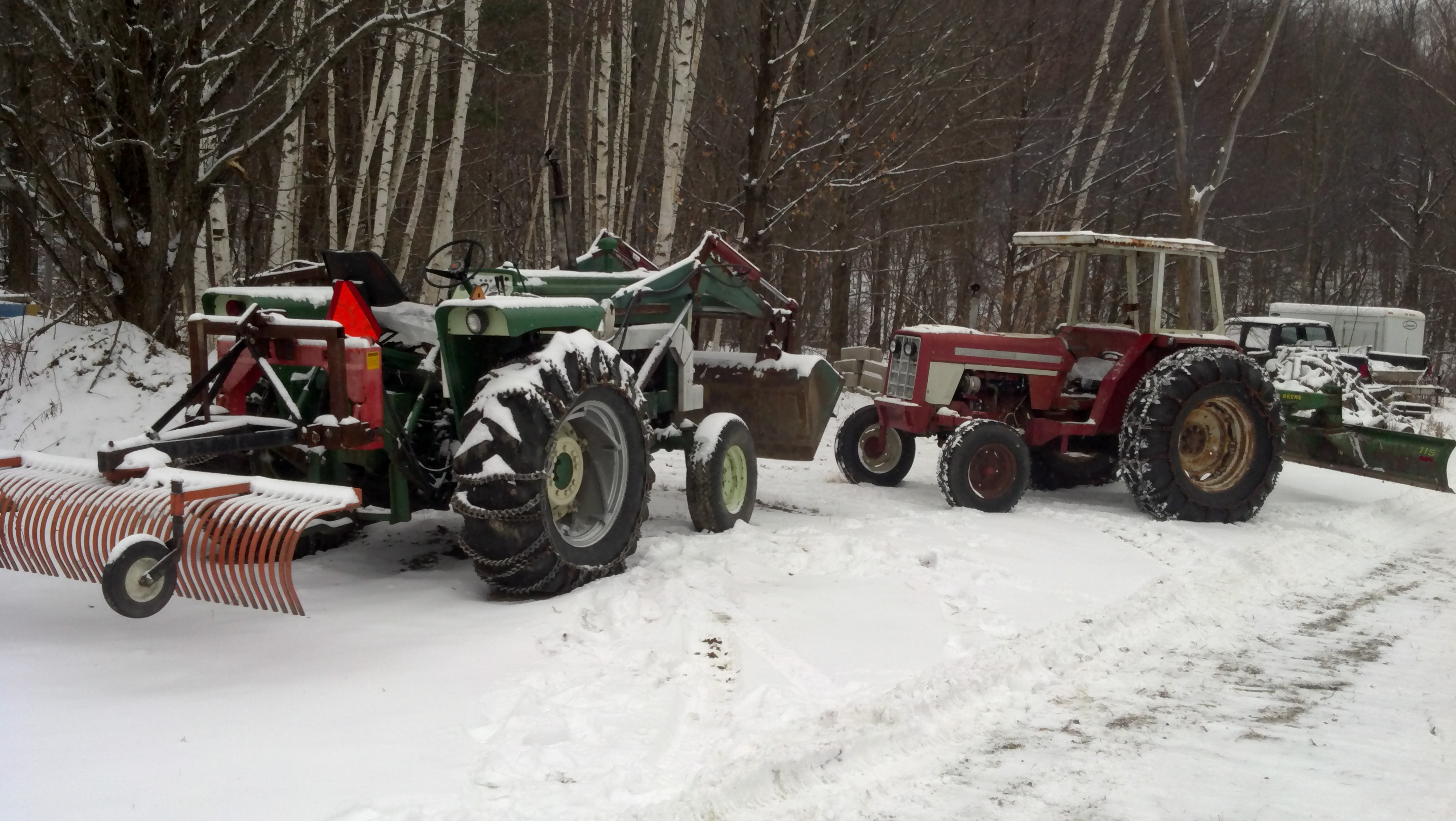

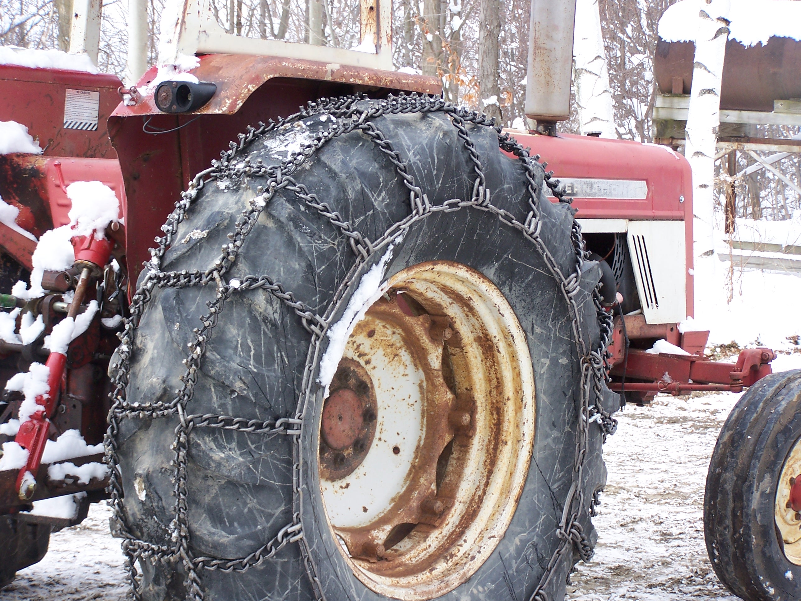

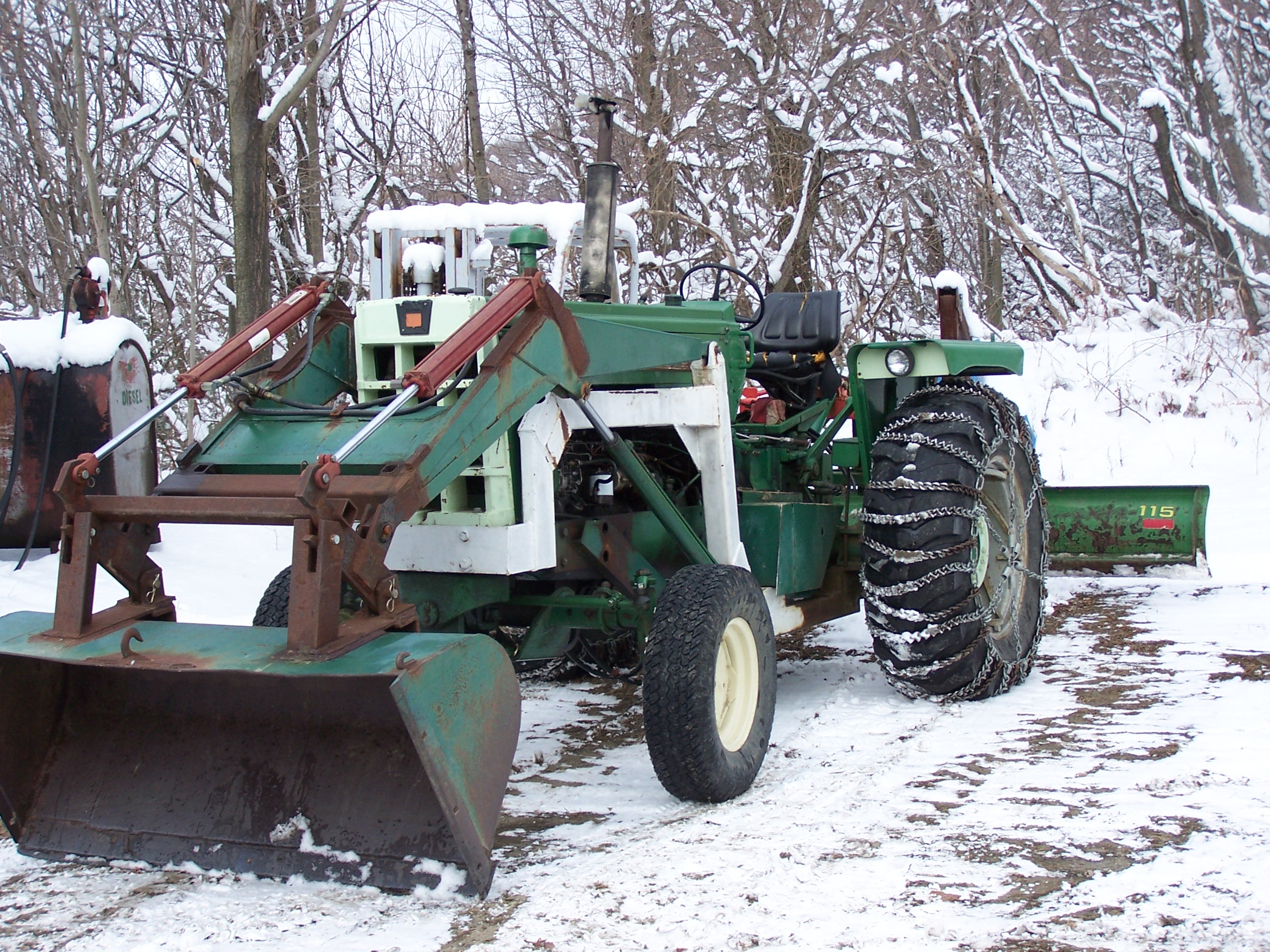

when I read this and it sounds like you are considering the 2 link spaced chains,
I'd like you to reconsider this style. Yes they are more money, but it is money well spent.
Tire Chains-11.2 24
I have had many styles over the years and the difference between 4 link spaced and 2 link spaced is considerable the next step up to the Euro style is so much better it is almost unbelievable, it is a multitude of improvement.
The Oliver is on 2 link spaced chains, the IH 574 is on Euro's the 574 is more then 2000 pounds lighter then the Oliver but on ice or hard packed snow it would out pull and more importantly stop much better even on glare ice on a hill.
My :2cents: Lou

I had seen some of your photos while researching this, and was impressed with how aggressive those chains are. Forgive my ignorance of tractor brands/colors, but which photo is the 'Euro Style Reinforced Net'? Because I do not see the diamond pattern shown at the link for the Euros.
The reference table at the link you've provided does show the 'Euros' as being 'very good' on asphalt, and I've overlooked them. The 2 link rate 'Excellent' for not damaging the asphalt, but I'll reconsider the Euros as the more traction the better. And it's not like they would be used every year as elsewhere in the country, therefore reducing the possibility of damage. Thanks Lou, Toukow
/ CK2610HST R4 chain clearance #13
Morning,
In my third pic is an IH 574 it is running a set of AquilineTalon chains.
In the forth pic is a Branson 8050, the rears are OFA brand Eko 9 series, the fronts are another
style of the OFA's called the Tapio 9.
The Aquiline Talon series, the TRYGG brand and the various OFA styles are very good chains.
A search for studded tractor tire chains will bring up several vendors and sights.
As far as the Euro designation it is just called that as the diamond or rectangle pattern that sits on the top center of the tire seems to have originated in Northern Europe.
The forestry type of chain also has the diamond or rectangular pattern often with a large ring at the centers they provide extreme traction in deeper snow and ice.
Good luck, Lou
