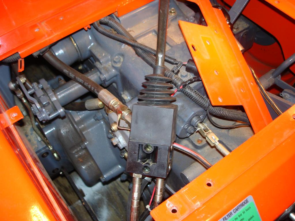

I have a CK30 HST 2005, and I find I cannot get the KL130 FEL Lever to go into the FLOAT postion. Other wise it works perfect.
Has anyone else been having this problem ?

Mr. Fox,
Will it float if you hold it or will it just not go into float?
If it will not go into float it may be the ball bearings are frozen or gummed up really bad. Look at the diagram Wallace posted in this thread:
http://www.tractorbynet.com/forums/kioti-owning-operating/149948-ck30-front-end-loader-joystick.html
http://www.tractorbynet.com/forums/...ont-end-loader-joystick-ck30-loader-valve.jpg
There is a ridge on the North end of part 36 which goes into a spring loaded ball bearing setup in part 31 similar to an air hose connection. They often need grease. In my case my float stuck so bad I actually broke a few cables. Grease was not enough, I needed to smooth/reduce the ridge on part 36 to get satisfactory float disengagement.

TIM:
NO I cannot get it too go into Float at all, seems as though it is hard up against something and just won't go . Wouldn't want too force it.

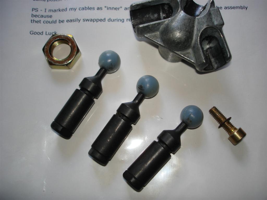

Took the FEL Joystick lever apart and found that only 2 of the plungers with the balls on them move up and down. Does the thrid plunger not move at all ? Or is it frozen in place ??
I think it is frozen . Now to get it out. Any suggestions anyone ?
UPDATE After reading 1 Wheeler1 note and then I realized what he was saying. The Pivot is not a moval part. What do women say about read the directions first ??
I think my troubles are down on the main block ....I guess that is were I'm heading next. Because I could not find too much wrong on the lever end, I just greased it and put it back together

Tim : You were saying there should be a ball bearing in the end of part number 31( cap )
I took mine off and there is NO ball bearing in there I washed it out and cleaned it up but no ball. Looks like a grove on the end of part number 36 for some sort of a ball bearing.
If there should be one I wonder what size it would be ? Does not show it on the diagram.
The Fox
   / CK25 Loader control and "new" cenimatic kit #27
Think air hose connector (36 male, 31 female). There are multiple ball bearings in part 31 and you can't see any of them. I would clean and regrease before I started taking material off of part 36.

Tim I took the cap off ( 31 )and washed it out with gas, and blew it out with air and the only thing that came out was a lot DIRT.. I was careful to watch for anything that looked like a bearing.I think there should be 3 ball bearings in there as HODAK stated eariler. As I said I think I hear the cash register ringing. Any thoughts would be helpful on this one.
The Fox 1940
   / CK25 Loader control and "new" cenimatic kit #29
The bearings definitely do not come out. You did the right thing by cleaning. I would put in a bunch of grease and reinstall.
   / CK25 Loader control and "new" cenimatic kit #30
TIM : When I pulled that cap off, you can look down in there and I took a piece of wire and put in there, and there are 3 holes and NO bearings in there.
I did fill it with some grease and put it back on, but it won't work as I know those 3 bearings are not there to grab the other end of the shaft when you push the FEL Lever in. Now I wonder where they went too.?

I finally removed my spool positioner cap on my CK30hst. It was the outer one for the up/down and float fuction. The controls had been getting a little stiff and hard to get into and out of float. Just as suspected, moisture was there and luckily only a little brown color from rust corrosion. Cleaned everything up and used plenty of grease in the cap end, end of spool shaft, and the spring. I used a tiny amount of silicone sealer around the sealing edge of the cap where it mates with the block and remounted. It now works and feels like it did when I first bought the tractor. Works smoothly and the float fuction is easy but firm and locks in.
Seeing moisture in that cap made me take the inner cap off that controls the curl. Again moisture and a little corrosion was found. Cleaned and greased and what a difference. The curl is smooth and I can now again feel when the second stage of the dump hits.
If anyones controls are getting stiff, take it apart now for a good cleaning before the rust and corrosion gets to far. About a 45 minute job for both and it's like a brand new machine. I have the cinematic kit coming from Wallace to take care of nylon balls.
For Fox 1940; from what you mentioned and how I see the up/down float cap working, it doesn't seem like the spool is going far enough into the cap to give you the float function. You mentioned you didn't see the balls in the cap. Maybe they are all corroded up and not letting the spool shaft go far enough in. There are only three balls and a little smaller than a BB. Take a small screwdriver and dig around. Soak it with penetrating oil, WD40, or whatever you use. Then blow it out with air and see what you have. It may all be there but just all corroded up Also, there is a spring at the very bottom that is hard to see because it's almost concealed by the smaller diameter area where the balls are. I only say dig around because you have nothing to lose and maybe $250 to gain.

My float got so bad to get the joystick in and out I finally took it all apart.
For me, part 31 in Rick's diagram had moisture and corrosion in it. I took the joystick off the tractor and took the whole thing apart. The boot at the bottom of the joystick was rotten and had holes in it. I figure, because there was corrosion on both ends of the cable that runs from the joystick to part 31, water entered through the boot and ran down into the cable. The other cable was "mint" so I greased the dickens out of the corroded one and put it all back together. The loader joystick works just like new but I think I'm going to get the dealer to get me a new cable under warranty as he said the boot failure should be enough to justify it.
It was a bit of a pain but I learned a lot and thanks everybody including Rick for the help.

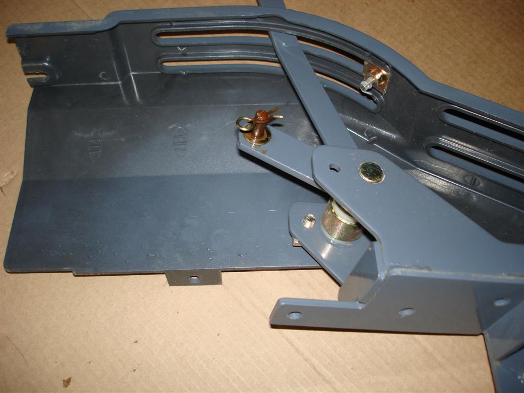

Installed the new upgrade kit for the KL 130 loader control. The job isn't bad, but be kind to yourself and take the seat and panel next to joy stick off, as it will make life so much easier. This way I could slide the block out to take apart and not fight the shift boot. I included a couple pictures, these parts have over 160 hours on them and look to be in good shape, just a few digs in the plastic. When ever I used float position, the thought of wearing the control played on my mind...not anymore. Even if the part wears out the fix isn't that bad.
I wish there was an easy way to soften, whatever mechanism that is used to hold control in float position. Still, happy with what I have and the job isn't difficult or expensive if you take your time. If I have to take apart again, I am going to drill a small hole over each Slide & ball and grease with a chain saw sprocket grease gun.
