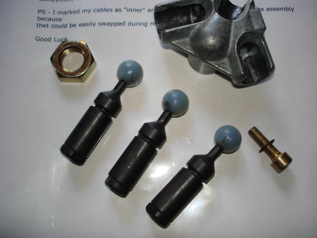

My 230hr CK25 loader control joystick had gotten so loose and floppy that it was barely usable. When I took it apart to take a look there are three nylon balls on posts that the joystick pivots on and these balls were worn out. I use the float function a lot and the fixed post/ball was really worn out causing the joystick to pop off of this pivot point. Researching on TBN it looked as thought the parts to fix it were going to be quite expensive. When I went to order the kit from my dealer I was quite happy to find out they have a new updated kit thats about $30. The new kit includes new posts/ball that look to be machined out of stainless steel and includes the new pivot part that goes between the joystick arm and pivot balls. This kit looks to be a tremendous improvement over the old design that used the nylon/plastic balls. I highly recommend the upgrade to others who's loader joystick is getting loose/floppy or uses the float function a lot. I know some people have recommended against using the float function due wearing out the joystick but I think this upgrade will correct that issue. Just wanted to let everybody know for about $30 and a couple of hours you can fix the problem and have a new improved design.

I just replaced the pivot balls on my 400 HR CK30. Unfortunately it was not as easy as described above. The shaft that the nylon balls are attached to necks down pretty thin and one was actually bent. I had to drop the entire assembly through the bottom of the tractor and use a cut off wheel to remove the tops off the shafts. They would not pull down through the plastic housing as described above. Otherwise it would have been much simpler.
In the end, it wasn't too bad of a fix. The joystick is much more ridgid now. I do worry about the part that is the interface between the shafts and the handle itself because it's aluminum. The new steel topped shafts will wear that aluminum and it will become loose again.

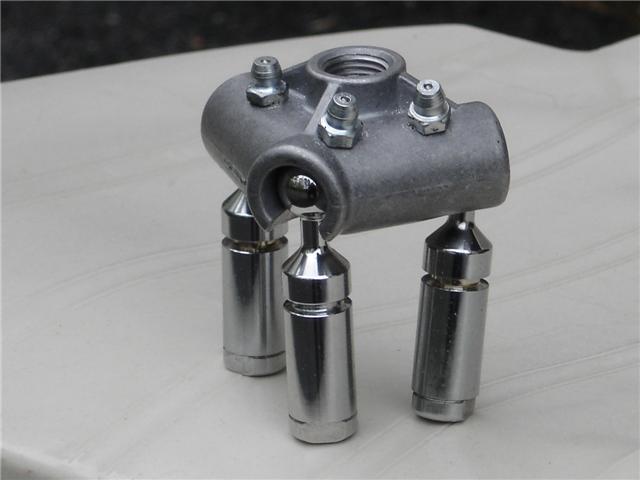

I installed the grease fittings. Afterall, it is metal on metal.

That's who I ordered mine from the last month.. as always great service and price from Wallace. But.. I did deal with the 'boss'.. Amy.
/ CK25 Loader control and "new" cenimatic kit #11
Thanks for the reply guys...I will get in contact with Rick. DrewL that is a clever idea on the grease fittings. I had to laugh at the picture sitting there it reminds me of one of the Autobot toys my grandson has.:)

It was because the teflon "balls" had scored and wore out so they would pop out of their sockets easeir and easier as time went on. As you can see in my picture the replacement is metal on metal hence me adding grease fittings

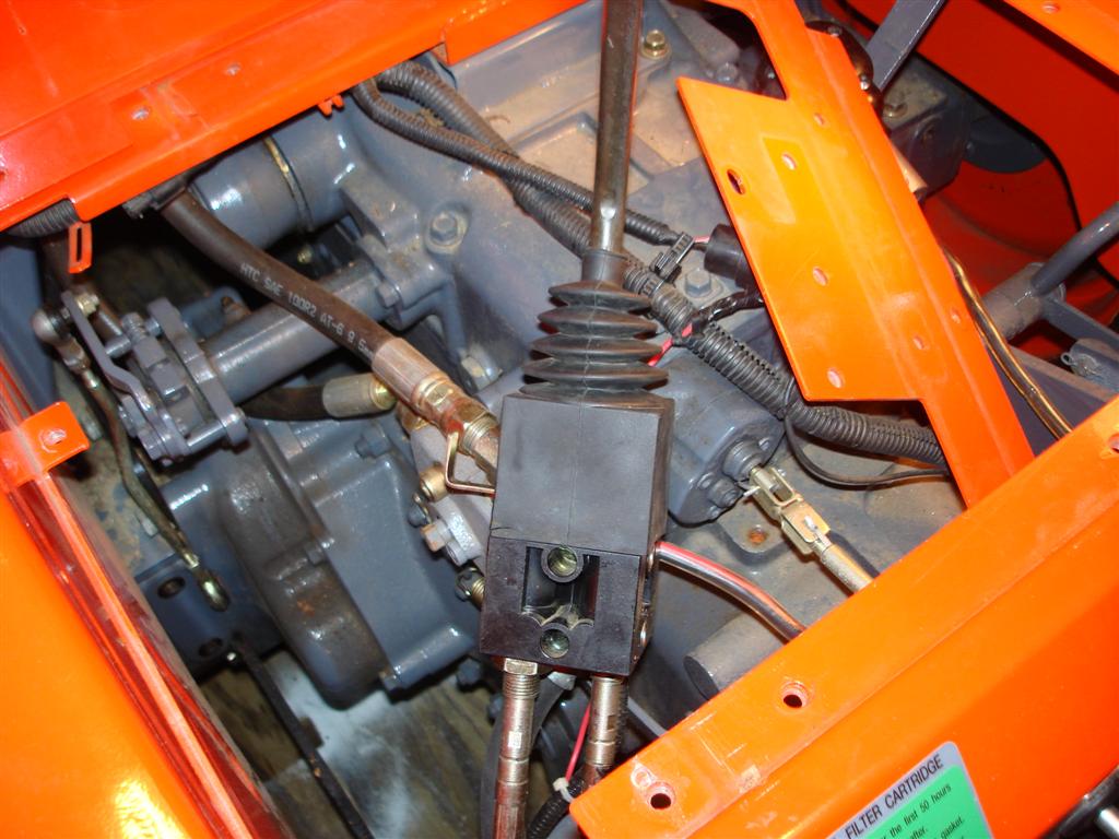

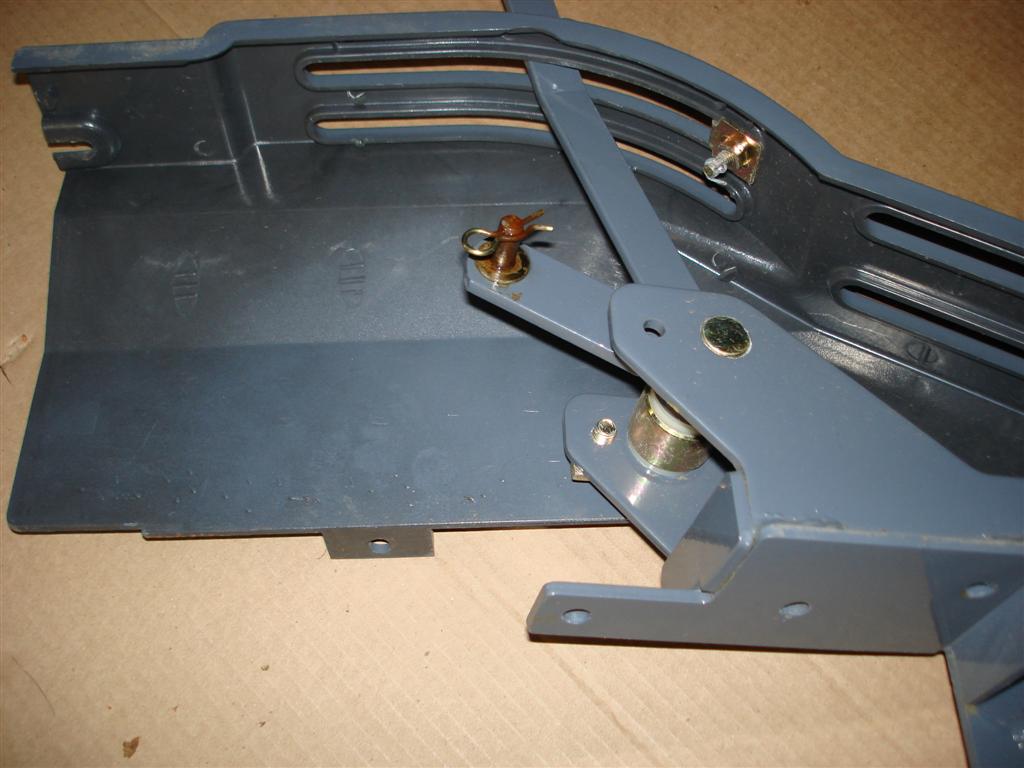

Installed the new upgrade kit for the KL 130 loader control. The job isn't bad, but be kind to yourself and take the seat and panel next to joy stick off, as it will make life so much easier. This way I could slide the block out to take apart and not fight the shift boot. I included a couple pictures, these parts have over 160 hours on them and look to be in good shape, just a few digs in the plastic. When ever I used float position, the thought of wearing the control played on my mind...not anymore. Even if the part wears out the fix isn't that bad.
I wish there was an easy way to soften, whatever mechanism that is used to hold control in float position. Still, happy with what I have and the job isn't difficult or expensive if you take your time. If I have to take apart again, I am going to drill a small hole over each Slide & ball and grease with a chain saw sprocket grease gun.
