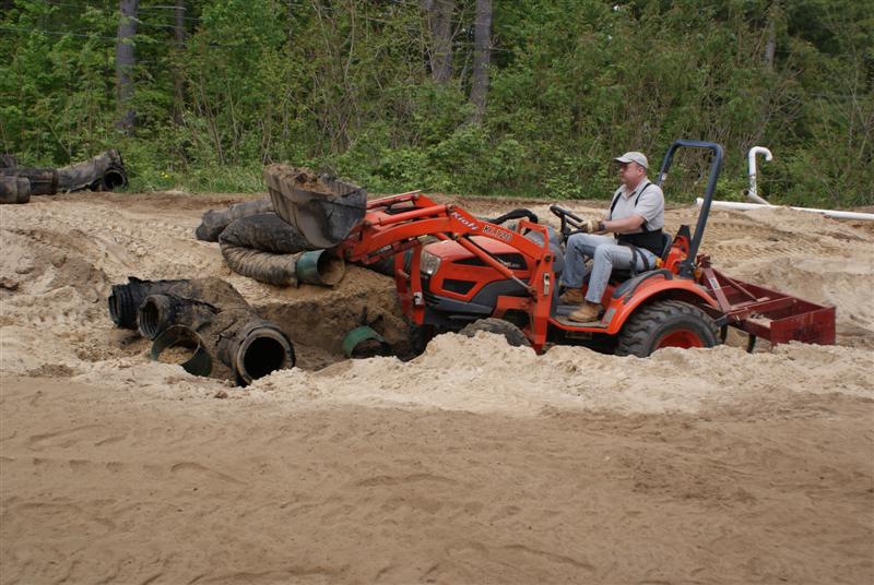

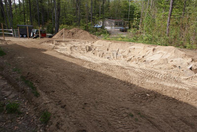

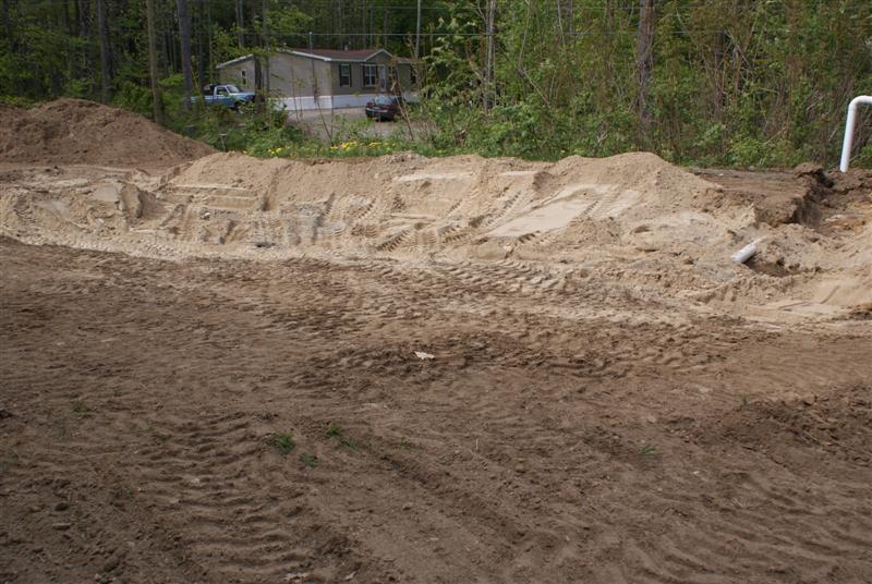

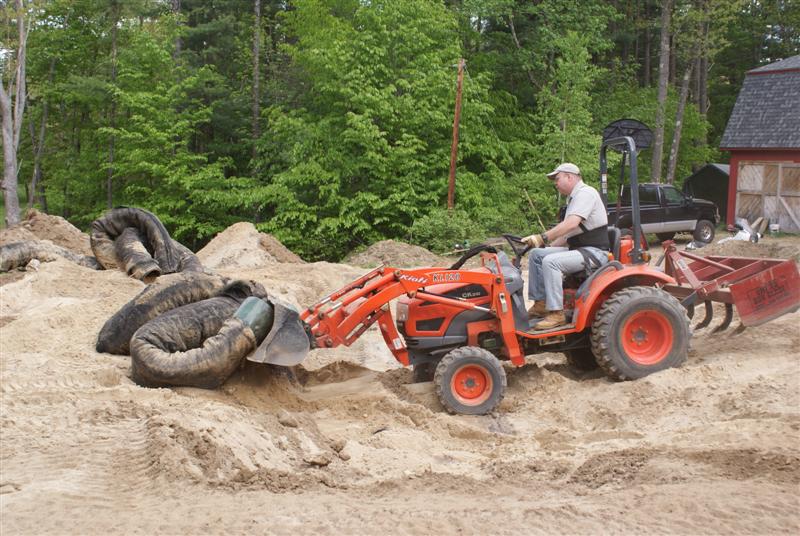

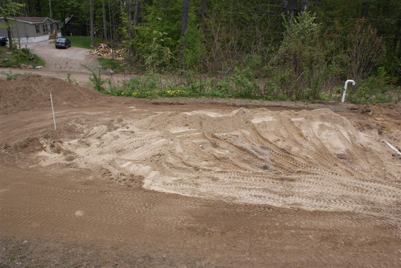

Well as some of you know, my enviro-septic system failed for a number of reasons.
So with a long weekend coming, and the prospect of a nice weekend. What better time to get some seat time..
First I scraped all the topsoil off to save for later...
Next was to remove as much sand that I could reuse and relocate it out of the way..

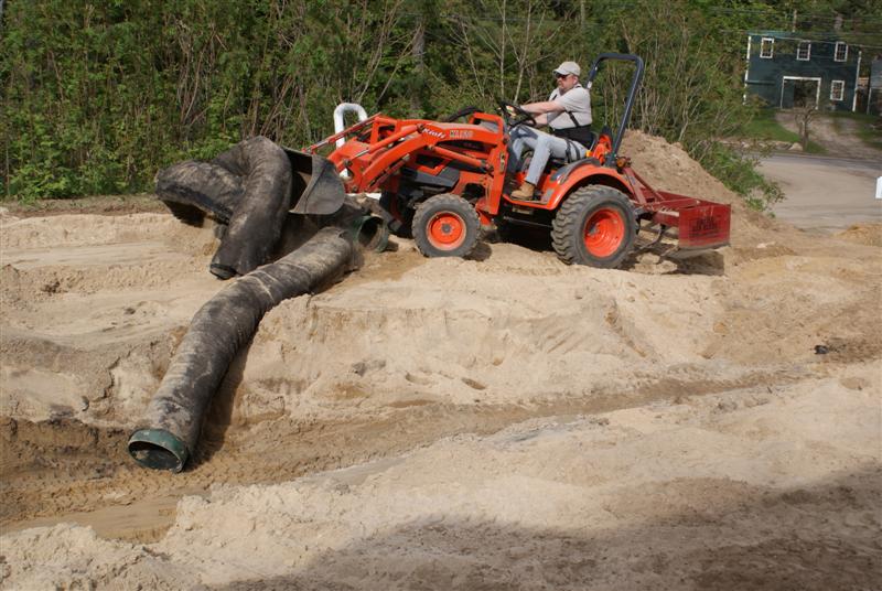

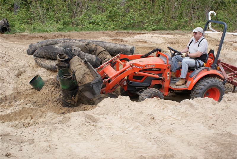

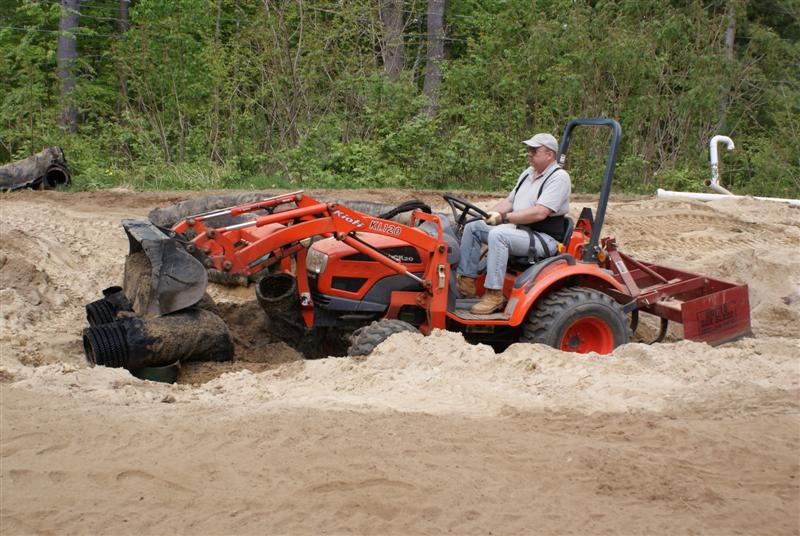

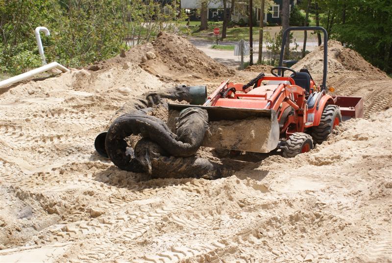

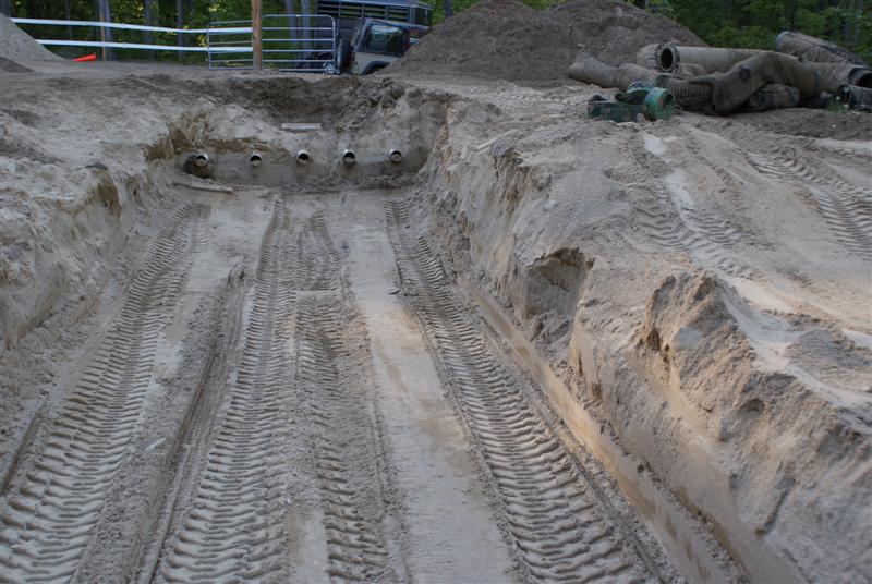

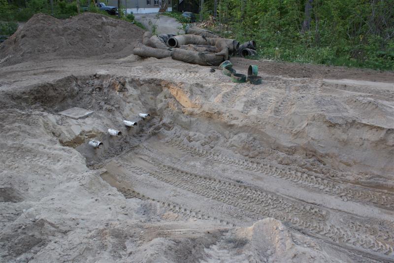

Next was to actually remove the old pipes

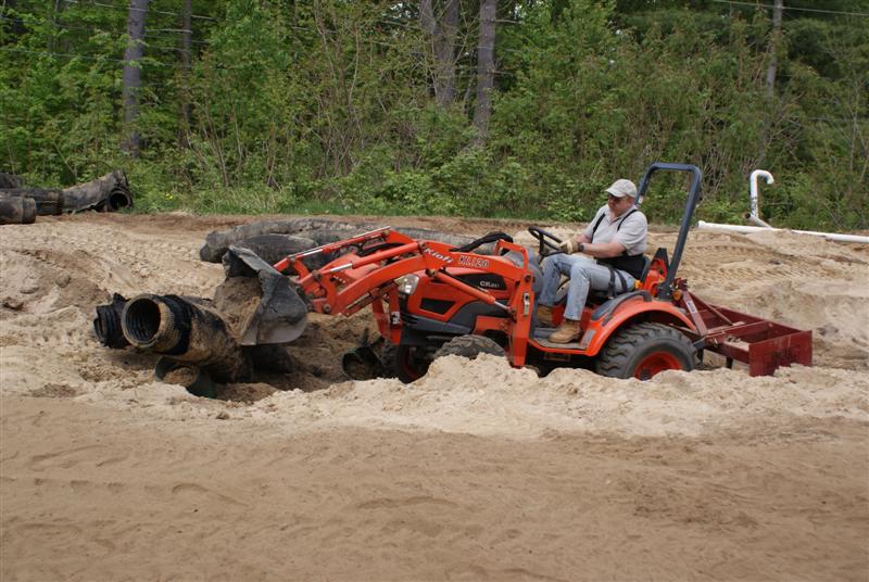

I had to cut a ramp to be able to back my little HST out with a full load of wet sand..

I haven't been to the site in a while, so bear with me. Why did the Presby system fail? What was the failure?
Just curious, I install septics and haven't had nor seen a Presby fail,......yet.
Thanks.
/ CK20 does super .. crappy job
Thanks.
A number of reasons...
But I believe the primary cause was the water filter discharged into the system.
Funny, I have had two separate people in the septic business say that I was lucky to get it to last the 9 years it did. They were replacing many of these in the 5th or 6th year

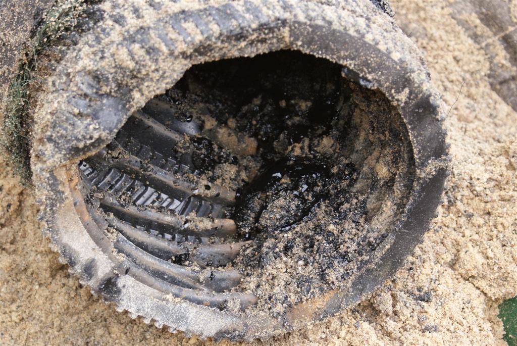

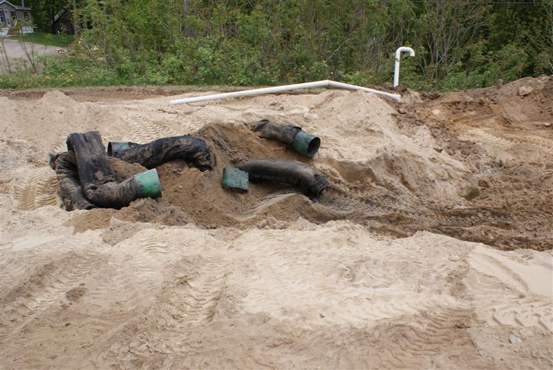

Now for the guys that think you should be able to clean and reuse these pipes...
YUK

atgreene said:
Interesting.
When I took the cert class from Presby they were pushing them pretty hard for commercial apps. I've only installed a couple, primarily because of their limited space requirements, although an Eljin In-drain takes less room, so we use them a lot around the lake.
What are you replacing it with, stone bed, in-drains or infiltrators?
The designers like it because of the small space requirements. My field for instance for a three bedroom is 5 tubes x 35' fits completely in a 10' x 40' space.
I can only legally rebuild it as originally designed, so thats what I am doing. I don't have room for a stone bed. Although I have been recommended to put crushed stone under the field. It's not exactly approved by the state.
I will be adding a vent, the original design did not have one. When I tried rejuvenating the field last fall I added a vent to see if it would help. But as you can see.. It only delayed the replacement.. At least the weather is better!

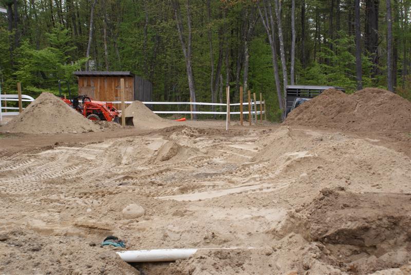

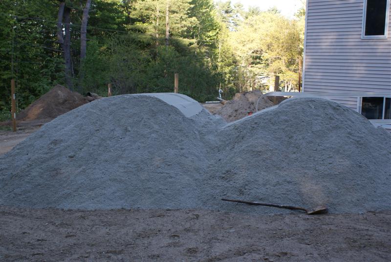

Update:
Cleaned up the rest of the soiled sand and opened up the 5 pipes in preparation for the new sand.

Looking good. Just be careful that the bed bottom is perfectly level or you will have another premature failure as the "effulent" will build-up on one end. I am a firm beleiver that the Presby Enviro's are the best system out there for cost and size.
#16
Thats for Monday, I have a water level to make sure it's nice and flat.
The plan is to level the base, set the pipes, and gently start placing the sand around the pipes.
Oh what fun !

I'm still at a loss as to what you are calling a failure. To me a Presby system failure would be the units are holding, and not releasing, the water. If so the sand would not be saturated. I've seen my neighbor's leach field saturated on a couple of occasions. It's a rental property & the tennants didn't tell the landlord their toilet was running continuously until the field wouldn't take any more water. Both times it dried out in a few days. Are you simply flooding your system with more water than it can get rid of ? MikeD74T
#18
The failure as it was explained to me.
The membrane surrounding the pipe and the first couple of inches of sand get plugged with a black Tar like substance.
This does not allow the field to work correctly.
Only recourse is to remove and replace...
