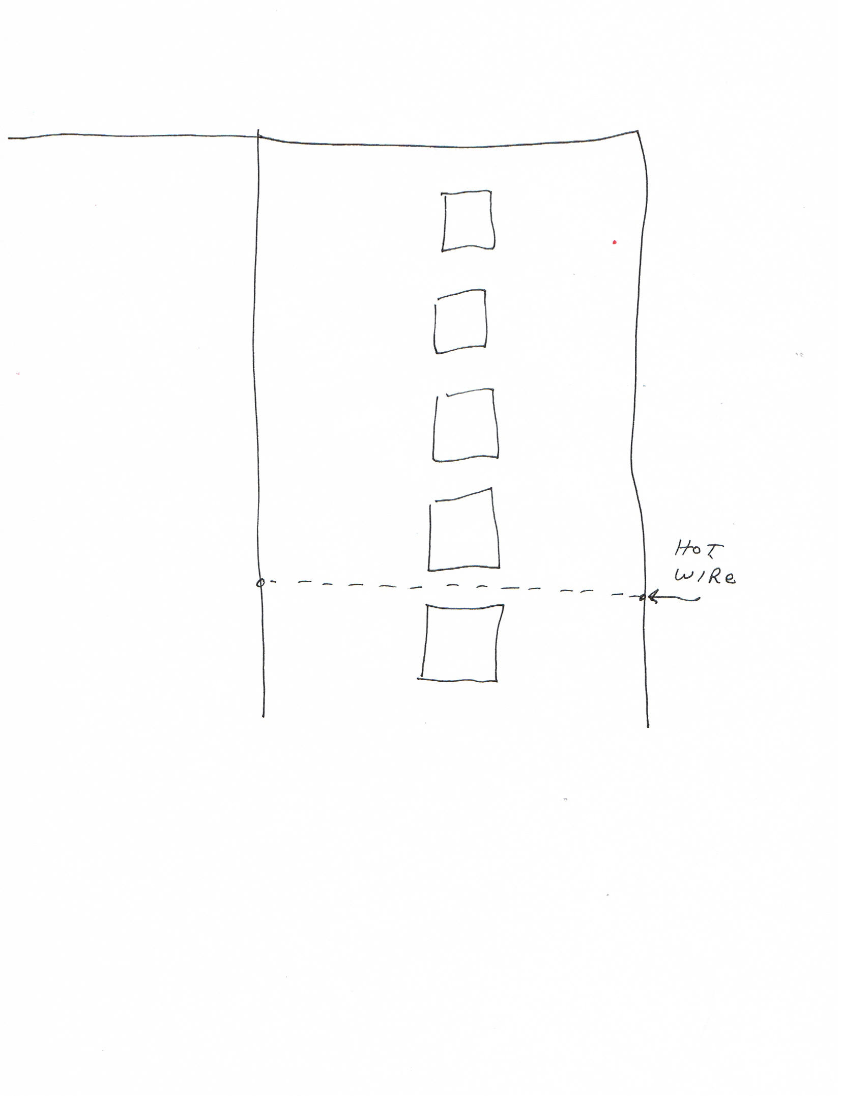

If you are feeding limited numbers of rolled hay bales, there is a way to feed them without the use of a tractor. Put the bales in the corner of the winter pasture field and line them up in single file and leave about a few feet between each bale. Then run a hot wire across in front of the first bale. When that bale is eat, move the electric cross fence back 1 more bale and when that bale is eat, move the wire back one more bale. I have a BIL that has used this method for many years. He does not even own a tractor. Ken Sweet

Ken that is a great idea. to start off with we will only have 3 - 4 cattle so I think this would work. I will have to remember this when I build the fence this summer.

Here is a rough drawing to show one way to feed round bale hay without a tractor. Ken Sweet

The method Ken suggested works great.
