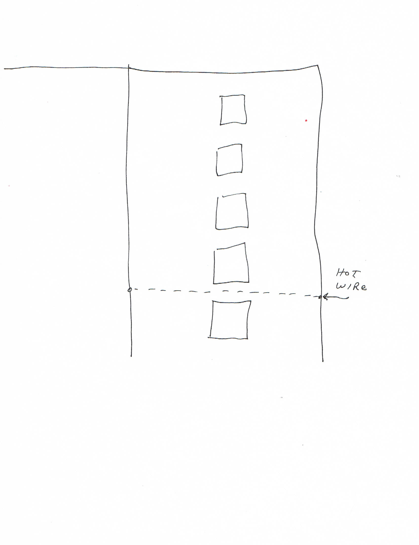

If you are feeding limited numbers of rolled hay bales, there is a way to feed them without the use of a tractor. Put the bales in the corner of the winter pasture field and line them up in single file and leave about a few feet between each bale. Then run a hot wire across in front of the first bale. When that bale is eat, move the electric cross fence back 1 more bale and when that bale is eat, move the wire back one more bale. I have a BIL that has used this method for many years. He does not even own a tractor. Ken Sweet

Ken that is a great idea. to start off with we will only have 3 - 4 cattle so I think this would work. I will have to remember this when I build the fence this summer.

Here is a rough drawing to show one way to feed round bale hay without a tractor. Ken Sweet

Bale grazing works well (the method Ken mentioned), or you can also just hook a tow strap or chain around a bale and pull it. I’ve had to do than when I had a flat on the tractor. Cows need to eat regardless. I don’t know anything about that particular tractor, but I do have some experience moving round bales near the lift capacity of my tractor. When the bales are new, it’s a little dicey on the hills, but not all that bad. But, in the winter and the bales now have a lot of moisture/ice/snow (weight), they’re all of sudden very tricky to move. Sometimes I have to back up hills just so I can steer. Remember, the lift capacity is typically at one certain point. A very large round bale is going to extend beyond that, reducing the capacity. If the farmer is able to make them smaller, great, but not everyone can or will.

The method Ken suggested works great.
An alternative is to get a single bale hay buggy with a hand crank winch and pull it with your tractor. It may still tip over, but only the buggy will go and not the tractor.
