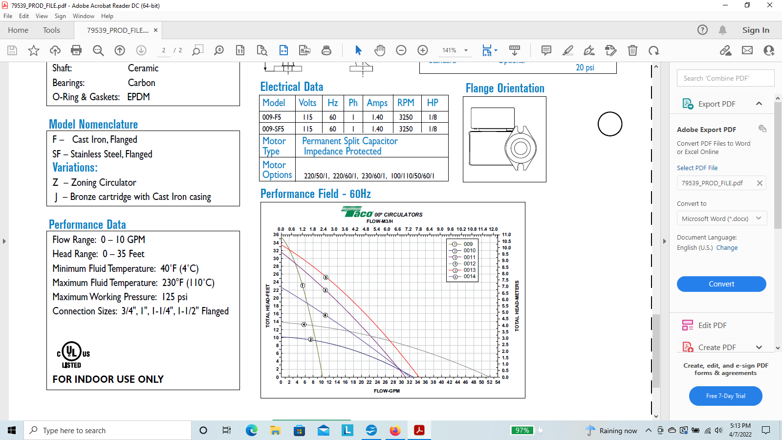

I have an outdoor wood boiler. After 8 years the Taco 009 circulator died. I am looking to find an energy efficient replacement. The height it has to pump is around 14 feet, boiler to the basement. I use a heat exchanger so I don't need to pump up three stories. I'm just trying to lower the electric bill some. Anyone know of a good pump for this?

So the Taco 009 is 1/8 hp and draws up to 1.4 Amps at 115 volts or approximately 160 watts.
To use less energy you would need a smaller motor.
Grunfos has some as small as 1/15 hp.

Since you are running a loop, it really isn't up 14', it is about how many gpm that you need/want. Faster will equilibrium the temperatures sooner, but may be less efficient, depending on your heat exchangers.

Well I found it Taco Viridian 1816 variable speed 4-44 watts. I even got a cartridge to rebuild it when it goes. I got lucky that it died late march and not in February at - 5* , prime time for my OWB to break down. For now I'll fix it and shut down for the season.
