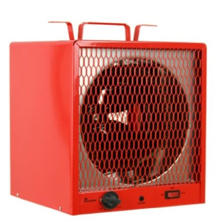

How about a heated shop or garage to park it in:D
