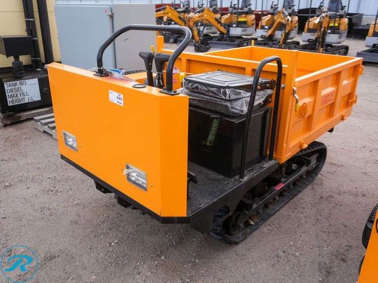

In general, I am all for fixing up old equipment and getting them running, but for $3k-ish you could buy a dedicated dumper crawler with a 3,300lb capacity. E.g.
There are bigger ones available from Yanmar and others, and cheaper for direct import.

I agree! I are pretty neat units. I had no idea that they had gotten so cheap until I looked for @modro. The Yanmar units that I am more familiar with are a lot more expensive. I have seen them used for remote construction work as they have much better flotation than wheeled vehicles, and far more maneuverable.
