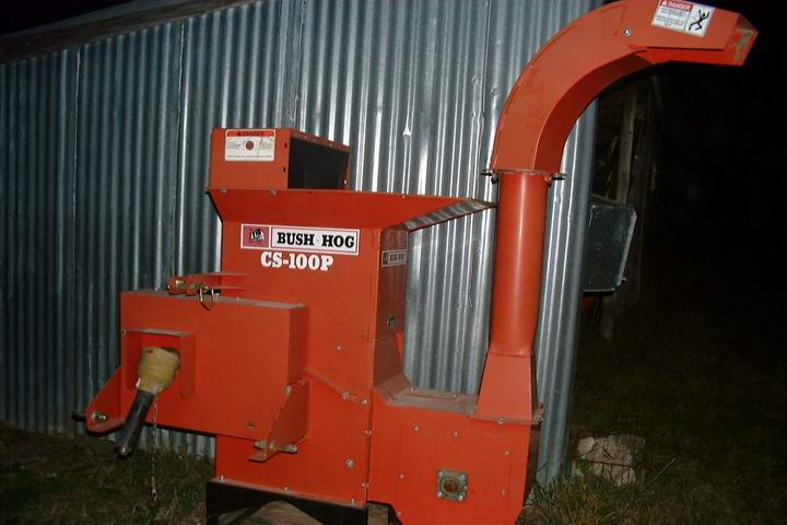

My chipper is a Harper-Goossen that was rebadged as a Bush Hog. I have the PTO powered CS and a blower attachment. I was lucky to find it in almost perfect condition for $2400. The person selling it had used it once and it scared him to death when it sucked the branches down the shredder. It's also pretty noisy, but I don't know how to get around that. I've thought about converting mine to a tow-behind and put a gasoline motor on it. Like anything PTO powered, it means your tractor is not available while it's running.

Same as mine but without the blower, paid $1500 and it too was not used much. That unit is re-badged for a few people. I don't use the shredder much at all, but it's nice to have once in a while. Over the life of the unit, the extra cost will not be much...
Here's a photo of mine "dressed up" as a Bush Hog. I'm sure that red paint made it more expensive.:eek: The blower is easily the loudest part of the machine. It roars like a jet engine and you DO NOT want to get in front of the exhaust chute. It's not really visible in this photo, but it has a hand-crank to position the chute 360 degrees.
