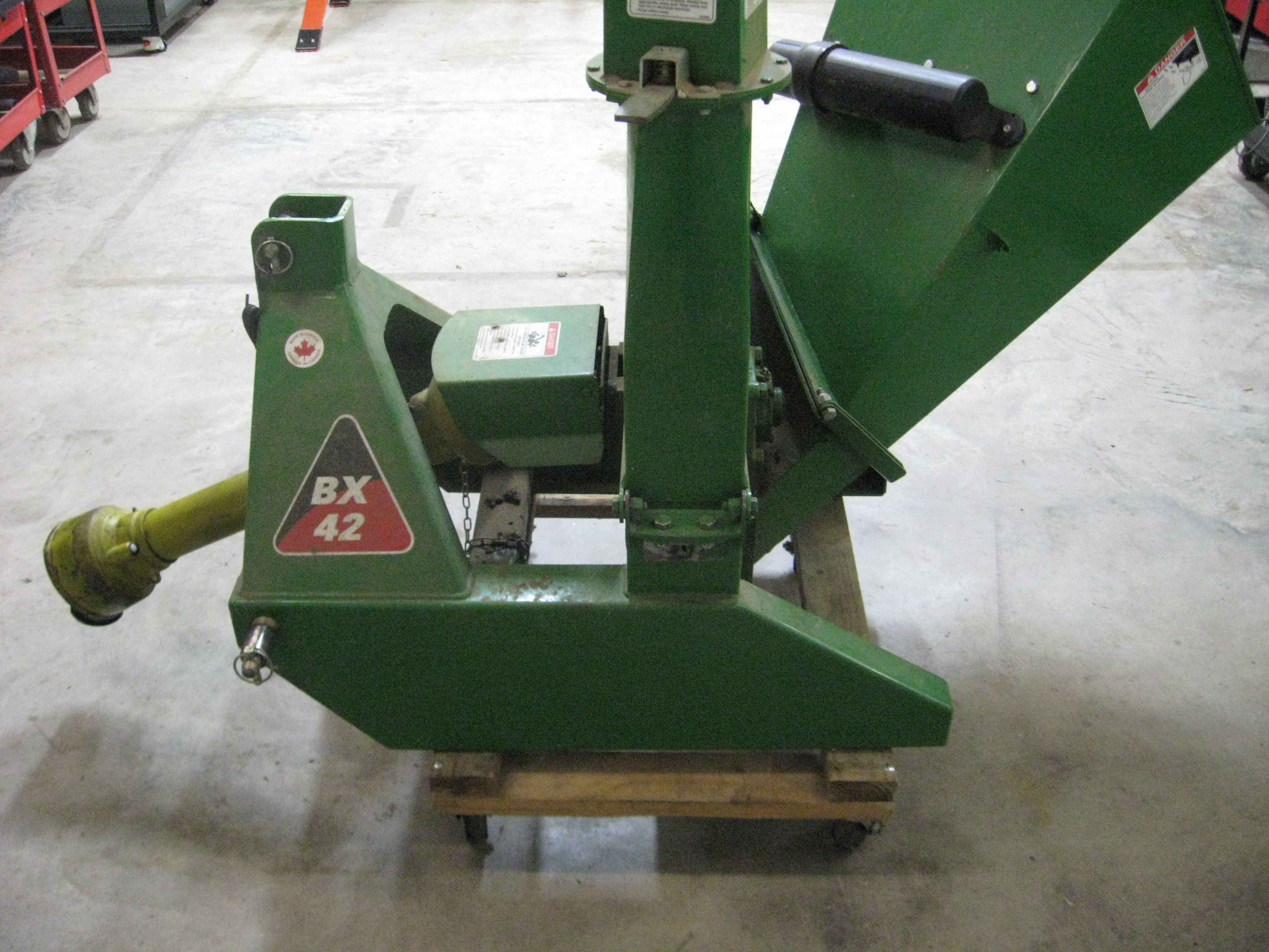

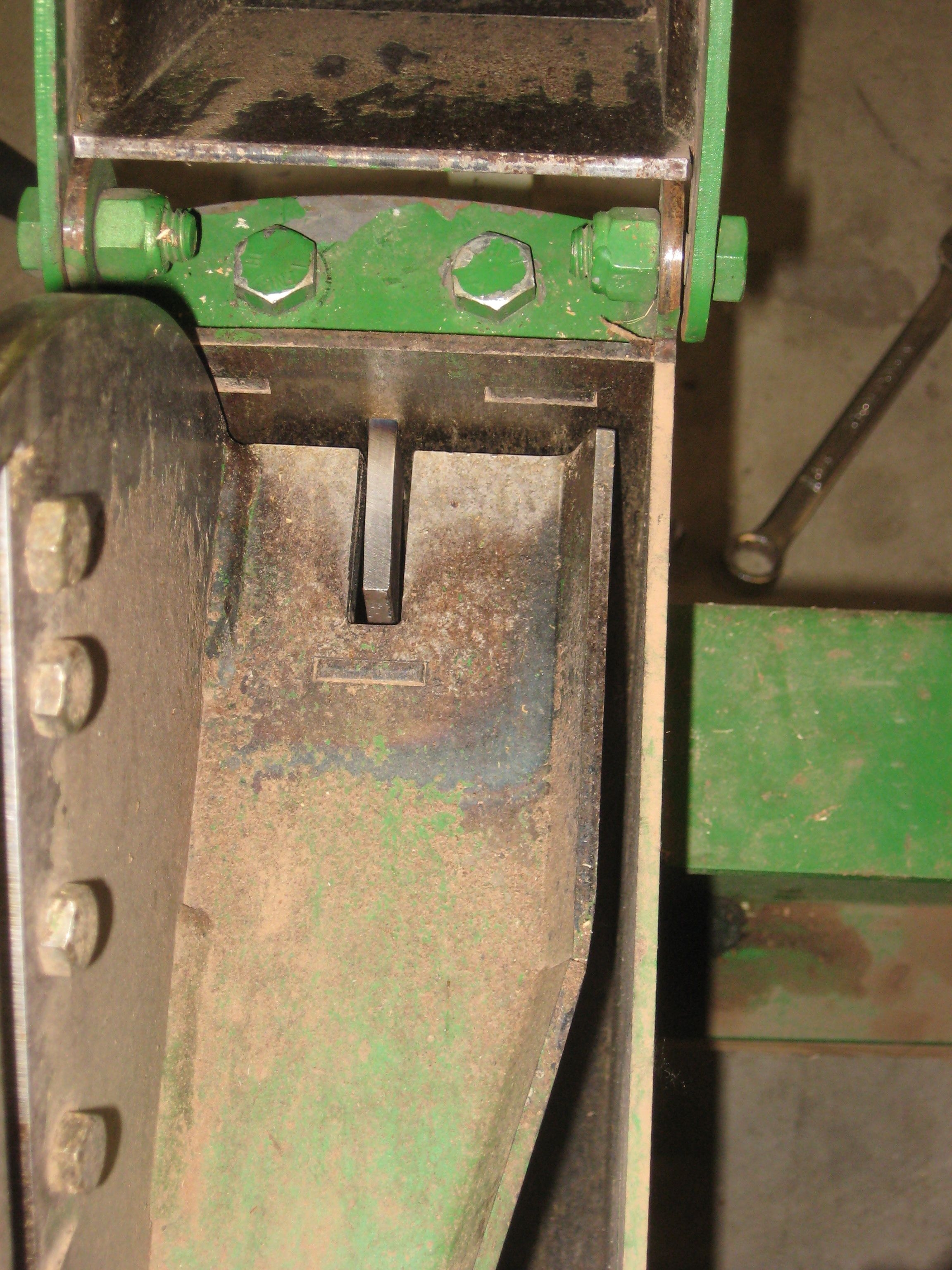

Needed to do some chipping yesterday, but before I could do that, had to replace the "twig breaker" on the Wallenstein BX42 chipper. Well, didn't have to, it will work OK without it, but it helps break up stringy stuff. Not sure if other chippers have this but thought I would show the fix, up close and personal.

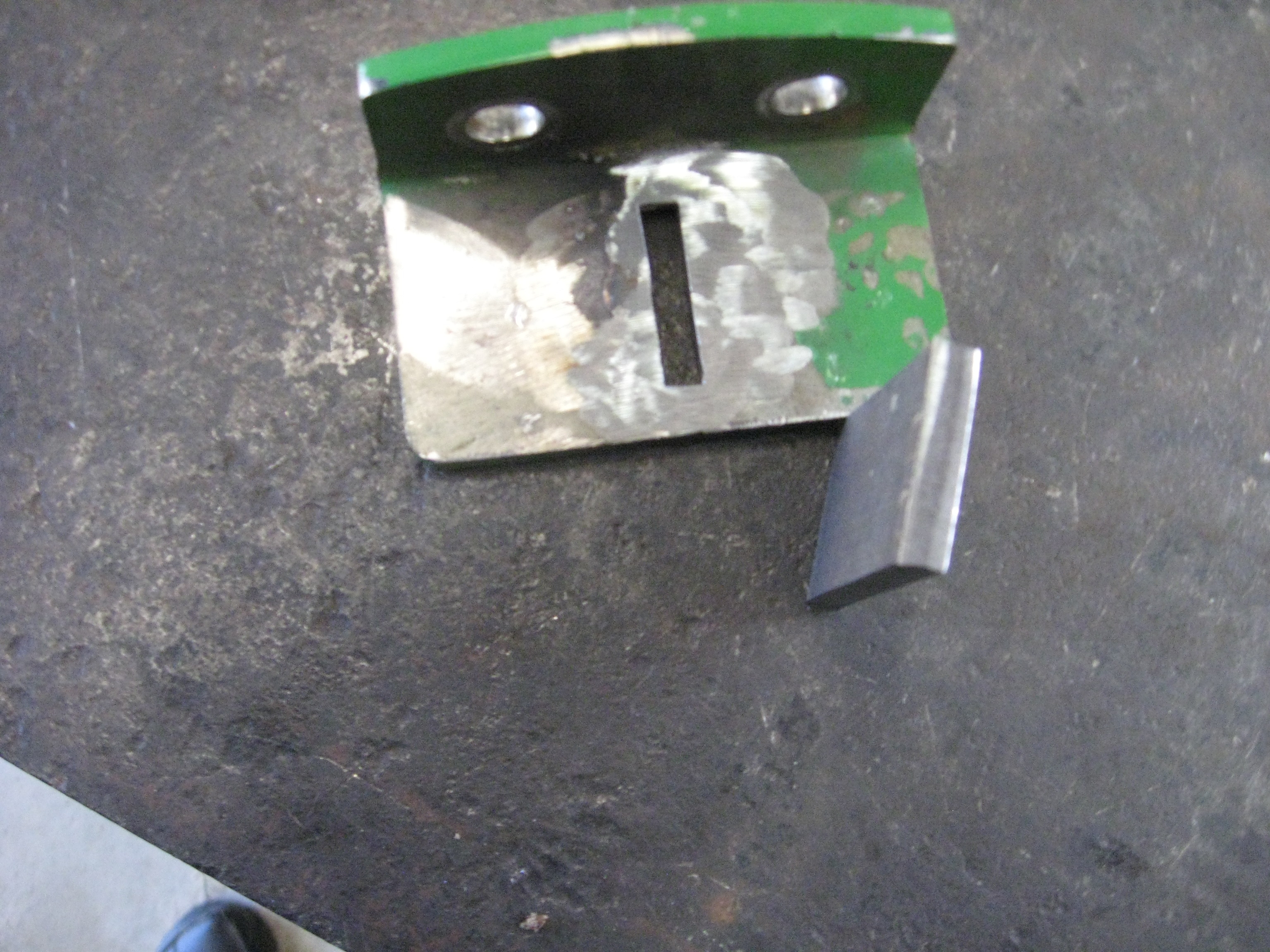

The twig breaker consists of a piece of bent plate with a rectangular hole punched through it, and a piece of 1/4" x 1 1/4" x 2" steel bar puddle-welded into the hole. There is a rectangular hole punched in the side of the rotor housing through which the bar is inserted and the bent plate is then bolted to the lip of the housing where the "clamshell" separates for maintenance. There is a corresponding slot cut in the rotor fan blades that rotates past the twig breaker, thereby cutting up long pieces into smaller pieces on their way out the discharge chute.

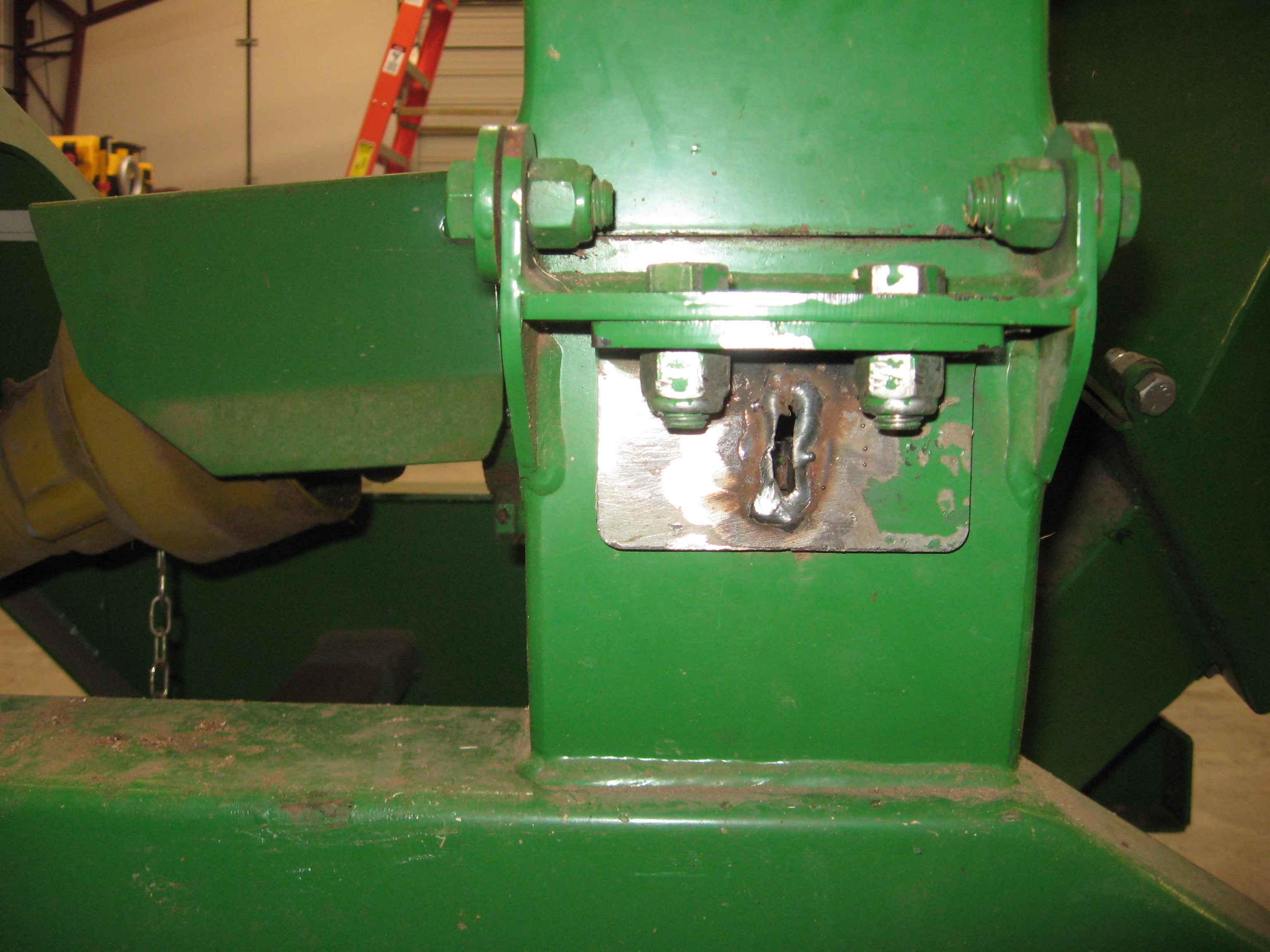

Obviously, this piece is subjected to some tremendous stresses when larger pieces get caught in it and this is the reason for the puddle-weld attachment method: it is made to break free when overstressed (or if it gets bent) to prevent damage to the rotor fan. I wind up replacing this piece at least once per season, so I keep a stock of the pieces of replacement bar stock.
Side view, twig breaker below separation line of the cutting chamber, directly below the discharge chute.

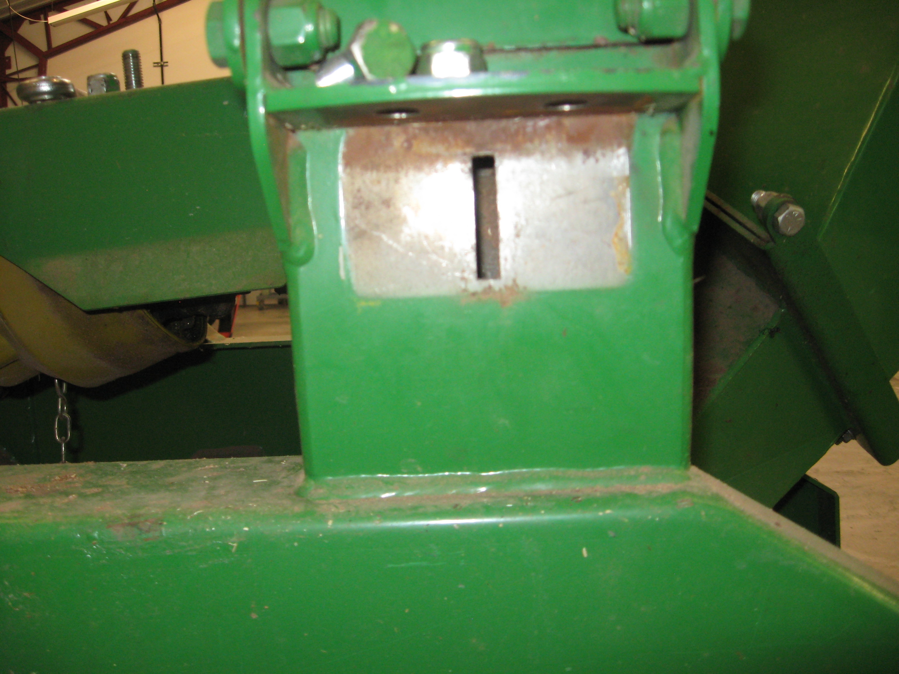

Note the hole in the weld where the breaker bar used to be

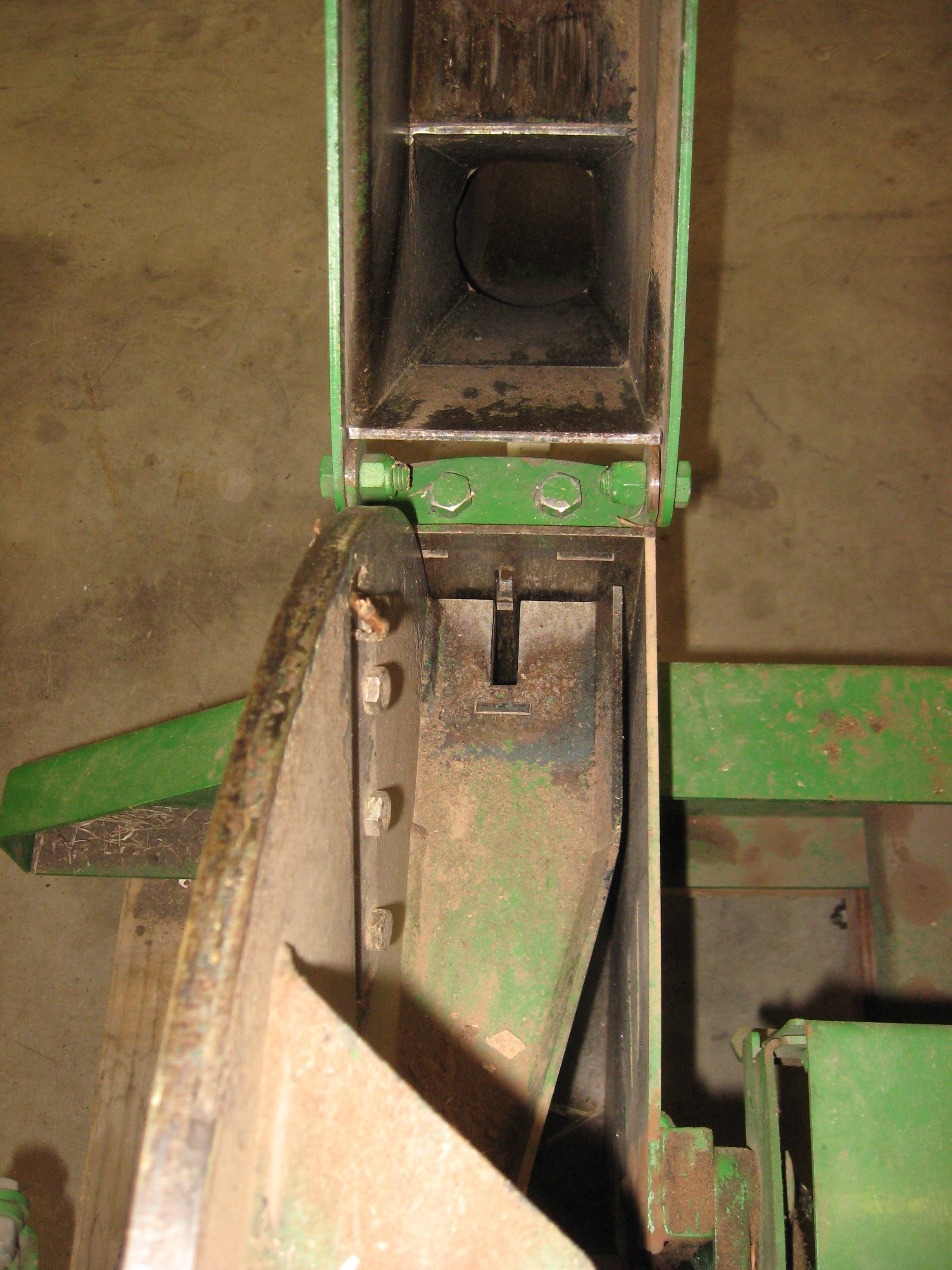

Inside fan chamber looking at punched hole where twig breaker enters. Note corresponding slot in rotor fan.

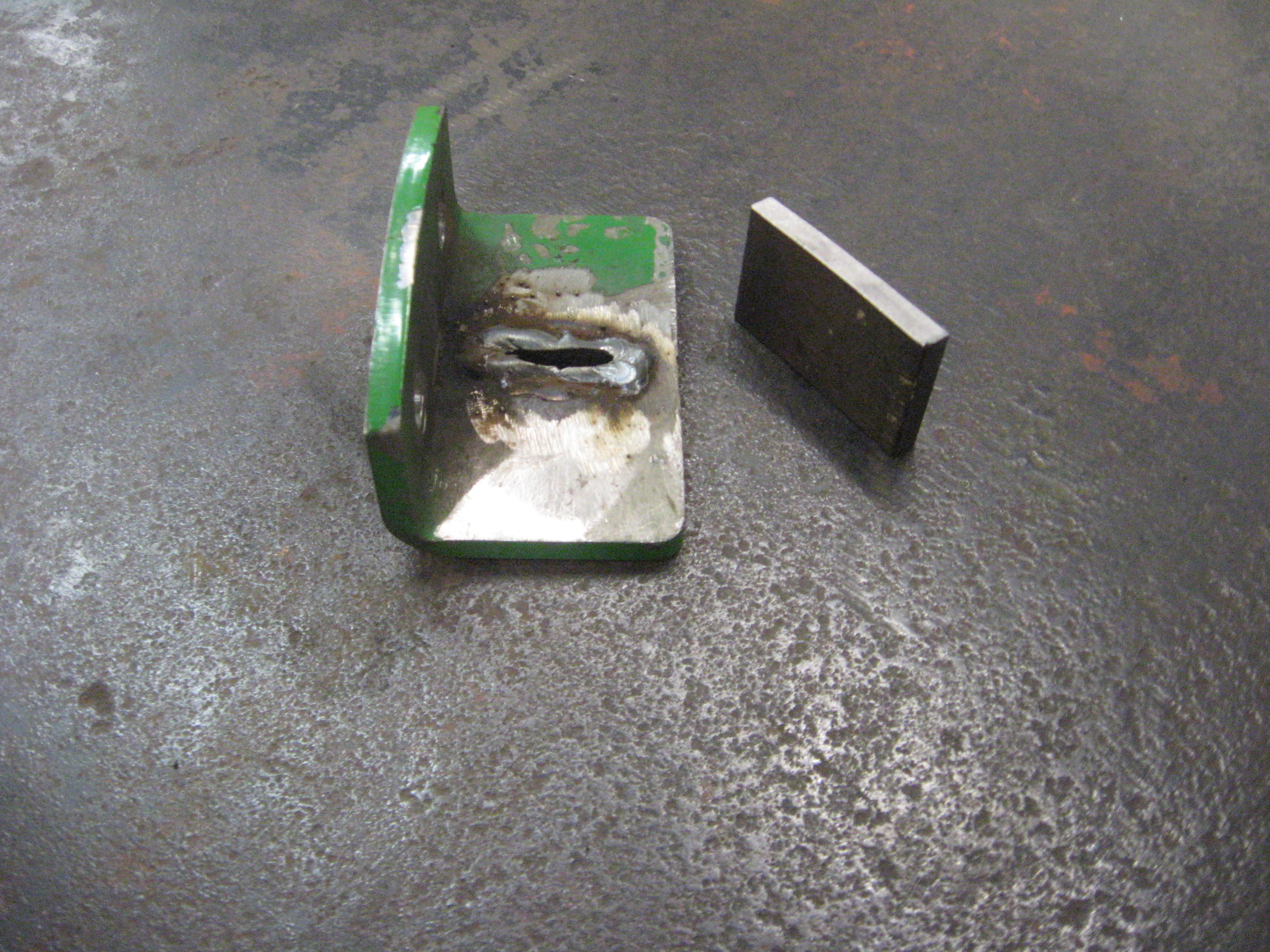

Twig breaker removed.

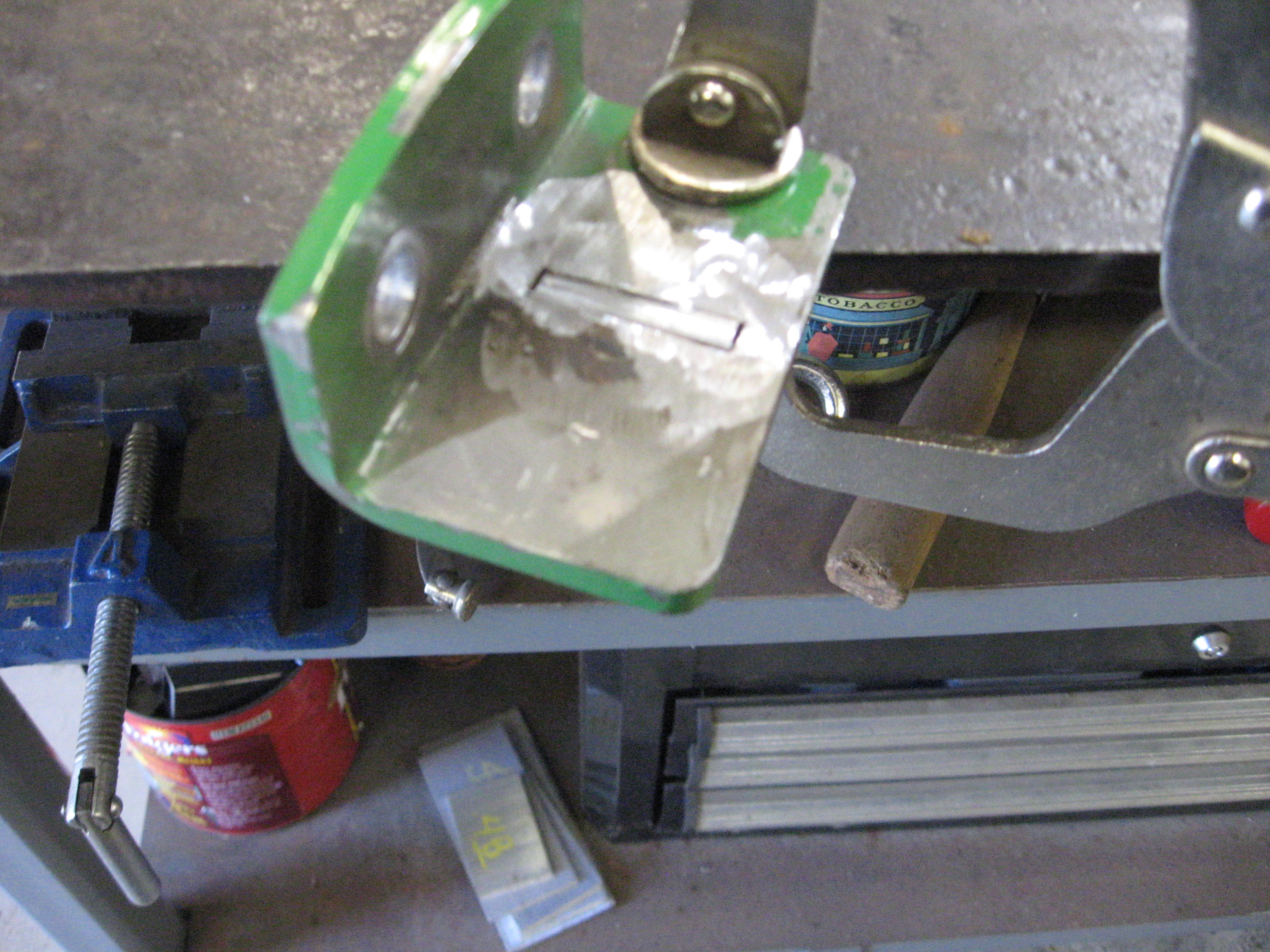

Twig breaker and new piece.
Twig breaker with old weld ground off.
Ready to weld.

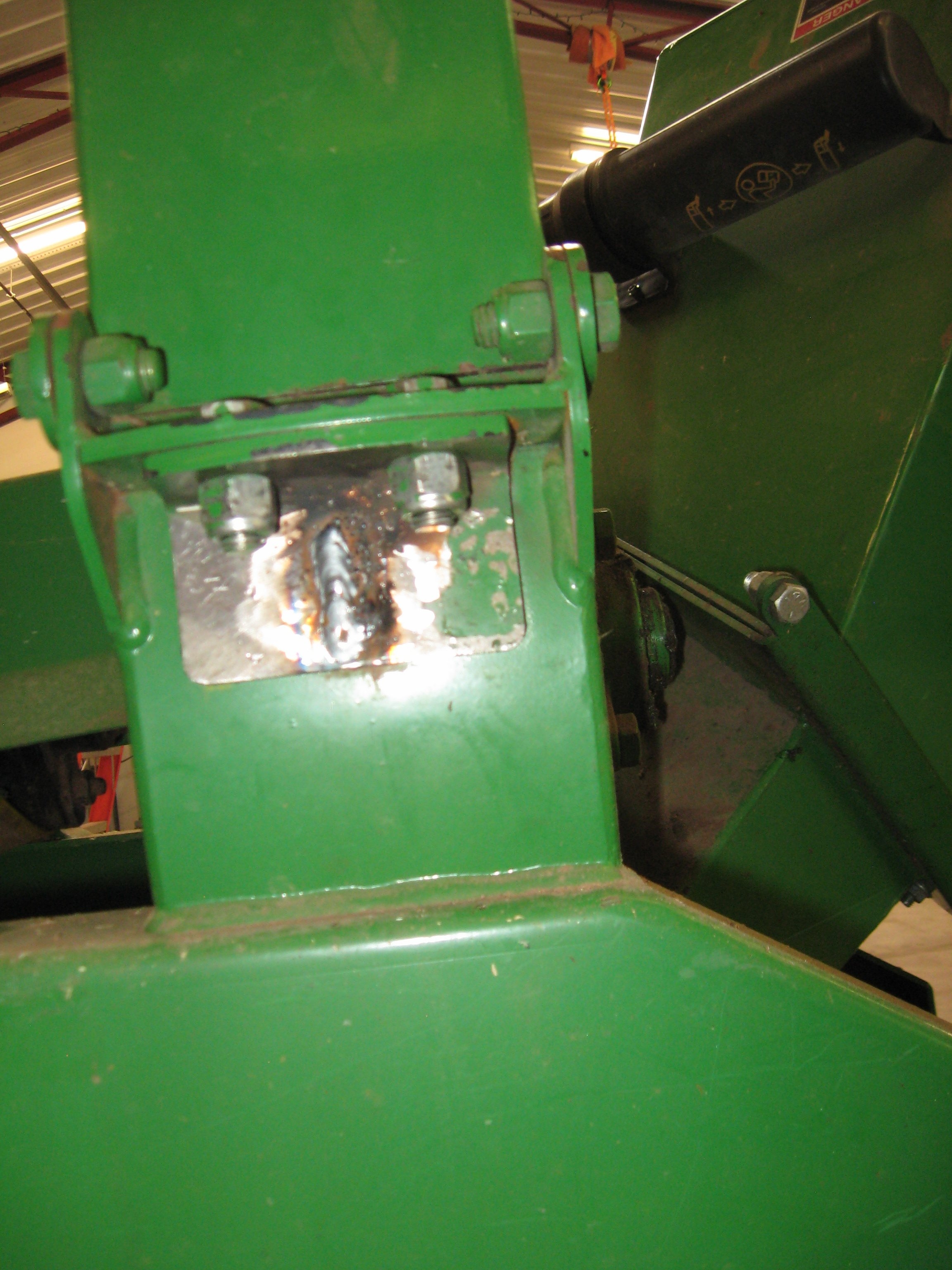

Back in place.
Back in place, inside view.
Ready to chip.

I'm surprised that the breaker bar is not chiseled to a sharp point to help it cut... even if just a little bit.
/ Wallenstein BX42 Chipper Twig Breaker Replacement
I just replicated what was there originally, but I might just try putting an edge on it to see what happens. Only thing is, if it was sharpened, it might have more of a tendency to just draw pieces through whole, rather than break them up. This is pretty much a brute force deal, meant to just snap stuff in half, rather than cut it (at least up until the force snaps off the bar).

I had a Wally BX42S for many years - now a BX62S. What happened to the OEM twig breaker on your 42??
BTW - you did a superb job on the replacement.
It just broke off and, as mentioned, it happens on a regular basis. I don't think I saw it in the manual or anything, but just based on the design, it became obvious to me that it was made the way it was so that it could break off, rather than causing lots of damage if it got caught on something too hard for it to break. Kind of like a shear bolt.
If it were made to stay intact, no matter what, they would have extended the breaker past the outside edge of the bent plate on the outside, then welded it. Then, there would be no way it could come loose. I actually thought about doing the repair that way, but then I realized how much damage it might do if it couldn't break away.
Wallenstein offers them as a replacement part (the whole assembly, not just the part that goes inside the rotor housing).
I'm really glad that I was not in the path of the chute when that piece came out of there. I do have a bad habit of ducking under the chute in order to get to the PTO switch when I shut it down....
