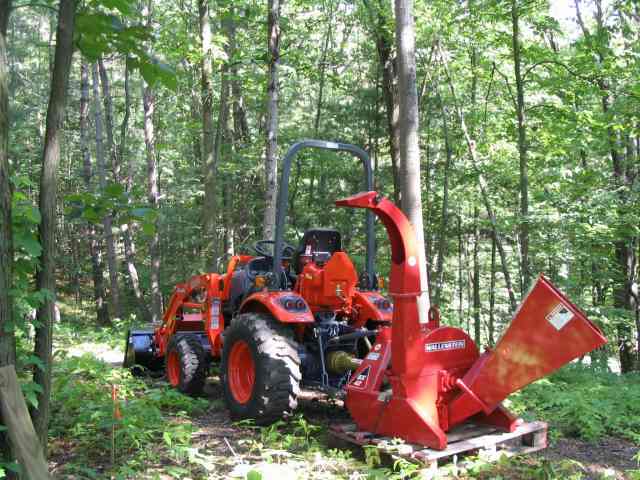

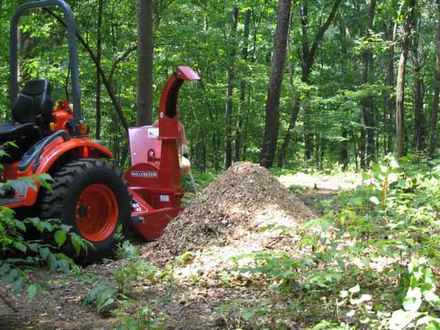

There is a TBN member that is using a Wallenstein BX42 chipper on his CK20, and as far as I know he has had very good results with it. I saved a picture, but haven't found the thread.
/ chipper and CK20 HST #7
That is a good deal larger than the DR and if the chip pile is an indication, works well.The DR is just a tick under $2,000;what does that beast cost?
