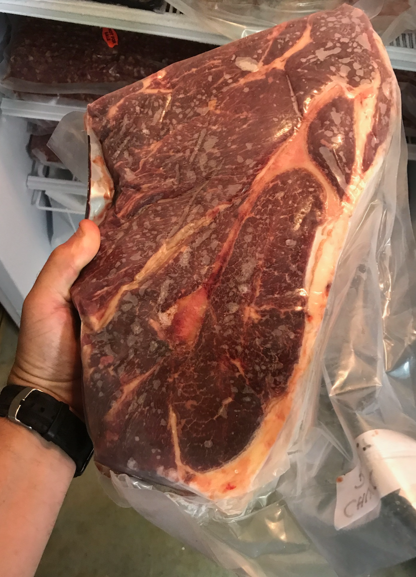

I'll see your sirloin, and raise ya a Porterhouse :D
enhance
enhance
Dang, I'm lucky if I can score 3 quarters of a cow at the beggining of the year.
I've got to ask, is the window shaker the only thing you're using mechanical for cooling in the meat locker between 30 and 40 F? Or what temp do you keep the room?
