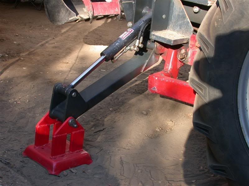

Hope you don't mind me sharing some photos of my DPOCV's on different cylinders.
These are on my backhoe stabilizer legs.

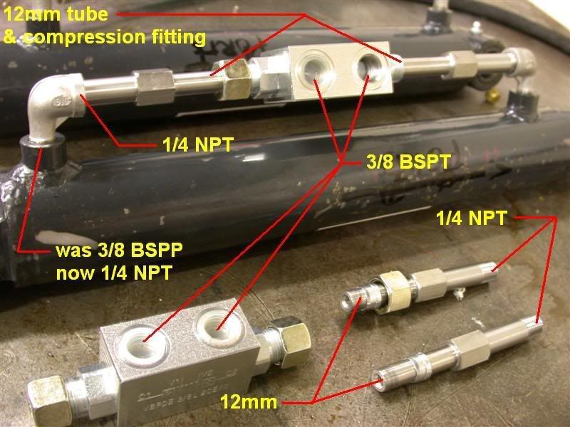

They are CCM's and are very small and compact. They fit nicely in tight places.

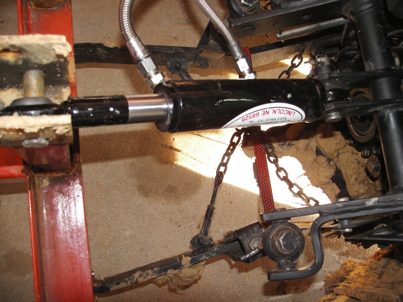

These are from Surplus center. They are what I used for the hydraulic side links and are quite a bit larger than CCM's but don't look that big on these cylinders, since the cylinders are big 3-1/2" ones with 1-1/2" rods. Their cracking pressure (or pop off) is rated about the same as CCM's.
This is another CCM CPOCV used on the hydraulic gauge wheels.
They keep the level of my rotary cutter or boxblade or rake right where I set it.
