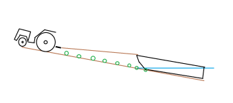

Because of my confusing description, I decided to draw a crappy picture. If you try to drag the boat up greased planks it is going to slide off the sides, just use log rollers to defeat friction. You still need to float the stern and get as much water to drain out as possible so you don't damage the boat with all of that extra weight, but once you lighten it up it should roll quite nicely.

Zing, picture isn't coming in for me, but I was wondering why log rollers would be any different that anything else as far as allowing the boat to slide off the ends. If the boat gets out of position, as it comes up out of the water, then the tractor pulling it isn't centered.
PVC would also work as a roller, not as cheap as Zing's suggestion, but they do offer more of a slick surface to pull across in the case of the logs getting stuck in the sand.

Normally log rollers have several feet in every different direction from the keel on a center keel boat, so there is lots of room to move without sliding off. In his case since it is a dual hull pontoon style there is less room to move, you are right. I would have said to make the a lot longer than his boat is wide, but the boat ramp makes a little gulley so there isn't enough room to lay down a really long pole. The advantage of a log roller over a greased plank or one foot long rollers for each hull like he is describing is that as the boat moves closer to the edge it will not dig one edge into the ground and/or flip over. With a plank or skinny ramp you have to keep both planks totally straight with the keel of both hulls as the boat travels up the hill and even going a few inches to one side can cause them to flip over or twist sideways. Log rollers are much more stable and if one gets twisted sideways a bit it doesn't matter because the next one will be straight again as you pull the boat up onto that one. The other advantage of course is the cost and simplicity, you can make them for free from the materials on site. He could also make some longer ones for once he gets up a bit higher out of the gulley if the land flattens out a bit.

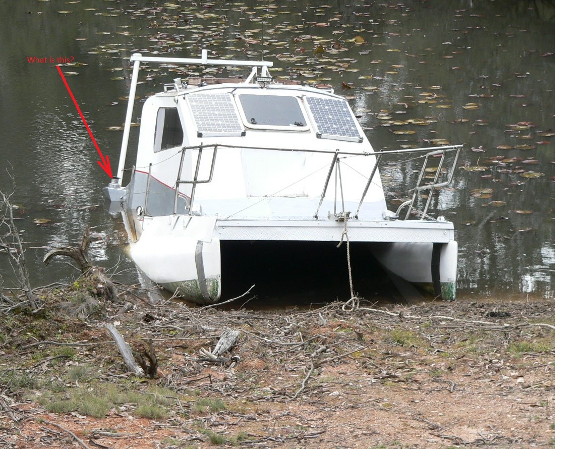

Made the ramps today - opted for greased slides instead of rollers due to far less work - think they will be OK because the angle is not very steep - or will not be when the stern rises. As noted earlier. two 4WD vehicles, one on either side of the trailer will have more than enough grunt. Note the raised sides on each ramp - to keep the keels from slipping sideways. A cross beam bolted between the two ramps will also stop any unwanted sideways movement
Here is a picture of the rig - The struts at the extreme rear end (seen here folded flat) are raised with a hydraulic jack to level the boat on the trailer rollers. The high roller in the center supports the deck when travelling. It does not affect the loading or unloading.

There is already a winch on the center-line of the trailer but it is only a hand winch designed to work when the boat FLOATS onto the trailer It will not be strong enough to do this job. I considered a come-along or chain block but the pull needs to be along BOTH sides of the boat via ropes running from the aft sheet winches along the sides to get it lined up with the ramps and stay that way as it comes up.
It might be possible to use TWO chain blocks but the use of two vehicles seems more practical. I propose to have both of the "pull" vehicles FACING the boat.and pulling in reverse gear. That way both drivers can see what is happening and adjust accordingly.
