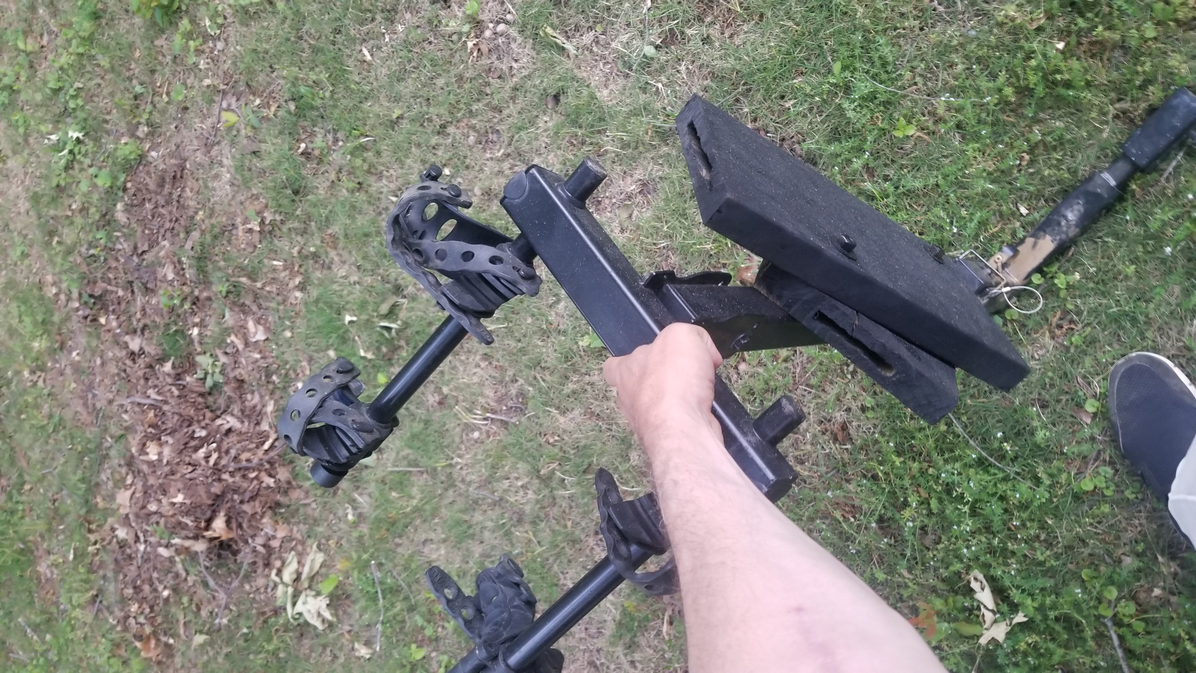

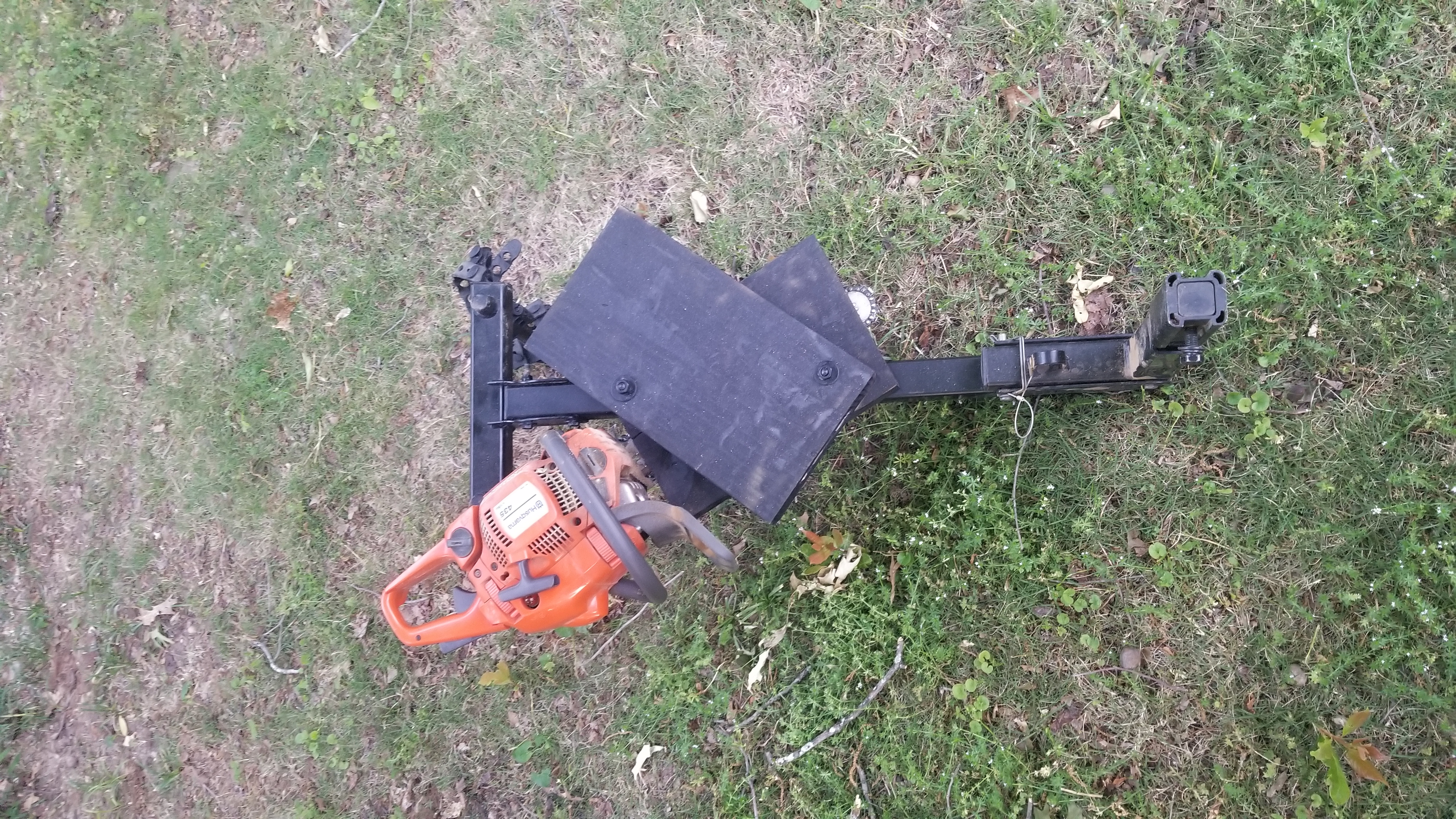

So I've seen no shortage of high dollar expensive chainsaw scabbards. Here is my solution. I use my bike rack that fits into a 2" receiver, which also doubles as my weed wacker holder when I'm driving around or in my tractor, and I bolt on a piece of pressure treated lumber that I've made a bore cut into with whatever chainsaw I will be carrying. These two are affixed to my rack and they hold my ms441 and my little husky simultaneously. I paint the lumber black so as to look better, and this is a solution that can be bolted onto four wheelers cars trucks etc. The lumber is really cheap in comparison to scabbards, and I make the bore cuts safely by clamping the wood in a vertical position onto something sturdy so I can plunge into the lumber and keep the cut aligned.

That looks cool! Got any pics of it attached to the tractor?
Thanks,

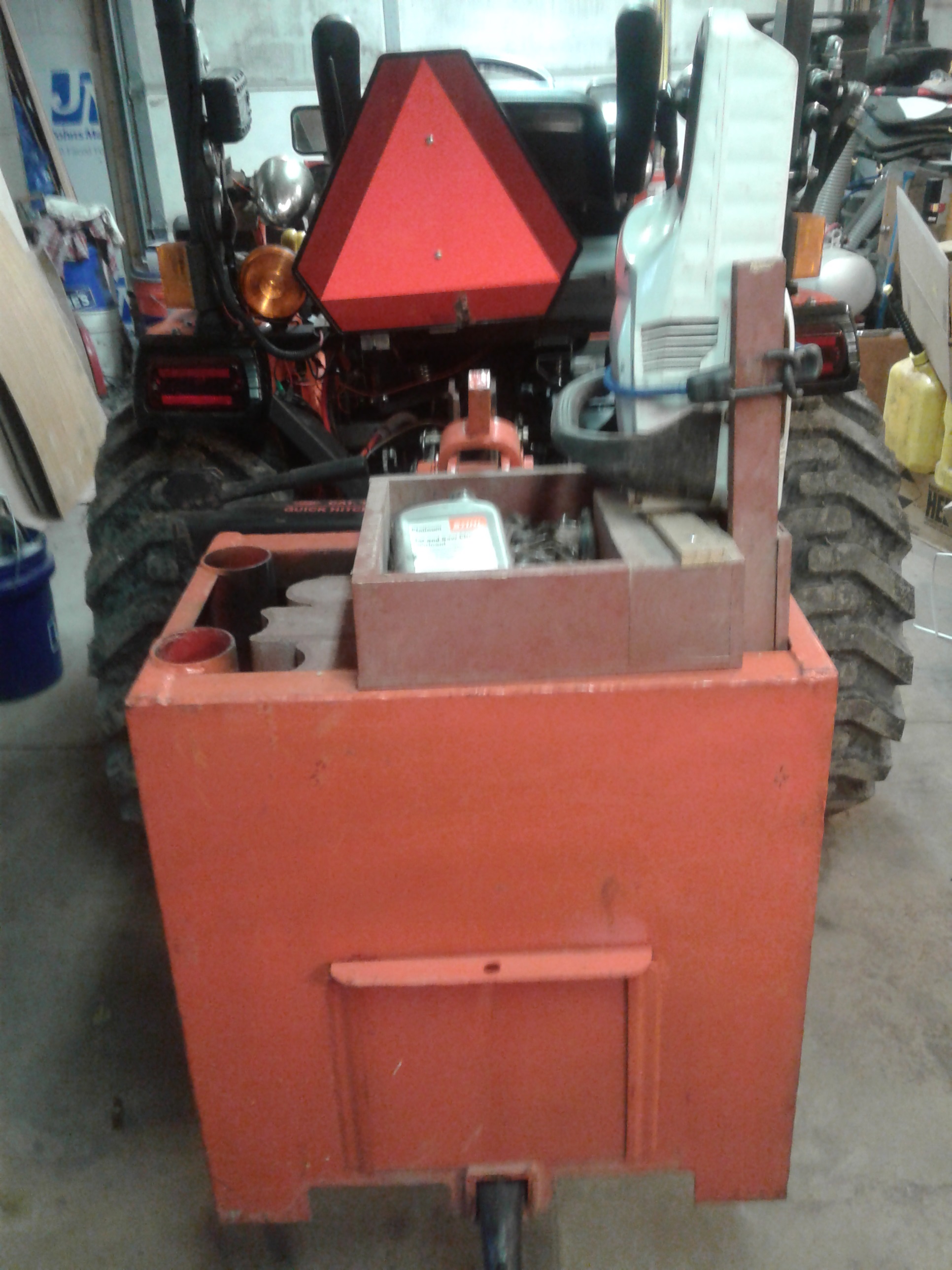

If I use chainsaw, I need the grapple, then I need the ballast box. I made a wooden box to store chainsaw in the ballast box. Odds of accidently running over it greatly diminished. Quite an exciting ride when saw falls out of bucket and front wheel "finds" it.

I put the 2" receiver in my ballast weight.

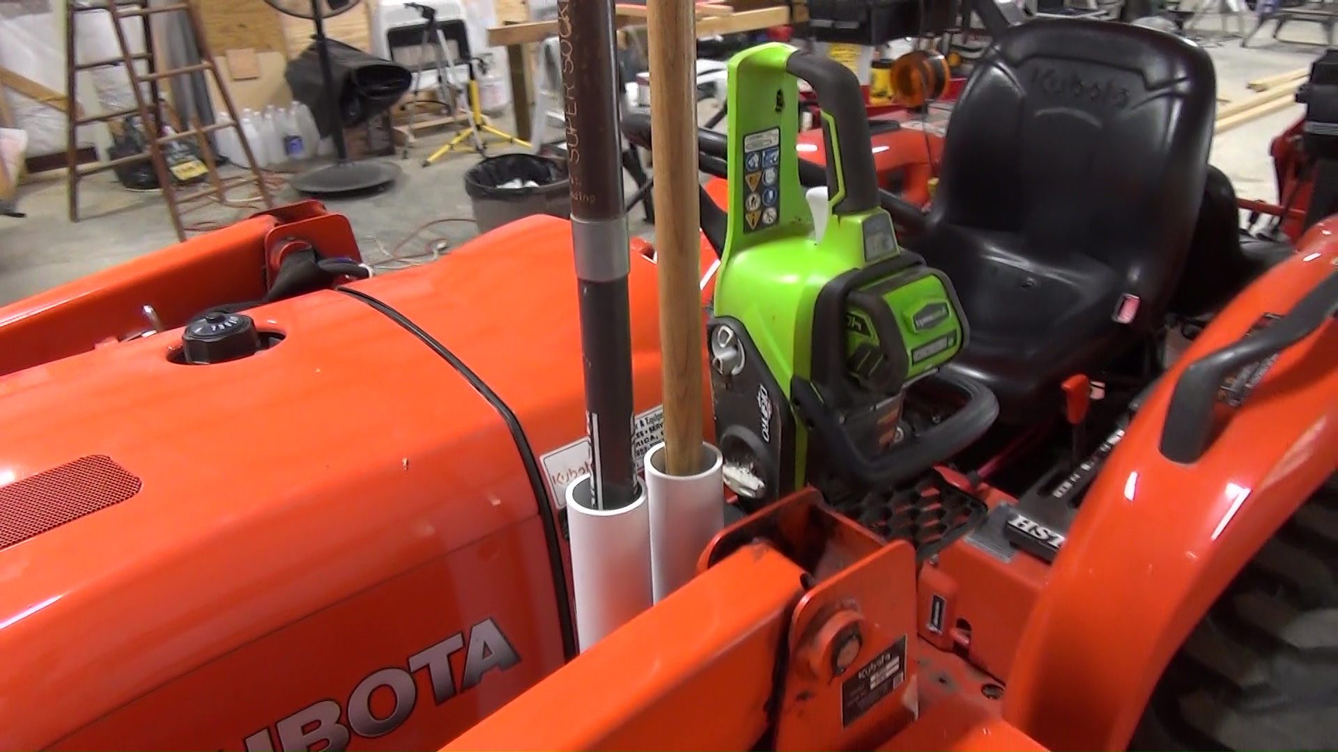

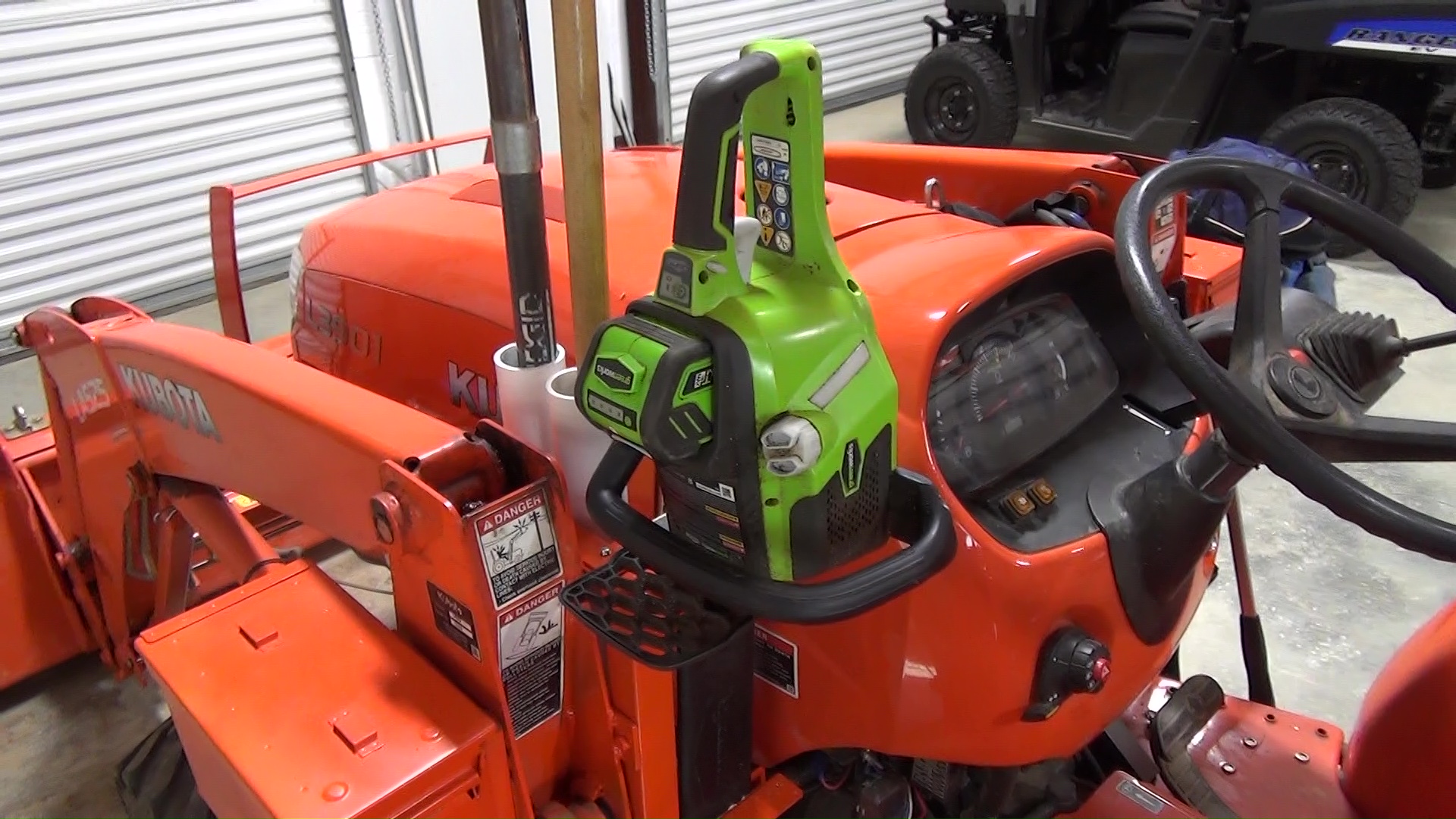

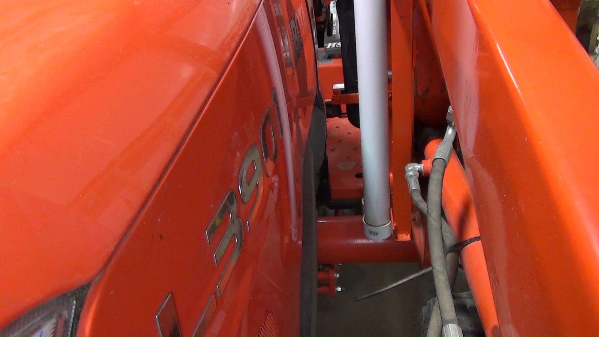

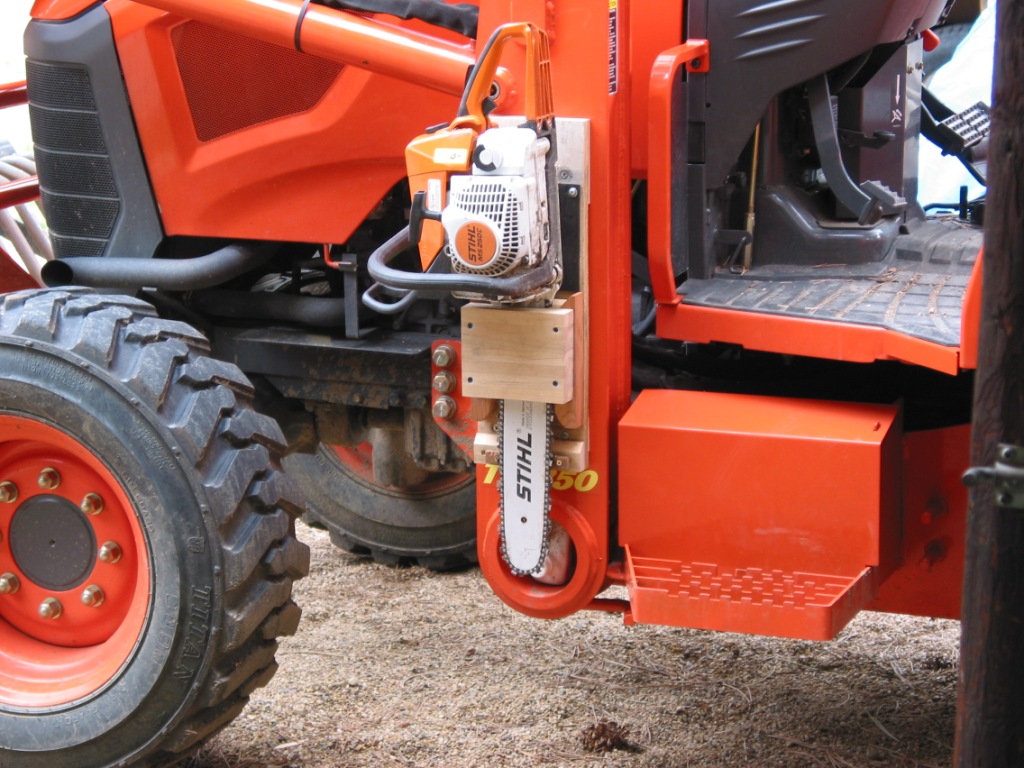

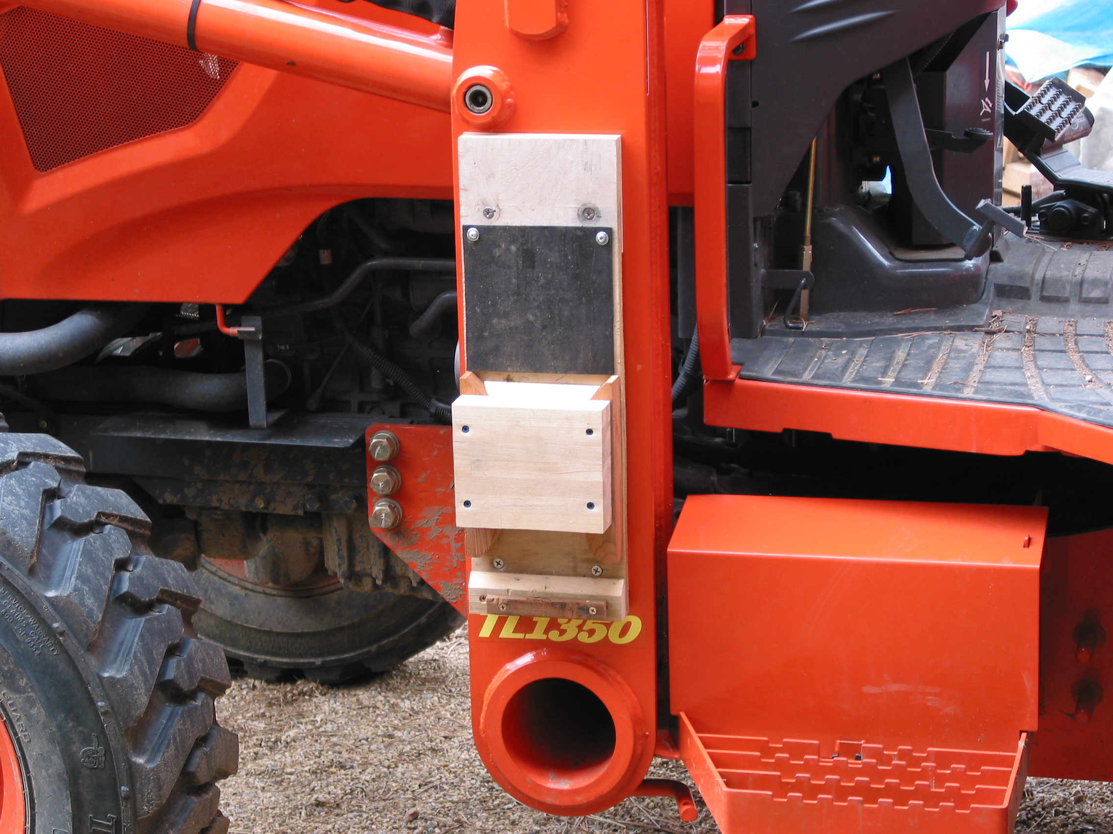

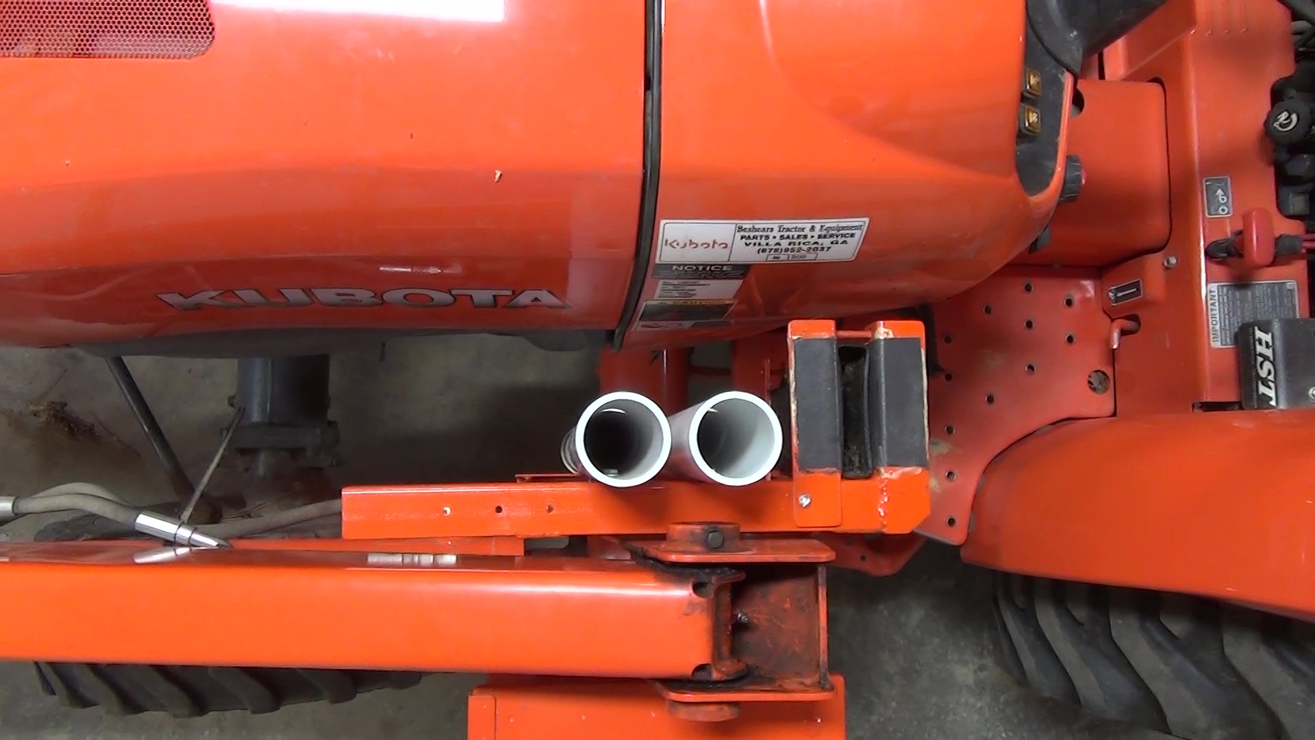

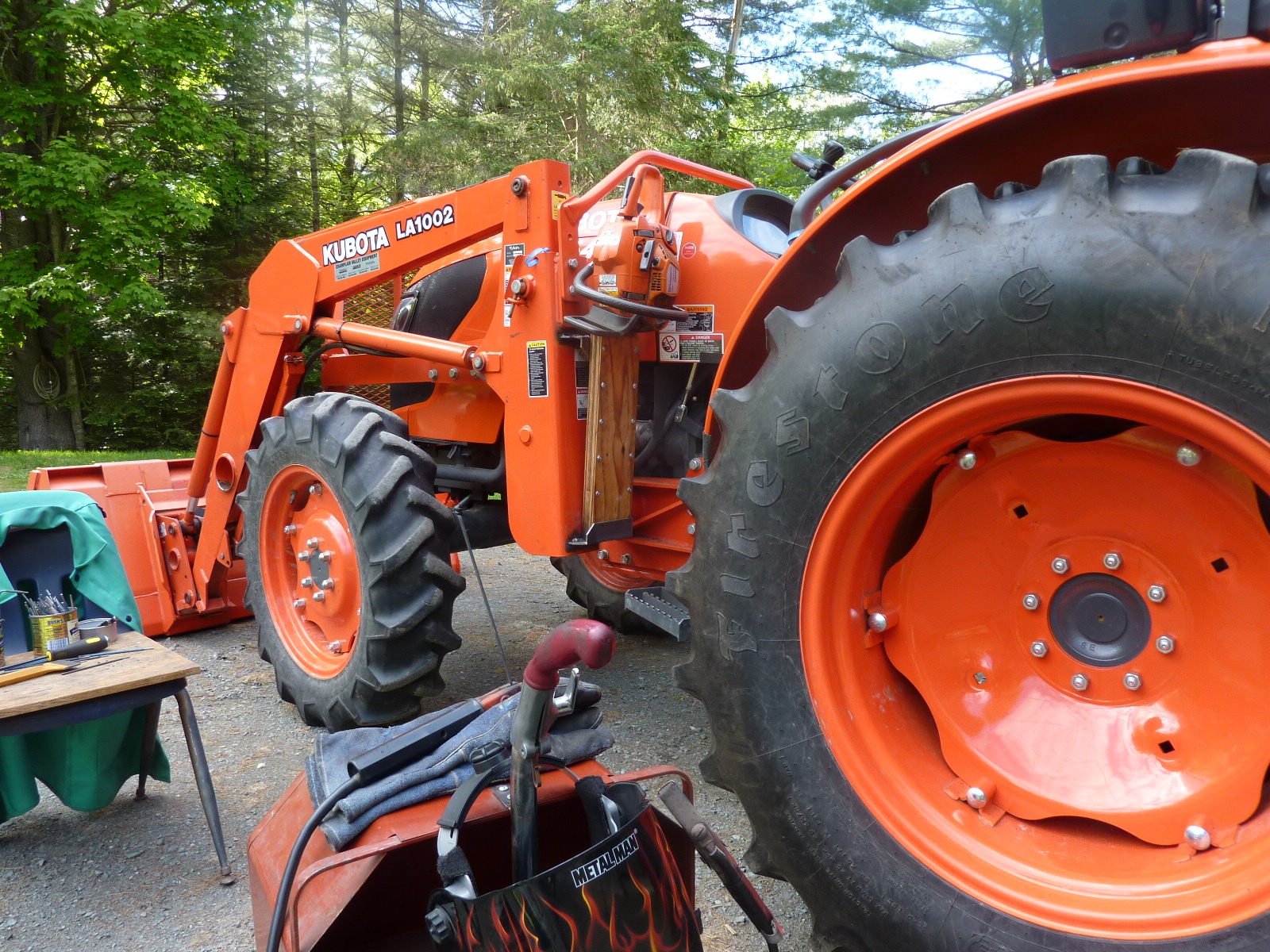

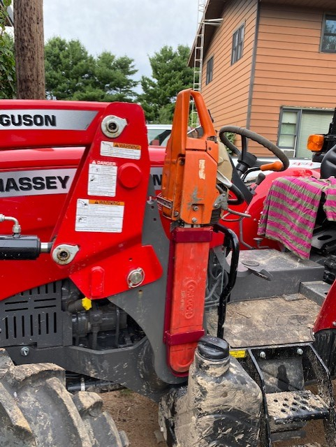

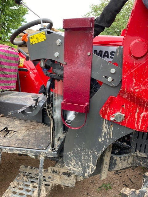

I recently built a removable chainsaw scabbard and tool holder that mounts on the inside of tractor FEL tower. Some pics are attached.
I had wanted to add a chainsaw scabbard to my tractor for long time, but my chain boxes took the most convenient spots for one. So I came up with another way that is working out really well.
If you're interested, I cover the dimensions and build details in a video.
This design should be fairly easy to adapt to other loader designs. Anyone with some angle iron and a welder handy should be able to make a version of it for their tractor.

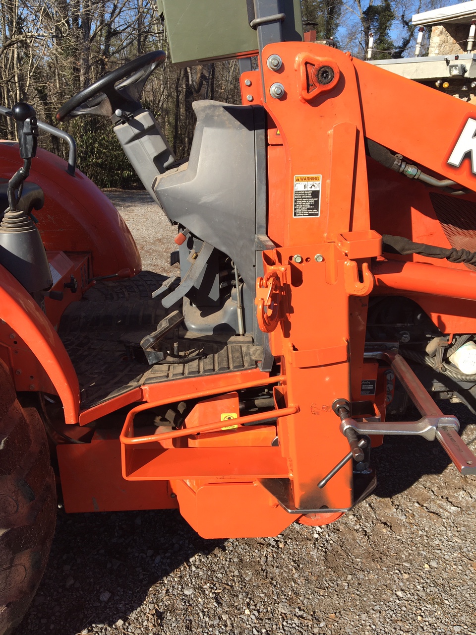

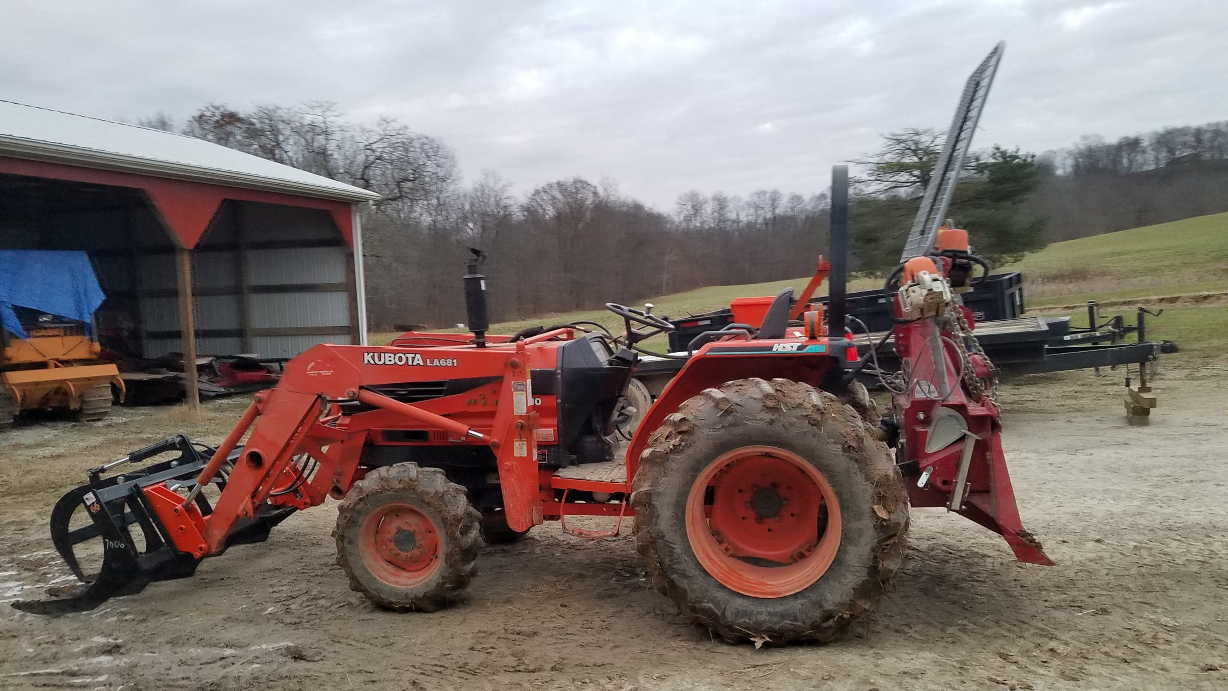

Cheap scrap pile tool, chain, chainsaw, gas/oil holder. Additional skid plates help protect tractor hydraulics too. Took time and effort up front but saves so much time and much safer now.

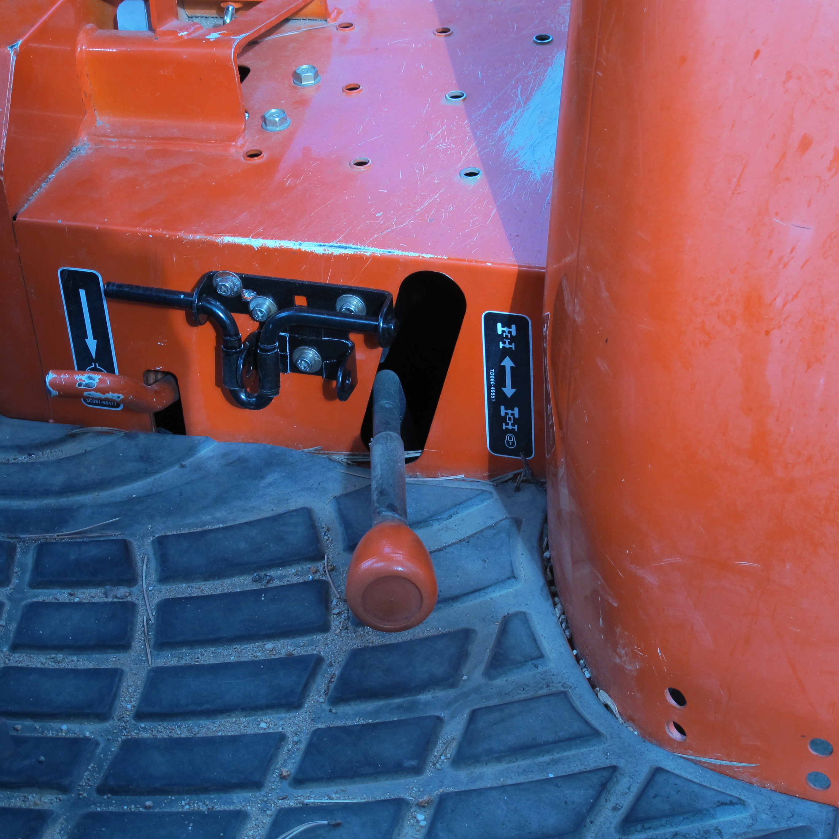

The most useful things I've put on the tractor are probably the 4wd lockout (made from a gate lock) and the little plastic MAIL toolbox on the backside of the backhoe control box. That Mail box was $1.00 at the doller general store. That would be a nice place to mount a nicer box, but that one works surprisingly well, sturdy, & stays dry.

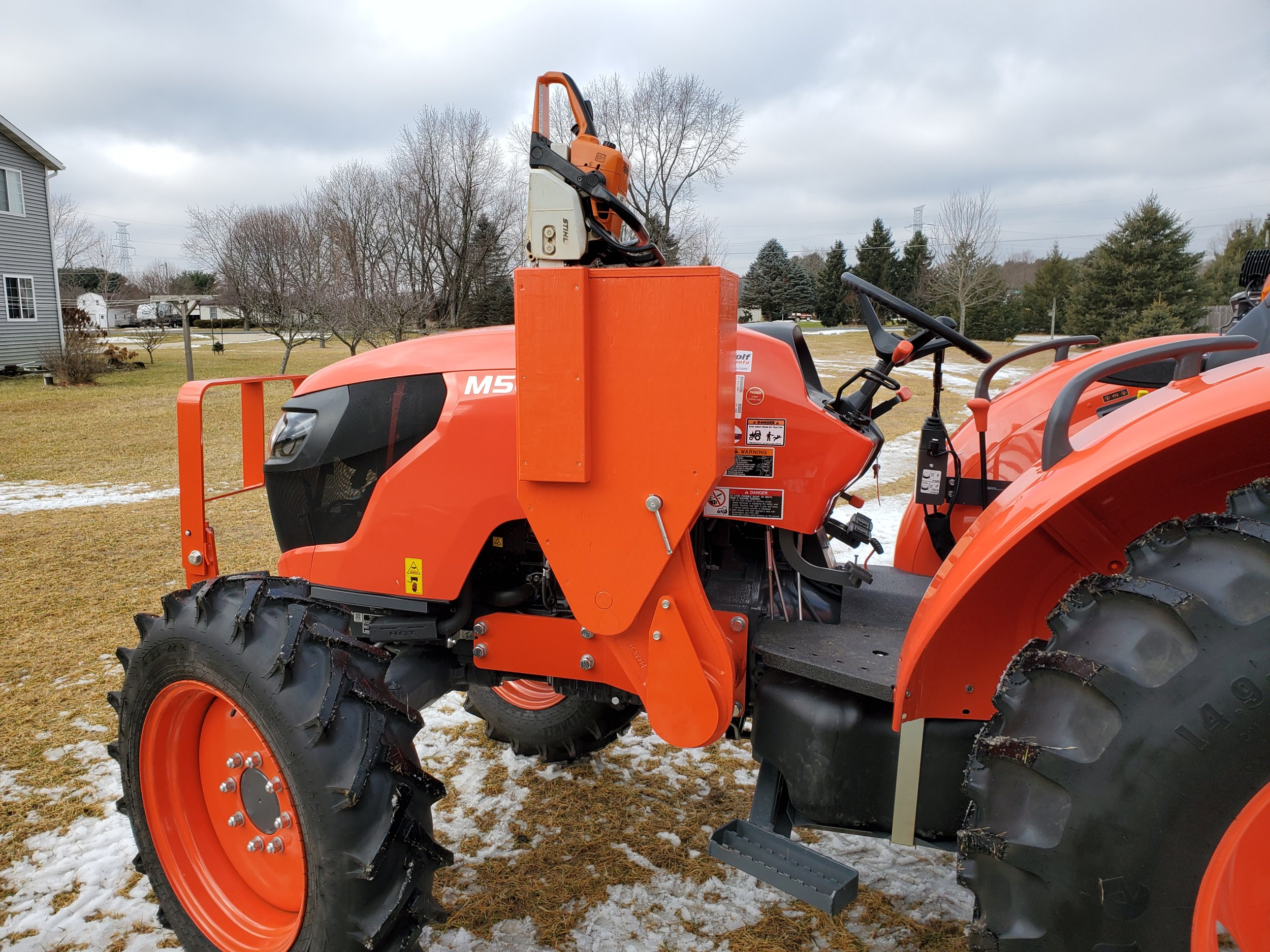

Here is my version of a homemade chainsaw scabbard, one for each side, I like to have an extra saw with me. The saws are both Husqvarna 61.

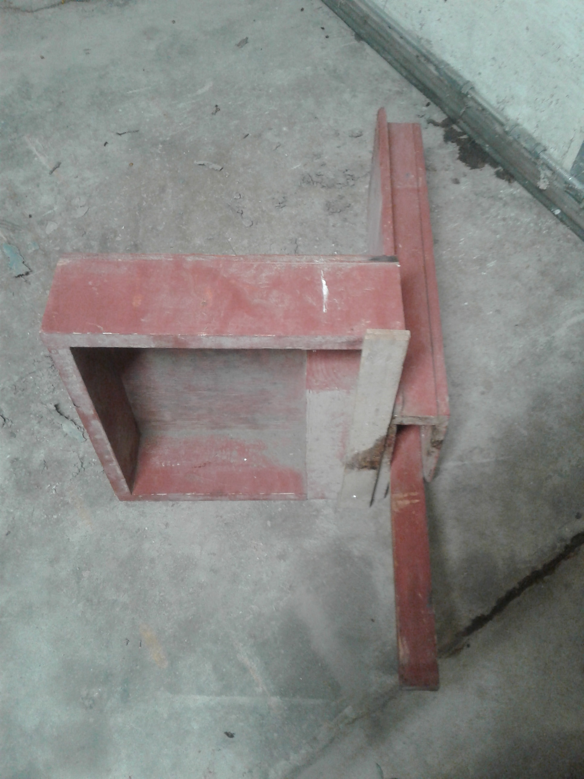

... I bolt on a piece of pressure treated lumber that I've made a bore cut into with whatever chainsaw I will be carrying. These two are affixed to my rack and they hold my ms441 and my little husky simultaneously. I paint the lumber black so as to look better, and this is a solution that can be bolted onto four wheelers cars trucks etc. The lumber is really cheap in comparison to scabbards, and I make the bore cuts safely by clamping the wood in a vertical position onto something sturdy so I can plunge into the lumber and keep the cut aligned.
I did the same for my first holder. I bore cut into plain 2x6. I did not use pressure treated, since most of that stuff is corrosive. (Though I suppose the chainsaw is not in there long enough to be a real issue.) It lasted for a couple of years before the board split. clamping it to one of the bars on my brush hog probably did not help it's longevity.
I think my next holster will be made out of some used plastic cutting boards: I'll cut two holster shaped side, and use smaller pieces as spacers along the edge. Just waiting for garage sale season to start up, so I can pick up the cutting boards cheaply.
I'm still debating about the best place to mount it. Hnging it off the outside of the FEL upright concerns me, since I often work in tight quarters in the woods and on uneven terrain. I'm afraid it will only be a matter of time until I smash my saw against something.
