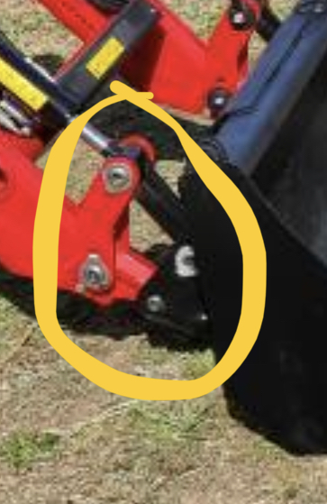

I disagree. It is NOT the bucket , it is the way the SSQA is attached/configured. Post #1 is certain to fail as shown regardless of the implement. Post # 4 cannot fail in this mode. He nails the problem in post # 15. My guess is the SSQAs are dealer installed options with Massey and the dealer having screwed it up is at fault.

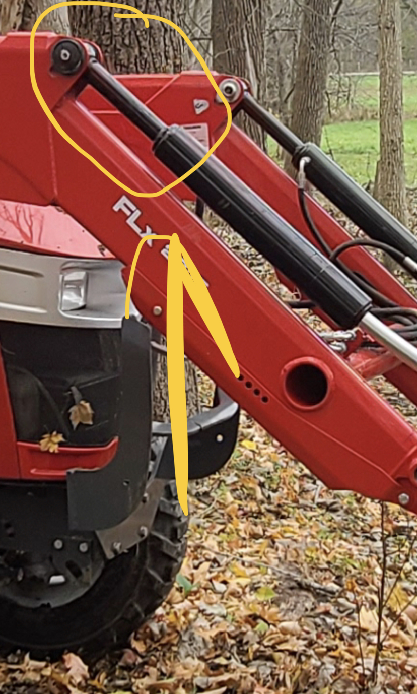

Oh so many things jumps out at me after seeing all the images…
Notice the holes… why are they unused?
When it should have these brackets in place like these…
Somebody screwed up at the dealership.
AMEN !!! Exactly. The problem is NOT the bucket nor does it matter what sort of bucket is attached ! The problem is the configuration of the SSQA adapter apparently installed without all the parts !!!! Complete and total screwup by the dealer OR by MF putting them out without the pivot levers.. or potentially even encouraging dealers to install them that way (!?) I'm sure once the matter is sorted out (with the AGCO regional rep being the referee -- and you need him into it NOW) the dealer has no choice but to apologize and make it right. Let him and the AGCO regional rep sort out which of them pays what because there may well be inadequate instructions and/or missing parts coming from AGCO to the dealer for the SSQA installation. Under no circumstance do you the buyer pay a dime.
Look at post #16 and the tractor for sale in Tractor House !! That one is misconfigured too ! So there are many of these out in the field about to bend cylinders and cost many people much grief. Someone needs to get hold of AGCO at a high level.
AND good holy crap, take a look at the YouTube from Vahrenberg at
which compares the older DL95 and the newer Xfl 1805. In their video the newer one has the DOOMED SSQA connection, omitting the pivot lever that we all saw in post #15. This disease is very widespread.
AND same disease showing in another Vahrenberg YouTube with the specific loader also in DOOMED configuration at
AND ... Sub-Compact & Compact Loaders notice here [in a factory webpage, not a dealer or a sale] that the pivot lever is in place. Also note that without the pivot lever the bucket cylinders at full dump are WAY further out and that is when they get bent.
I can't tell whose fault it is - dealer vs AGCO -- but right now no one in their right mind will operate that loader without the pivot lever.

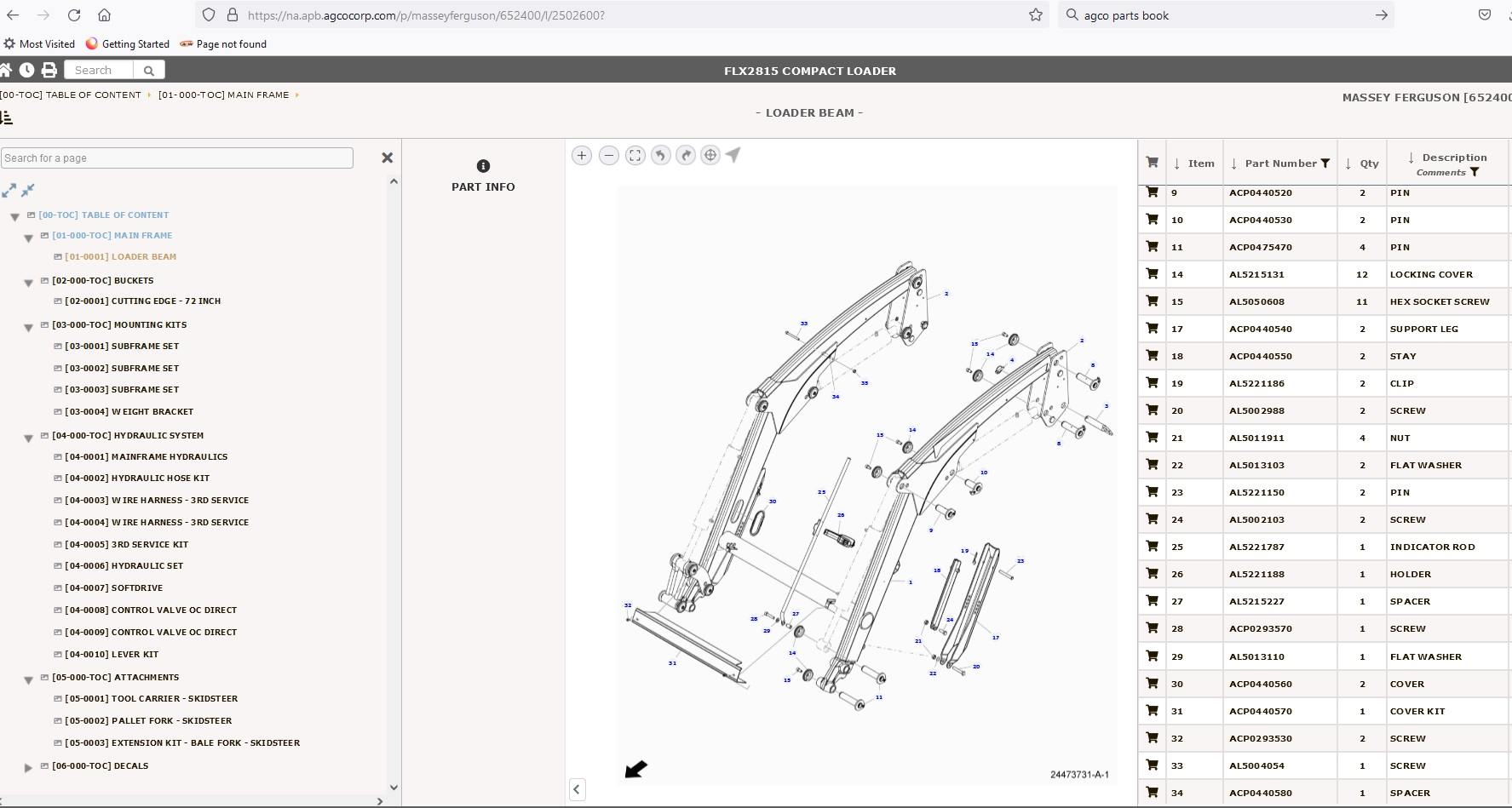

Pivots are missing according to parts diagram.
If those linkages parts were missing, the loader would be pretty much unusable due to the shorter length of the cylinders. For a setup without the linkages, the cylinders have to be extended to get some decent curl and dump angles, so that definitely came from factory like that.

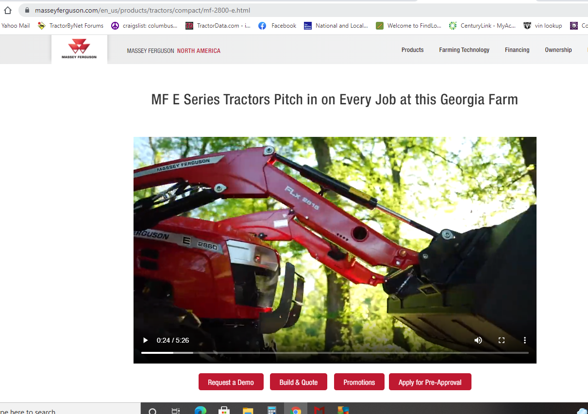

Ironic I cannot find ANYTHING on masseys site for the 2750/2760e.
But I did find this video on their website that can hopefully put to rest whether its missing parts or not.
The video....paused at both 0:24 and 3:39 both show a FLx2815 loader and it does NOT have the linkages.
As I have said before, some loaders have them, some dont. But regardless, the cylinders should NEVER be capable of column buckling under their own hydraulic force.
The ONLY think that should cause column buckling is an outside force GREATER than the hydraulic force they are capable of.
And example of that is with the loader dumped all the way and attempting to back drag with the cutting edge. We have all seen that on here a time or two. But it should NEVER happen under the loaders own power.
I have to wonder though.....in the video the OP posted, if the cylinders werent already bent from said activity. The LONGER bucket would compound the forces if used while dumped and backdragging. Requiring less effort/traction to make the cylinders bend. It dont matter if its a stock bucket, or a 4' stump bucket, or hell a 10' long bucket....it should NEVER happen under its own hydraulic power. But it DOES matter if you are using tractive power, and the bigger (longer) the bucket the easier it happens.
So if these cylinders in that video were already compromised.....THEN and ONLY THEN can I see the tractor being able to do that with hydraulic power alone.
Is the tractor owner a member here? CoTHg is this your tractor or someone you know? Can you direct him here....on a tractor forum where he may get more help than on a AR15 forum?
The following are the screenshots of the video on massey's own website showing no linkages or missing parts
