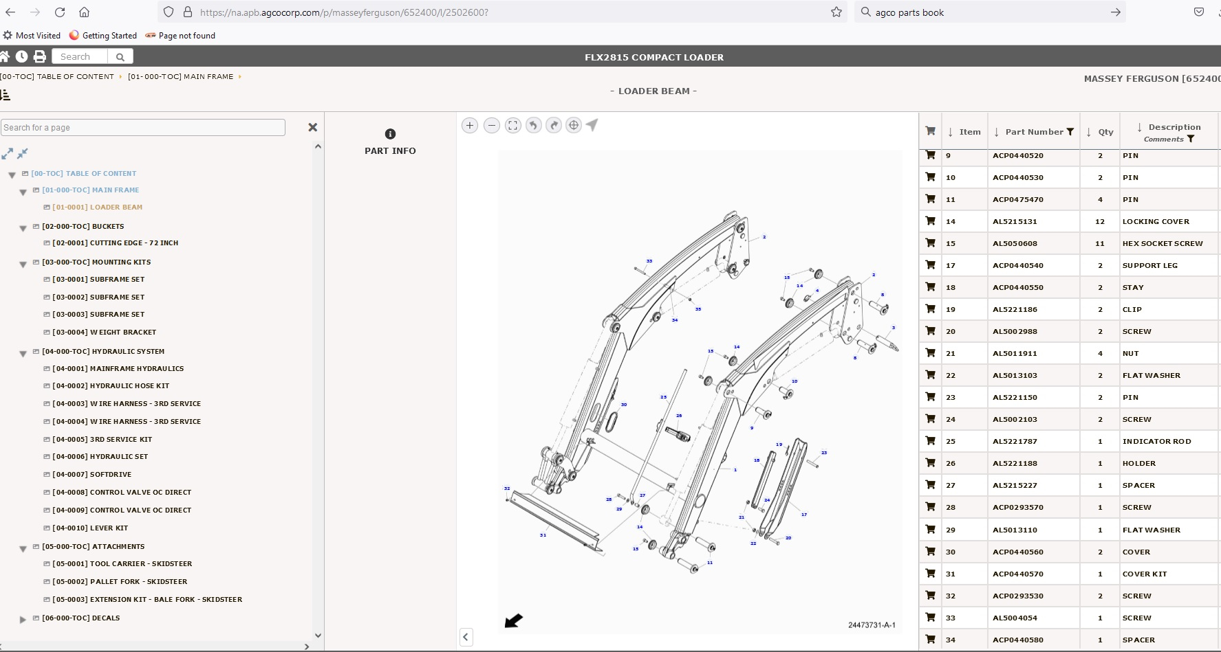

Pivots are missing according to parts diagram.
The diagram posted is for the "loader beam" according to the menu on the left. I don't see a choice for "Skid steer adapter" or something equivalent. That's what we'd really like to see. Even without that definitive diagram the one you show is pretty solid evidence that the pivot lever is expected to be in place. What is WILD is that there are so many at dealers, new, that show these loaders without the pivot levers. It appears that MF is delivering tractors to dealers in this DOOMED configuration without the pivot levers.

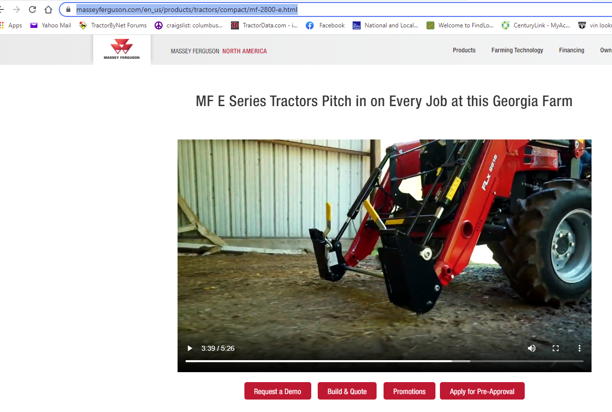

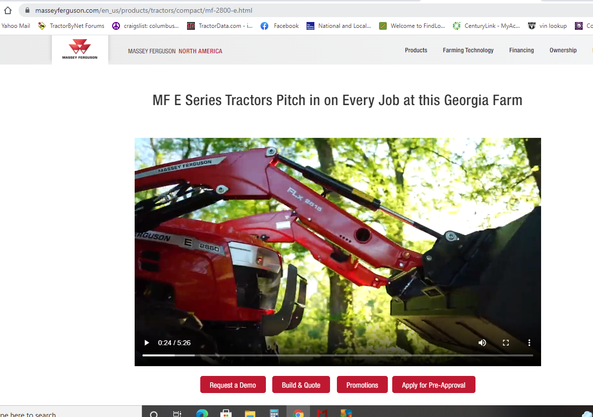

Ironic I cannot find ANYTHING on masseys site for the 2750/2760e.
But I did find this video on their website that can hopefully put to rest whether its missing parts or not.
The video....paused at both 0:24 and 3:39 both show a FLx2815 loader and it does NOT have the linkages.
As I have said before, some loaders have them, some dont. But regardless, the cylinders should NEVER be capable of column buckling under their own hydraulic force.
The ONLY think that should cause column buckling is an outside force GREATER than the hydraulic force they are capable of.
And example of that is with the loader dumped all the way and attempting to back drag with the cutting edge. We have all seen that on here a time or two. But it should NEVER happen under the loaders own power.
I have to wonder though.....in the video the OP posted, if the cylinders werent already bent from said activity. The LONGER bucket would compound the forces if used while dumped and backdragging. Requiring less effort/traction to make the cylinders bend. It dont matter if its a stock bucket, or a 4' stump bucket, or hell a 10' long bucket....it should NEVER happen under its own hydraulic power. But it DOES matter if you are using tractive power, and the bigger (longer) the bucket the easier it happens.
So if these cylinders in that video were already compromised.....THEN and ONLY THEN can I see the tractor being able to do that with hydraulic power alone.
Is the tractor owner a member here? CoTHg is this your tractor or someone you know? Can you direct him here....on a tractor forum where he may get more help than on a AR15 forum?
The following are the screenshots of the video on massey's own website showing no linkages or missing parts
Well, that nails one thing -- the guilty party is AGCO/MF manufacturer NOT the dealer. These failures will never occur if the pivot levers are in place and are doomed to eventually occur without those levers. It is the manufacturer's fault. LD1 has said that the "extra pivot levers don't matter" but they do. With the levers in place no force can be applied at any angle other than directly parallel to the cylinder. The application of force on the cylinders stays the same [parallelogram] regardless of dump or curl. Without the pivot levers the application of force varies all over the place depending on curl and dump. Crucially, with the levers in place the cylinder rods do not need to be extended an extra foot or worse out to where they are "spindly" and vulnerable to excess compression loading. You will never ever see bent rods on a loader that has the pivot levers in place.
