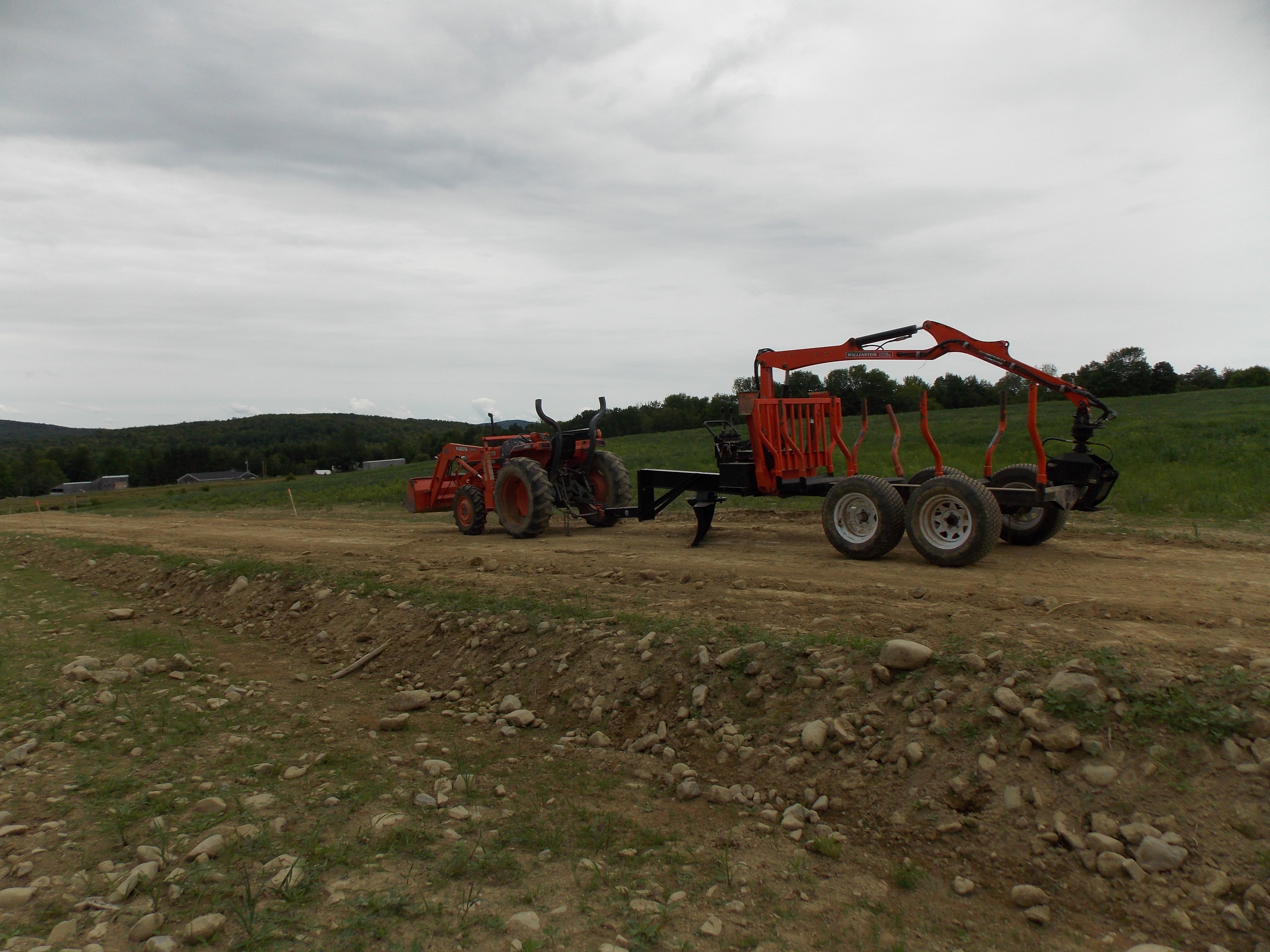

Redoing our road & driveway. Total 0.65 mi. Up in the Mtns in VT. Probably 200 of vertical gain over length of drive.
Two stepper. 3 of 1 1/2 clean stone then 3 of 3/4 crusher run/stay mat/ plant mix/ crushed ledge or whatever they call it in your area.
Have always maintained the road with tractor & box blade with very good results. This week, not so much.
Have tried the box blade. Have tried a rear blade with 3 way hydraulics. Both heavy duty. Box blade is a Frontier 8 heavy fury with scarifies. Blade also Frontier 8 HD. Has been miserable. No matter what I try regarding draft control & depth control, am getting terrible wash boarding and scalloping. Beginning to think that these are just the wrong tools for the job.
Have been able to fix things with excavator bucket work, but a long slog.
Are three the wrong tools and should I just blade in the material with a dozer, or am I doing something wrong or is the 1 1/2 stone just tough to work with?

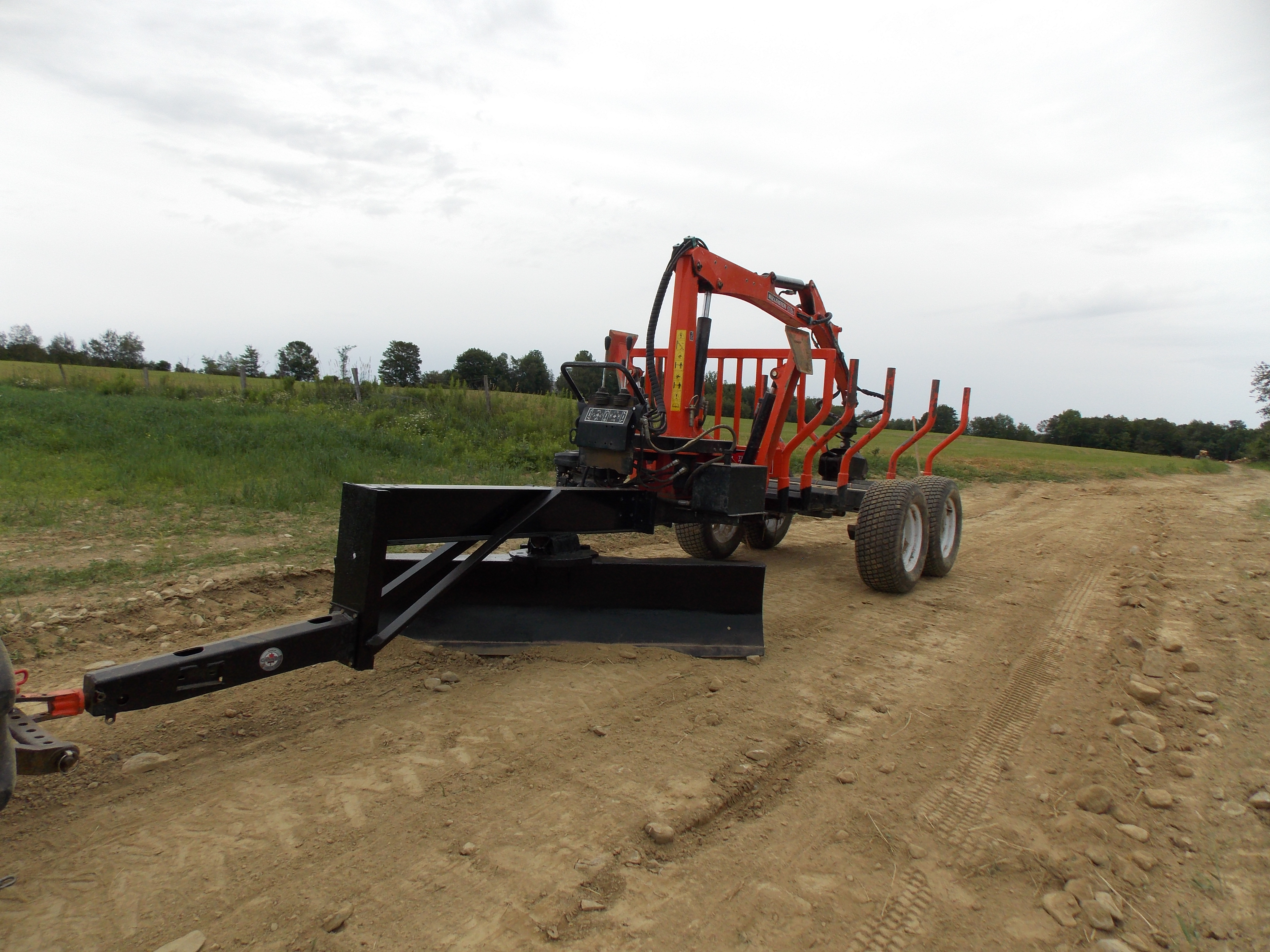

You are using the wrong tool for the job. I had this same problem when building a road and fixed the problem pretty easily.
As you are finding out, with a three point hitch everything is exaggerated because it is cantilevered off the back of the tractor. When you go into a hole with your rear tire, the rear blade is driven deeper in even further back, so now instead of having one hole, you have two. And when the rear tire goes over a hummock, the three point hitch blade goes even higher, adding a second hump that was not there before.
Tons of passes, using draft-control, and float position helps, but it is just not really good enough.
You need a pull behind grader blade. The longer the better. That is because the exact opposite happens with these devices. Because the blade is located half way between the rear wheel of the tractor, and the rear wheels of the tow-behind grader, when the rear tire of the tractor goes into a hole, the blade moves only HALF the distance. The same thing happens when going over a hummock, the blade only raises half the distance. This means you get a very flat surface.
For even better surfacing, you want a walking beam suspension on the tow behind grader. That is because, with a single axle, if the wheels hit a depression, or hits a rock, it will move the blade. It is only half the distance, but still moves the blade. With a walking beam suspension, the wheels pivot over the obstruction without causing blade movement.
All the reasons I listed you see on a modern grader. They are LONG to get a nice level surface front to back, and they have walking beam rear suspensions.
With my grader blade it takes only two passes to get an absolutely flat road. The first takes out the major dips and lumps, and the second pass irons it out perfectly flat. Fortunately they are quick and cheap to build homemade, and they are an absolute dream for plowing slow on long drives. Kick the tractor in 6 gear and GO! Getting double duty out of them makes them a worthwhile investment.

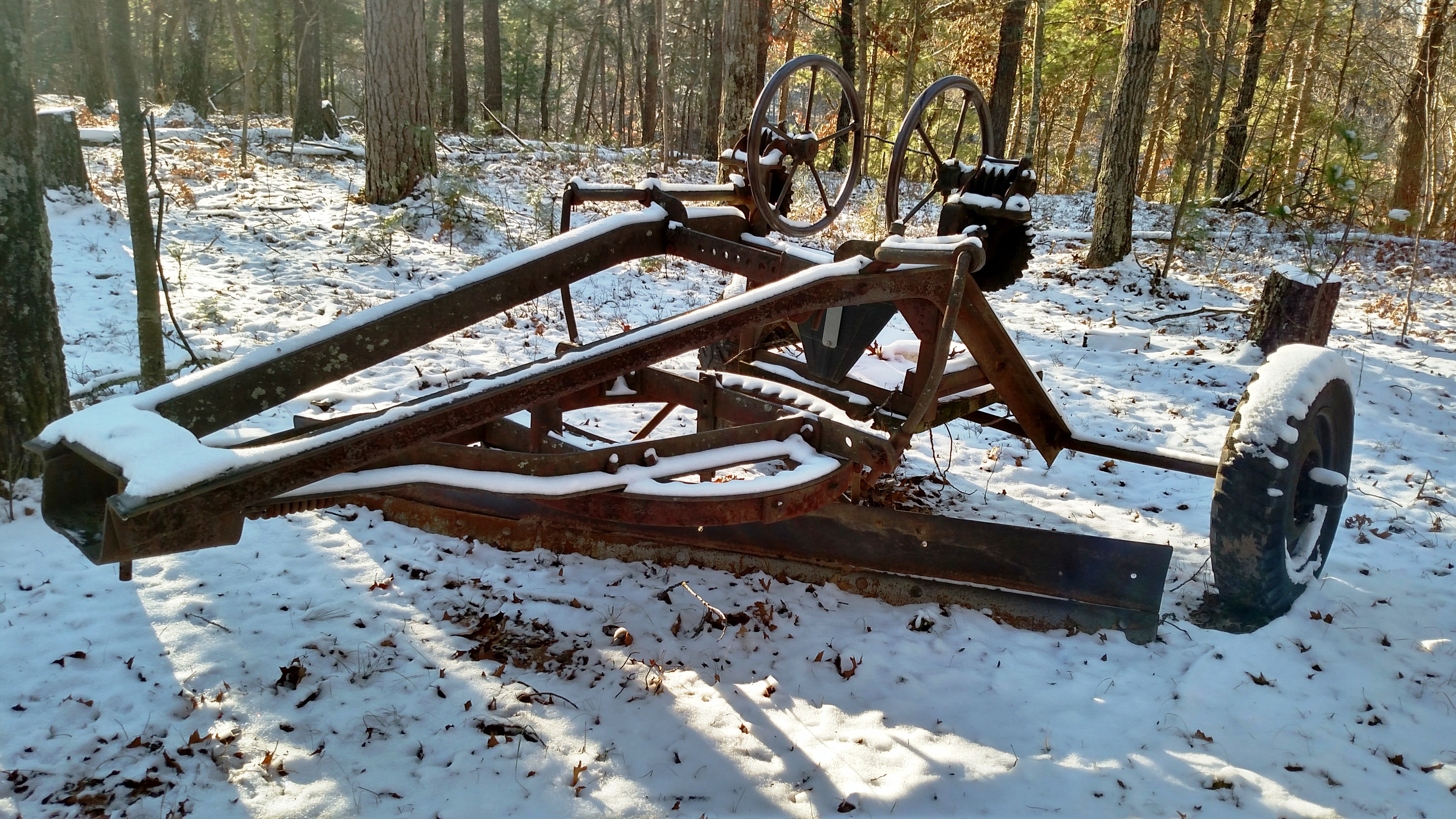

On my 1/2 mile road, every spring, I use the scarifiers on my box blade to chew up the gravel around the potholes that developed during the spring thaw.
Then I use my horse grader to restore the crown and do any contouring/ditching. The long wheelbase gets rid of any hoops and hollows. This is my most useful driveway tool.
Nice grader!
I think my next tractor purchase will be a grader, but the kind the highway departments use. I can see a lot of use with one. Kind of out of the scope of this conversation, but I also like yours as well.
