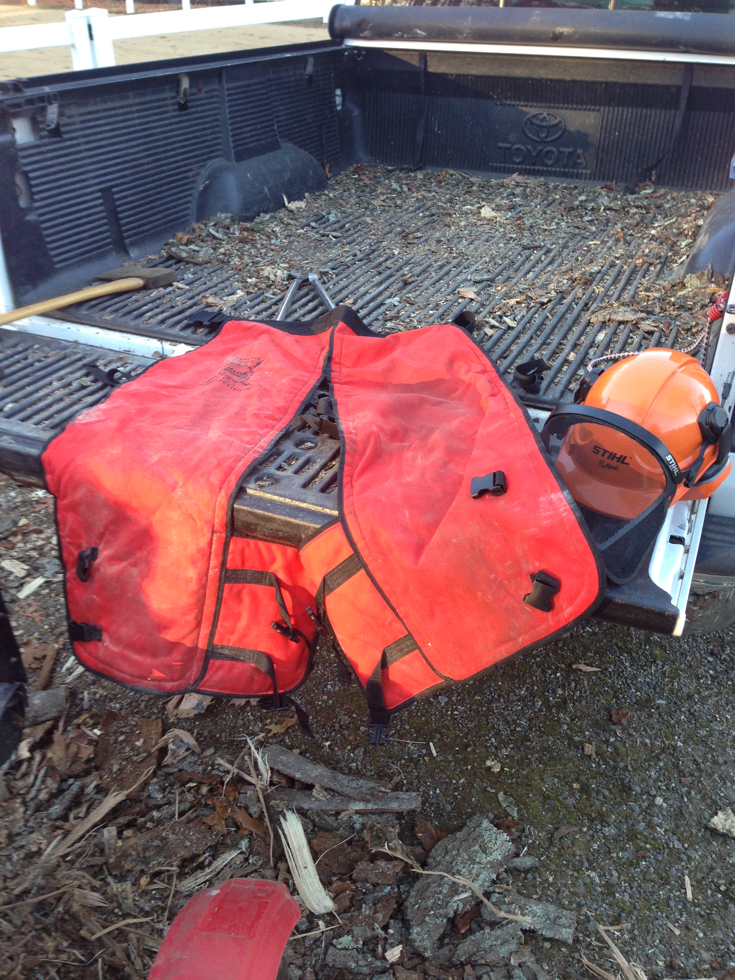

I researched the various brands awhile back and ended up going with Labonville chaps which are excellent quality and worth every penny. As stated, the ratings are more important than brand IMO. It is really the number of layers of the material that makes the difference. I went with the thickest Labonville carries, the "competition" grade. They also cover my calves, which was a must have for me.
As far as the helmet and face shield go, I recommend going with a face shield made of wire mesh vs. plastic. Much better for ventilation and no fogging. I had the plastic and ultimately traded up. I wear safety glasses with them as well. Mine is a Stihl. The helmet comes in handy when a branch flies back or for widowmakers. I also use it when using the wood chipper, and it is invaluable in that regard.
