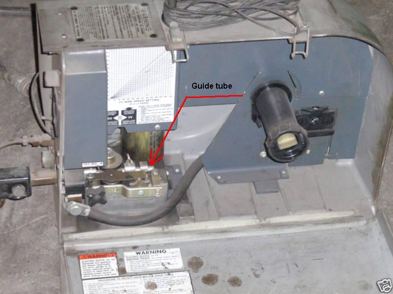

Another thing that will cause bird nesting, is too big of a gap between the drive rolls, and the gun. I'm not familiar with the Handler 140 at all, so I don't know if you can adjust the guide tubes or not. Maybe as simple as jamming the gun in further. I always try to have the gun / guide tubes as close to the drive rolls as possible, especially with soft / small diameter wire.

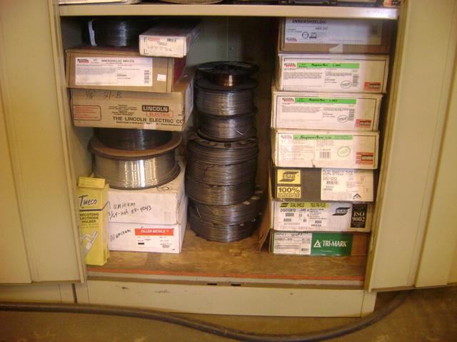

Been so long I had to go back out to the shop to make sure.:laughing:
Hobart's Fabshield 21-B has a lube, but not near as heavy as Lincoln's wire.

/ Changing liner in a mig gun ? ? ? #17
Do you always use name brand wire, and is there a really big difference?
/ Changing liner in a mig gun ? ? ? #18
You know, I never really thought about it! But looking at that cabinet of wire I guess I do. Few days ago I went to the welding supply, asked for a roll of Lincoln .045 L-56 wire, (love that stuff). They no longer carry Lincoln! Sold me a roll of some wire, but I can't remember the name. Just went out to look, no name on the box, so it must be a no name brand:laughing:. Haven't tried it yet, but the salesman, (known him for 25-years) says everyone likes it better than the L-56.:confused3:
