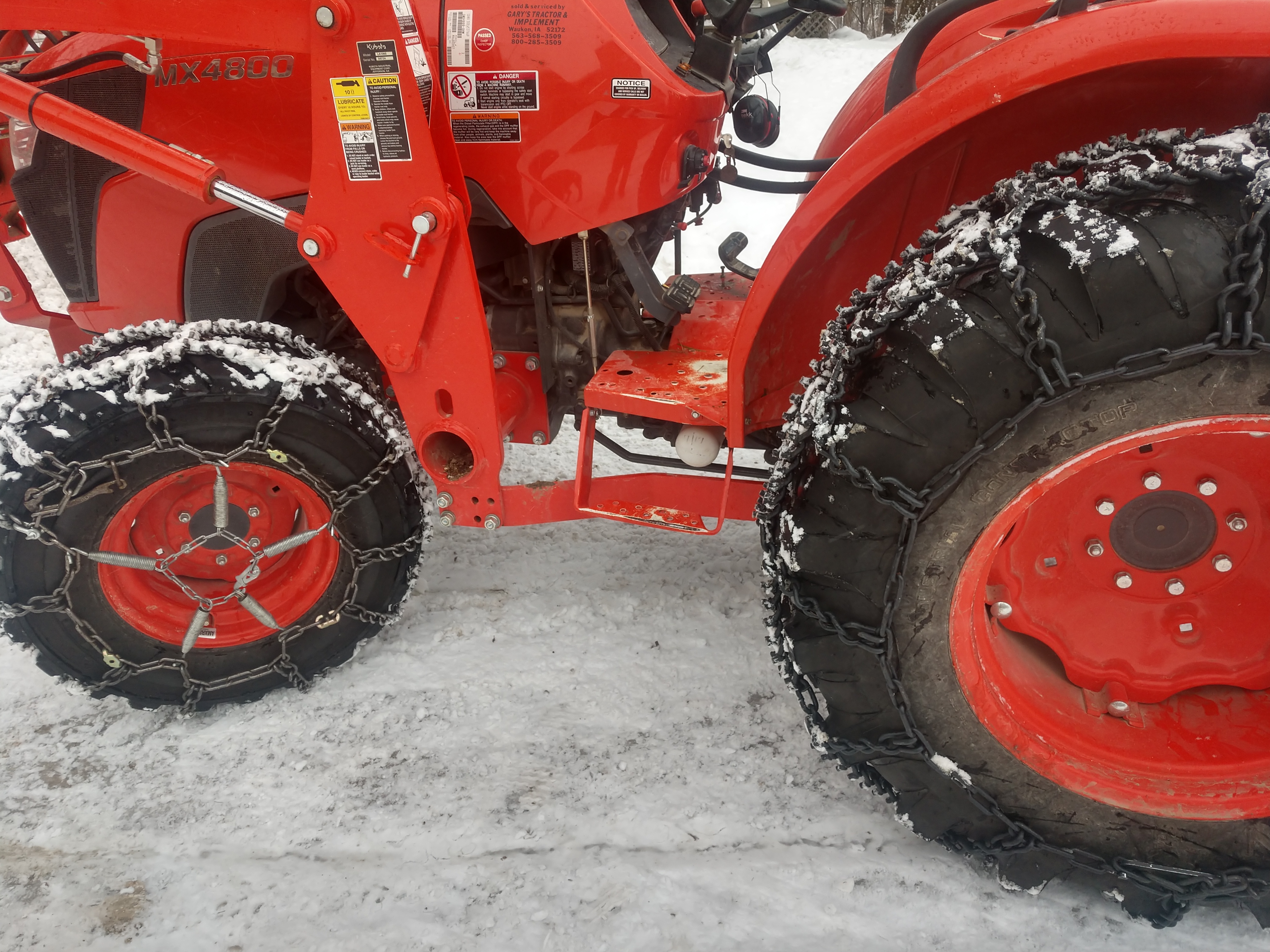

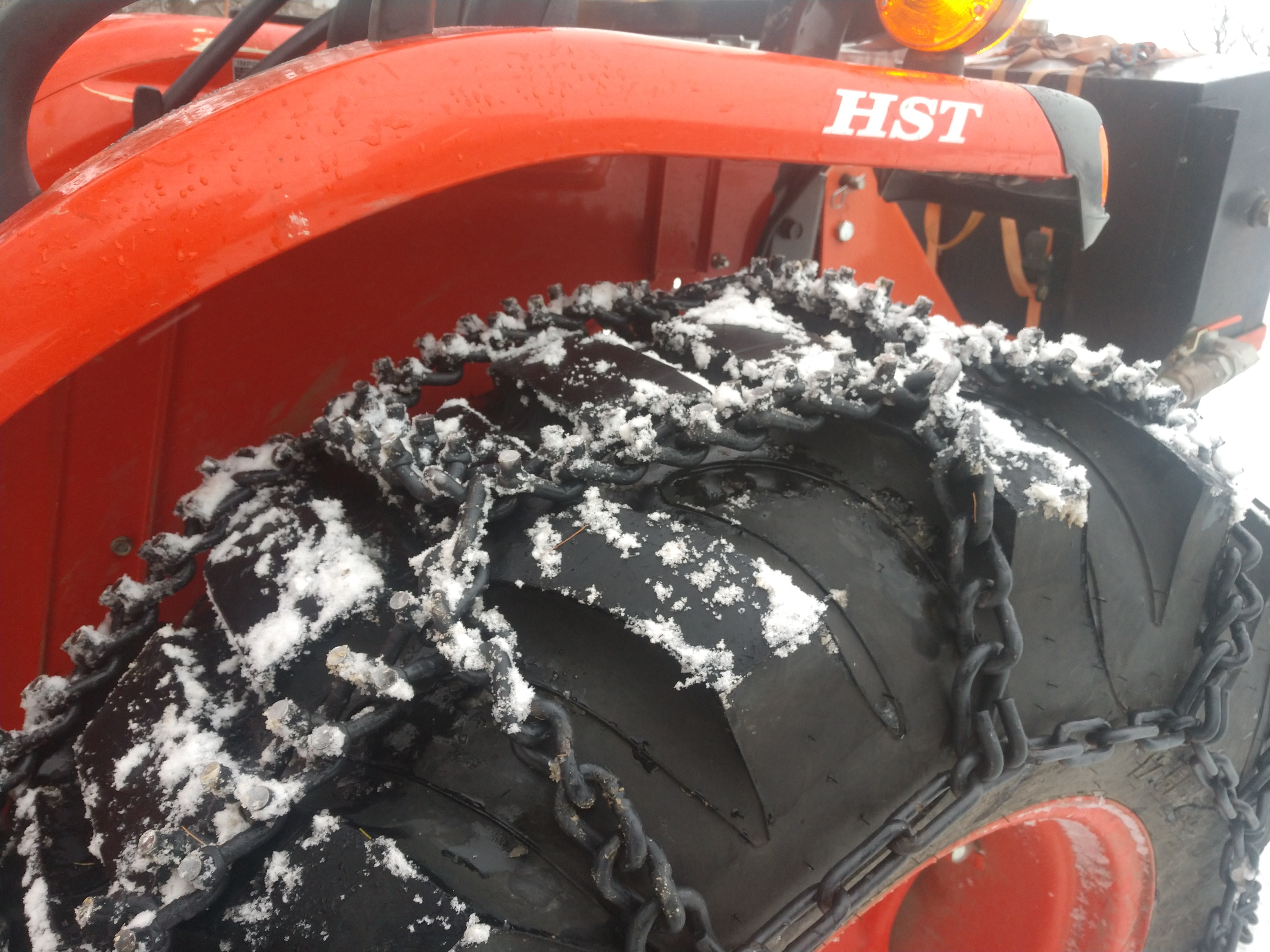

Chains came in today. The went on quite easily.... after I figured out the split link LOL. That being said, they are a full section long. Others have said the same thing. Too long is better than too short! They worked great... traction out of this world!!! I was told that chain tensioners are not required. I ordered them anyway... they came in on UPS after I put the tractor was put away.

View attachment 639524View attachment 639526
Very nice!!!
You don't need tensioners on the rear chains because they are properly installed. You definitely need tensioners on the front chains because they are not. :)
I can't imagine how you could ever need more traction than you have now!!!

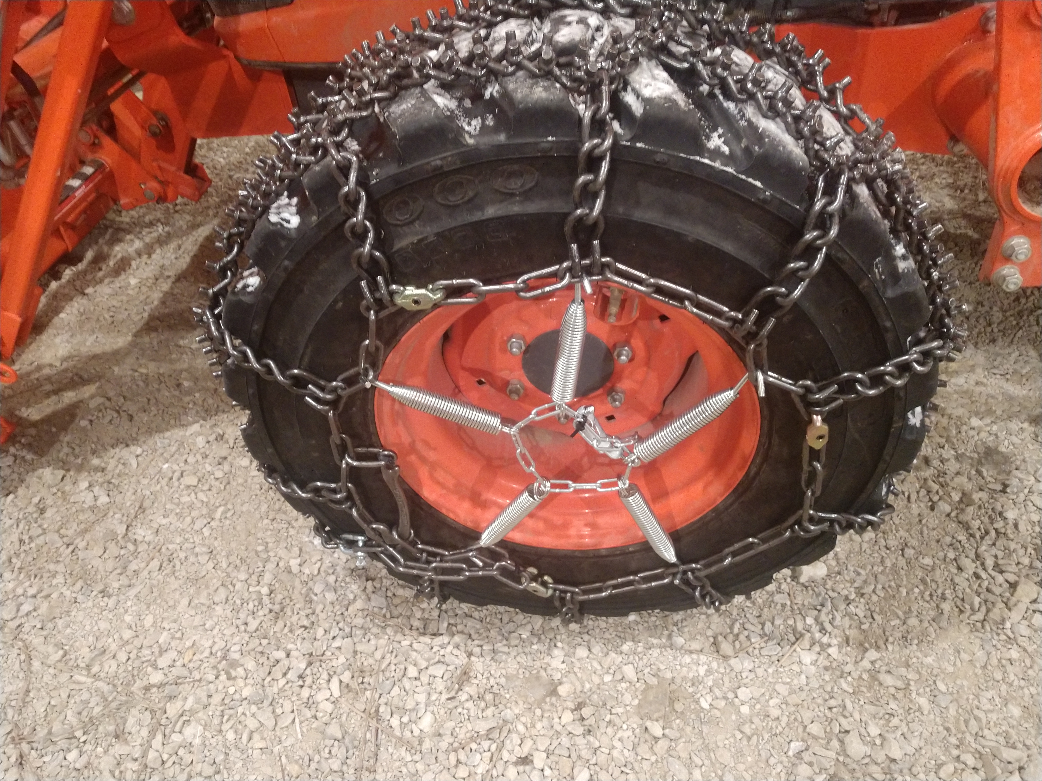

I have run two kinds of 2 link ladder chains on turf tires.. Both V bar and non V bar.. The plain cross links worked well, the V bar works better..
I got the plain set from John Deere, which fit fine the first use.. The V bar set came from a custom maker who works with lots of logging and mining equipment.. They fit well also..
It is always best to use tighteners on any kind of chain set.. I have had a lot of trouble with bungee and all types of rubber tarp tighteners and chain tighteners.. They seem to want to break and the pieces fly past you head.. My best luck has been with homemade tighteners made from a spring, light chain and S hooks..
