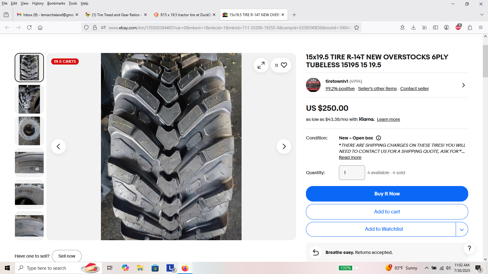

The quote that I have for the 1E.25 shows R15 x 19.5 6. It doesn't specify, but I'm guessing R4. The "6" is the number of plys? Would I be able to swap these R14 which are also R15 x 19.5? Maybe the circumference is different which could cause problems? I'm used to car tires, where you tell the dealer the size that you have and can buy all season or snow treads etc.
Interesting MF seems to enjoy making it hard to find out the tire size being used on the small tractors.
That said an R15x19.5 is available as an R14;
If you are able to find R14's in the same sizes as the tires on the tractor your lead/lag ratio should be good.
When I look at MF 1E.25's on tractor house they seem split between R14's and R4's
Pardon Our Interruption
My Kioti CK 2620 had these sized radial R14's on her 27-8.5-15 fronts and 15-19.5, the rears when filled with beet juice added 330 pounds each supposedly.

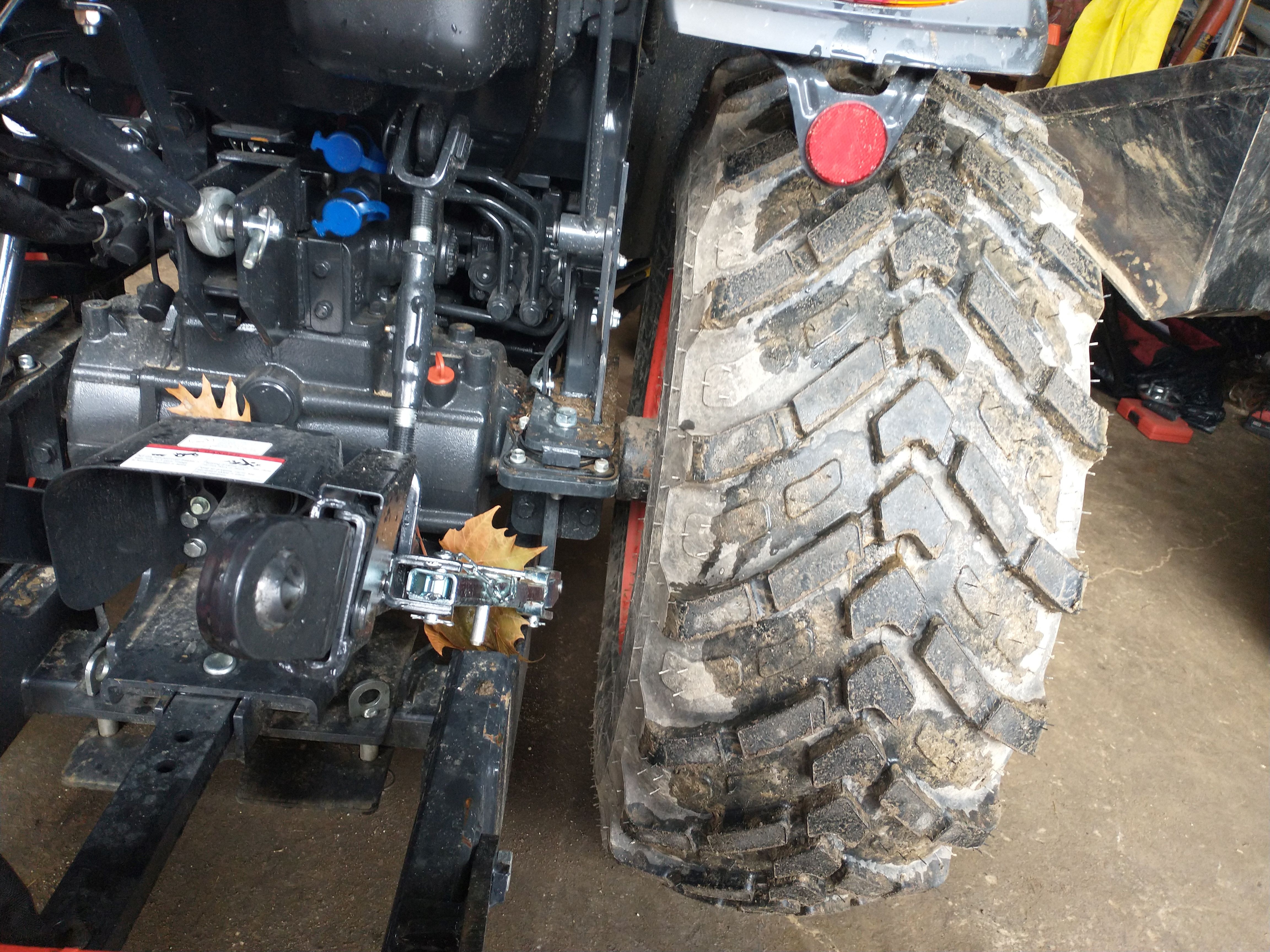

I have absolutely no use for R4 tires, they have never favorably impressed me once they get off hard dry pavement. I have used R1 almost all of the time. That said the R14's on my little Kioti have impressed me with their capabilities. They work very well in snow untill you do spin them and pack it into ice, then you had better hope you can back out of that spot and get back on fresh unpacked snow. R1's will work about the same very good intill they break out and spin and make ice.
The rear r14's, I did have too add spacers to have clearance for my chains,
before...................................................................after

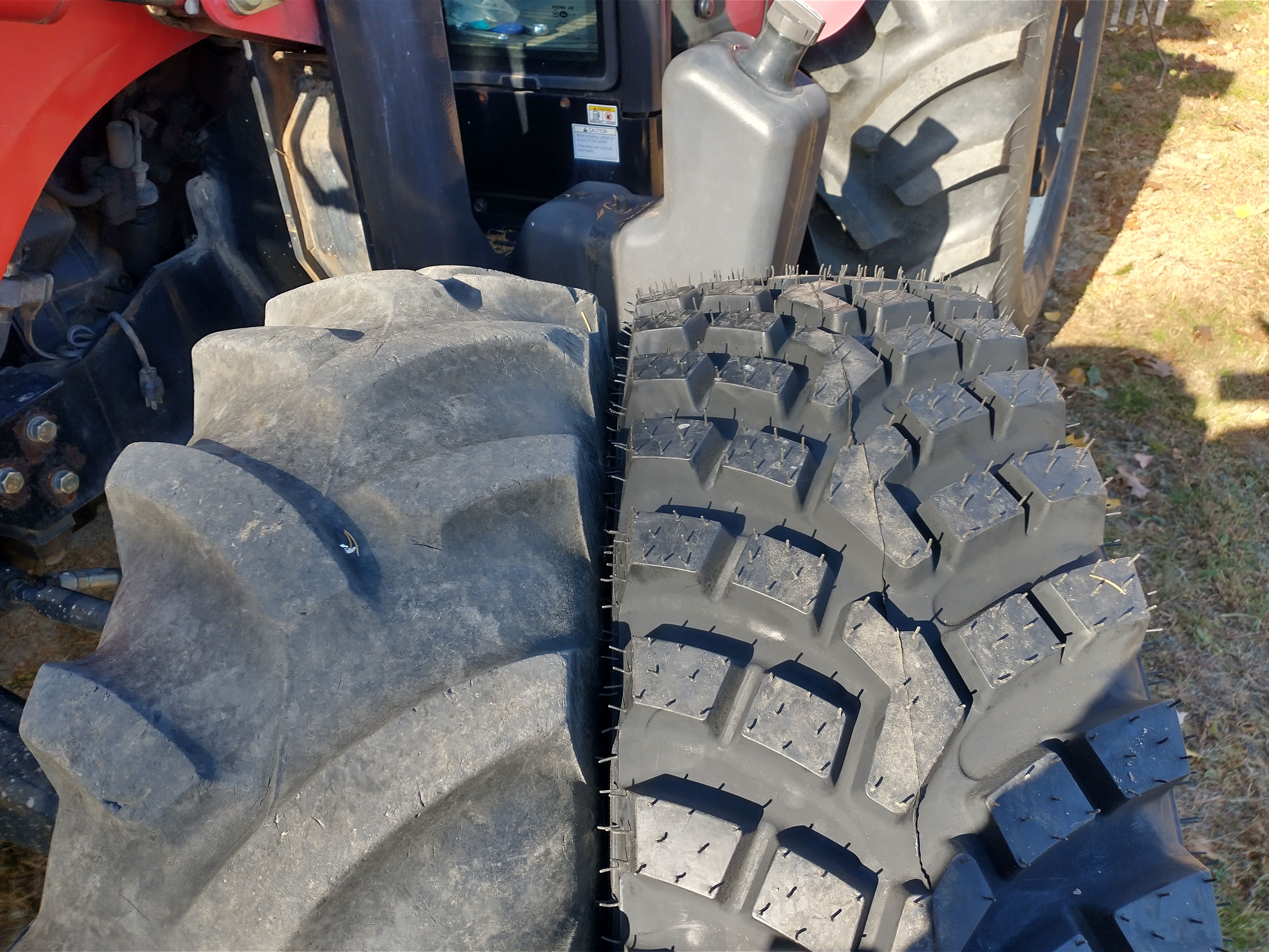

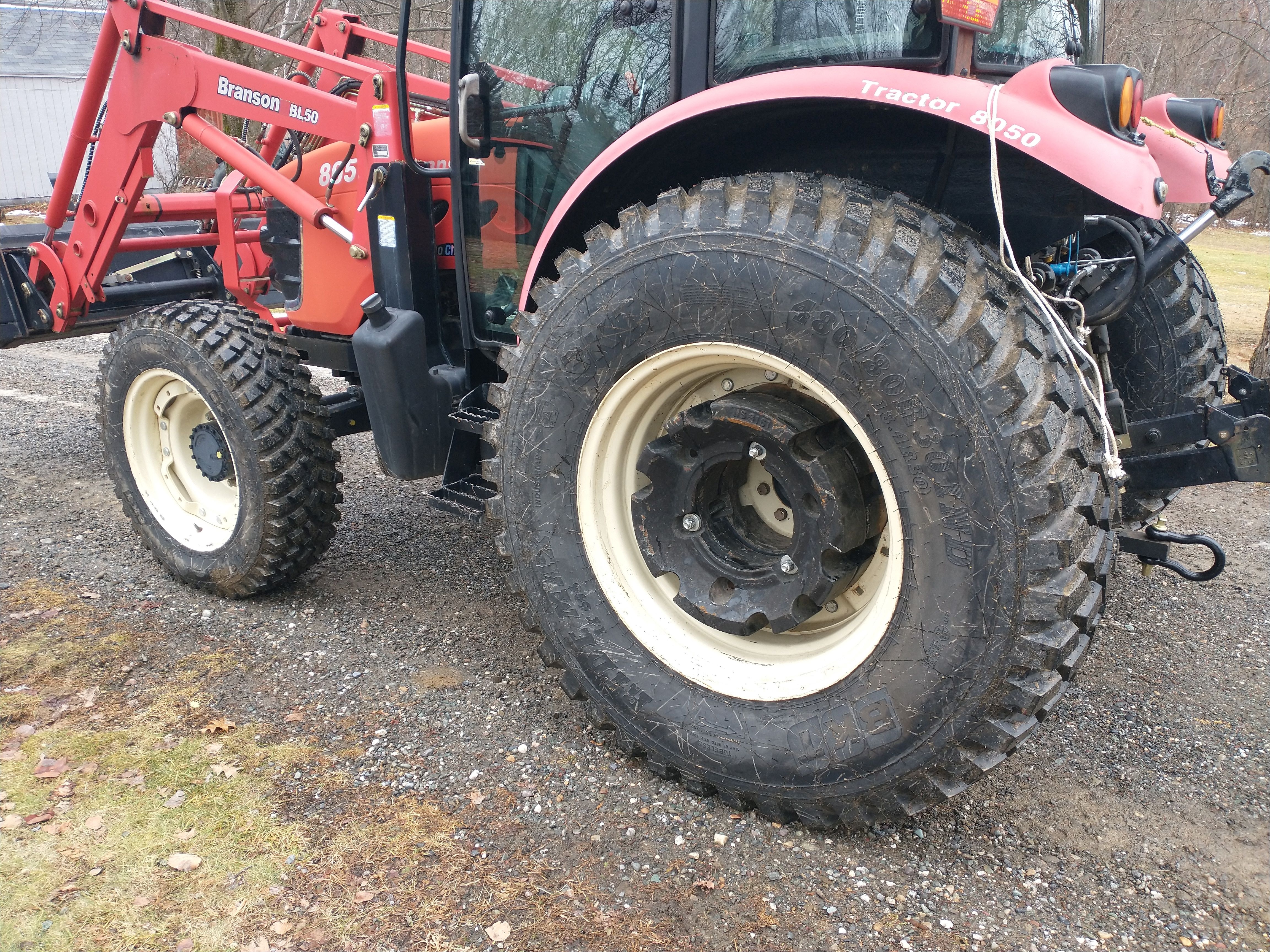

These are the new BKT Ridemax tires I put on my Brason last fall, they have been an impressive tire on this tractor on snow and dirt and turf, they got into bit of mud during the spring and they did OK not as good as R1's but much better then R4's could have ever dreamed of doing.

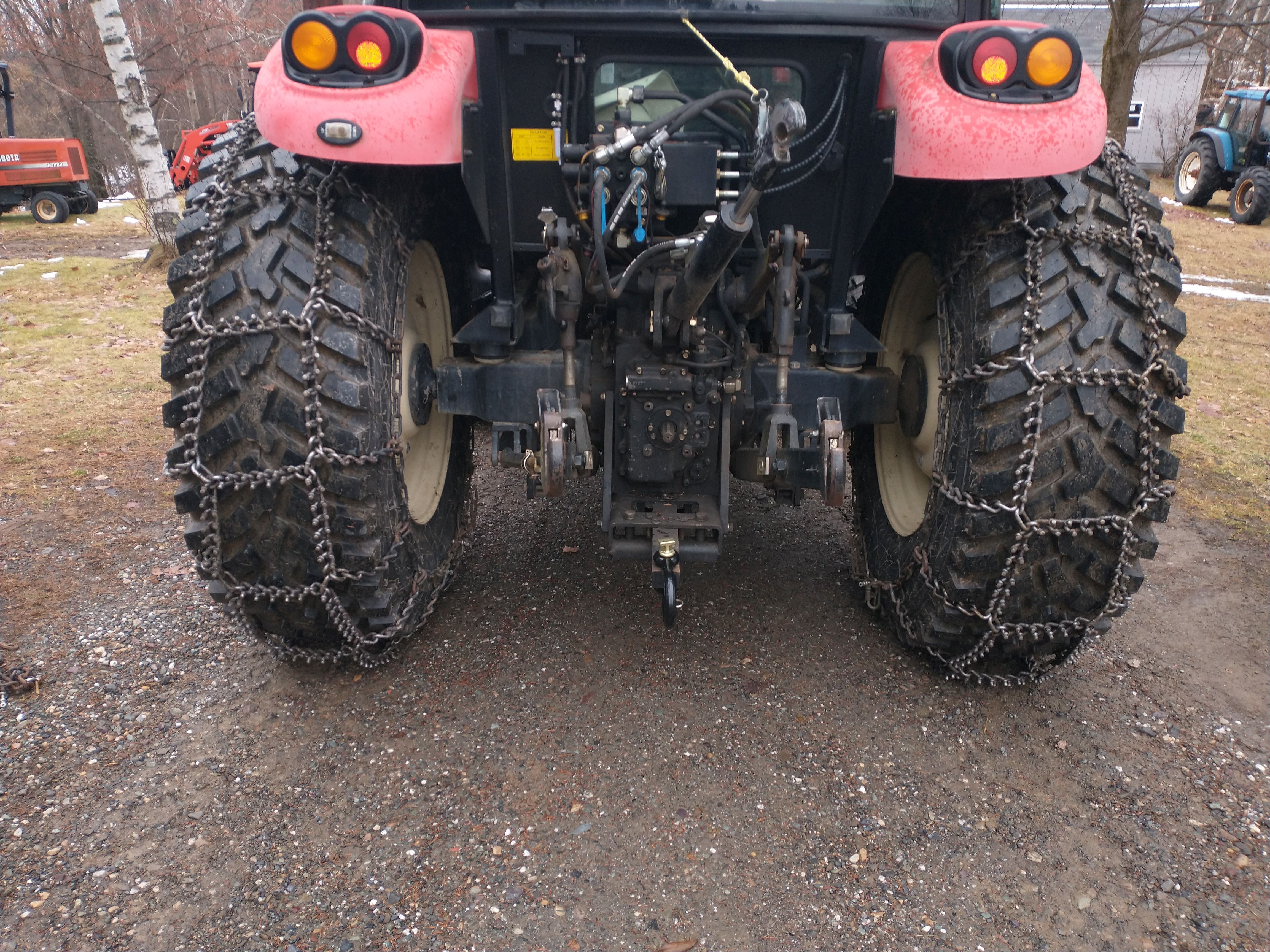

Chained up and ready for winter, even with tires that work well in snow when it gets steep and packed or iced over nothing will work like good chains. These studded Euro patterned chains are the best I've found after many decades of using chains.
